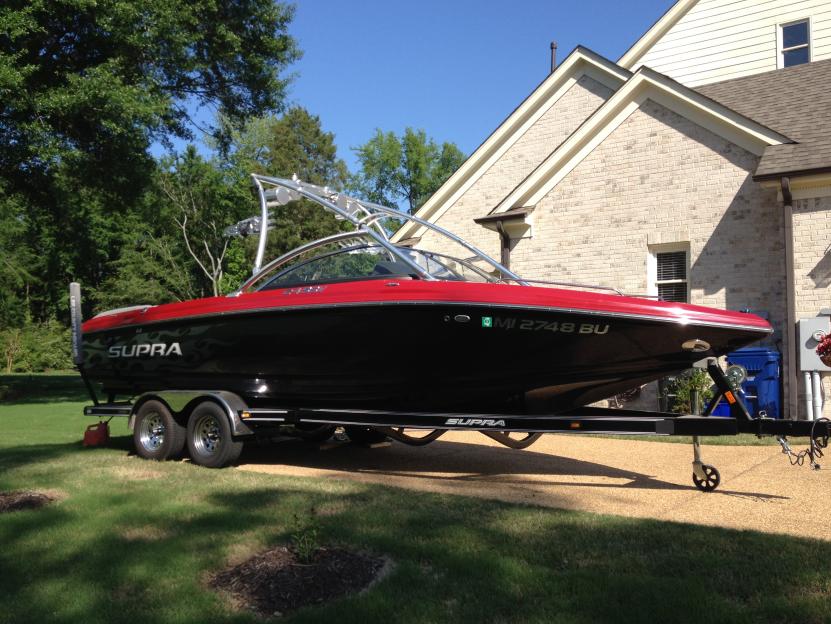

Has anyone upgraded their ballast with Wakemakers Gravity III system? Looks to be a lot more efficient. Also if you have the upgrade, how much time / cost for install?
2007 Supra Gravity 24SSV

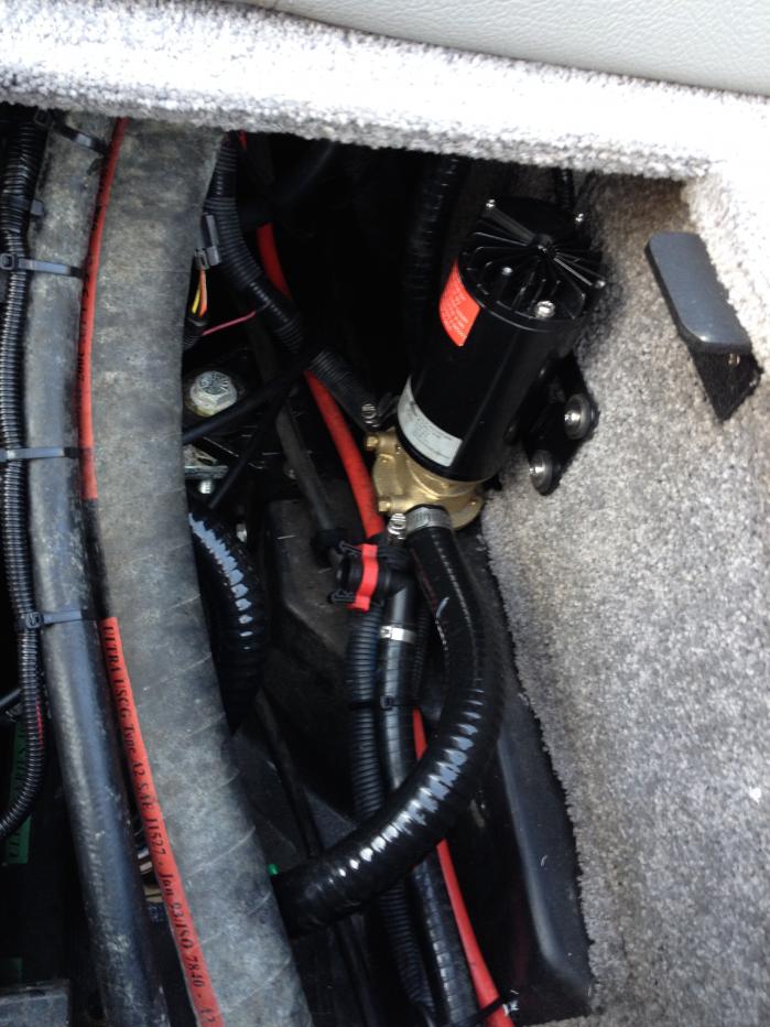

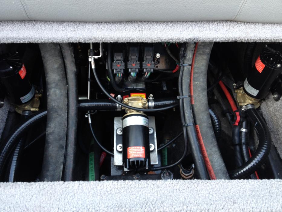

All 3 pumps are mounted under the back seat. I had a cooler/storage compartment under the center seat of the boat. They fit under the seat, in front of the vdrive/tranny. Each to access.

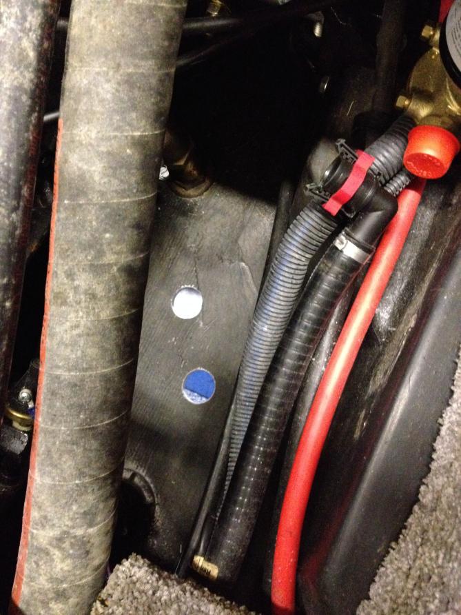

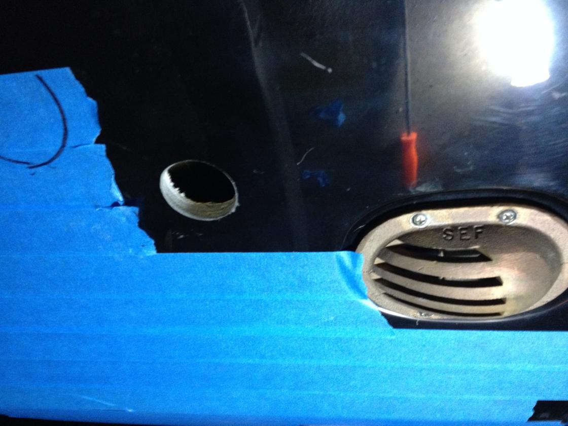

Yea I finished the upgrade and first a big Thank You to Jason and Spencer at Wakemakers for answering all my questions. I could have finished this in about two days but it took five because I am so anal about things and honestly working up the courage to drill big holes in the bottom of my boat. The final install actually gives a much more factory look and better access to the vdrive than the stock install. I was also able to use a pull stick for installing security systems to fish the front line under the floor without taking up the floor and I was also able to keep "the worthless" cooler under the back seat. Also used two rare earth magnets the size of a dime to see exactly where I was going to drill this was a great idea my buddy with a Mastercraft had and they worked great. You could move the one on the other side to know exactly where you were on both sides and they also fit inside of the intake hole on the hull fitting so you could set the assembled unit on top to check clearances.
