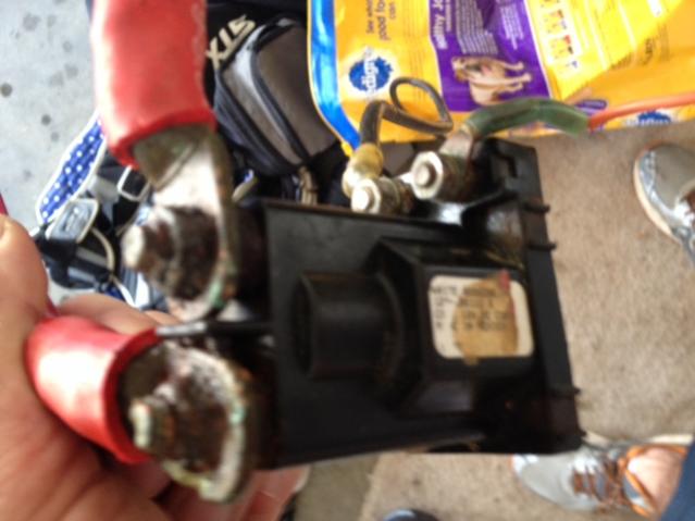

I am trying to install a dual battery switch and I am having an issue trying to figure out if the 100 Amp solenoid is required on my 2000 Launch. At first I thought it was something the PO installed for the stereo, but following it back it the wire goes to the wake plate control on the dash. Is the 100 amp solenoid required or was this for something else, as it looks like a non-factory install?

A solenoid that large would usually be used for a battery separator. Did your boat have dual batteries to start with?
Wait...just looked at your picture. That is, indeed, a battery isolator. It should, directly or indirectly, have a lead to each of your batteries. When the primary battery is charging, it should close to also charge the secondary battery. When the charging stops (i.e. engine shut down), the solenoid should release, isolating the secondary battery to use your radio and other equipment without draining the primary starting battery.
There may also be a wire to the dash with a switch to manually close the solenoid for a 2 battery boosted start.

I'm not positive of your exact setup, but a lot of people use a solenoid in place of a dual battery switch. If that's the case it Would have nothing to do with the wake plate other than he used that as a 12volt source for the solenoid. It's basically an auto isolator for a dual battery setup.
We're playing post tag! I edited my first post. If you look at the name on the relay and google the name under "automatic charging relay", you can get a copy of that solenoid's instruction sheet. It is very simple. One post is for the primary battery for starting (although with some models it does not matter which is primary) and the second is for the secondary battery. Another small connector is to ground, and the second small connector is for manual boost start.
It is fully automatic.
