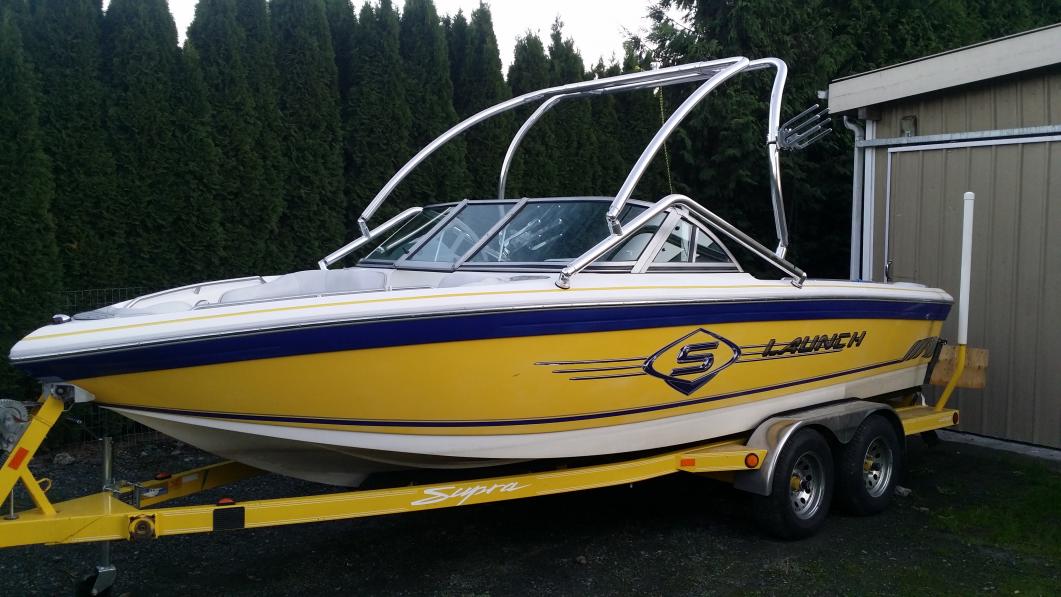

Just purchased a 2002 Supra Launch - Direct Drive (Not a SS or SSV, just a Launch)

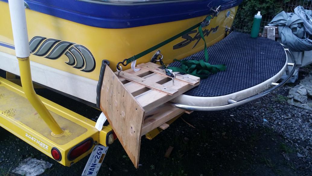

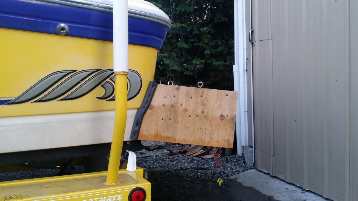

Built a custom wake gate last night to try out today after reading a bunch of posts.
This was a quick 1hr prototype build, I will make a nicer one later.
Attachment 16639
Attachment 16640

We went out today and first tried it without the wake gate and it wasn't a clean wave. Once I installed the wake gate you could tell the difference.
