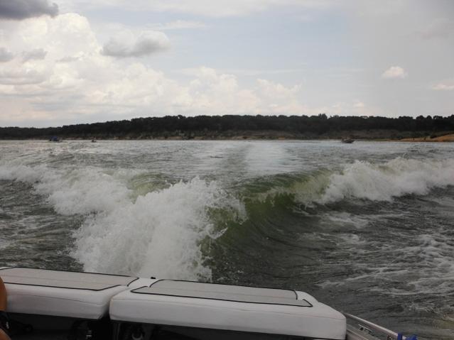

Finally got a chance to start playing with the surf wake. The 454 engine and 541 prop pulled nicely up and held steady speed. Unfortunately, thunderstorms quickly rolled in & didn't get a chance to play around with the wake plates, speed, human ballast, etc. or even get a board on it. Not much in the way of scale or reference, but any comments from you wake masters out there? I think it's definetely gonna be surfable :o
1 x 400# rear ski locker (mostly full - started lifting the lid)
2 x 450# under the convertible rear bench
1 x 750# port side floor next to engine
1 x 400# port bow (was missing a plug on the starboard bow 400, so couldn't fill it :( )
3 adults & 4 kids scattered about the boat
wake plate at ~ 1/2 way up
just over 10 mph (on uncalibrated speedo's)
