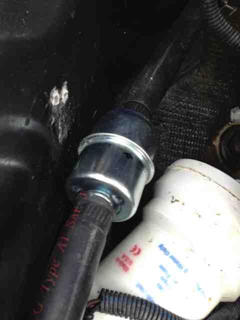

Remove the rear seat that butts against the engine and the carpeted step box covering your vdrive and tranny. It should be on the left side (though starboard in actuality). You'll see the hose running to your fuel tank. Here's a pic after I changed mine.
Attachment 9587
