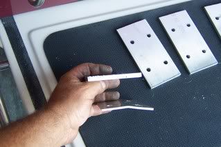

I recently purchased a tower for my Legacy that I will be installing myself. It should be here in a couple of weeks. My question is, does anyone know how thick the fiberglass is? It is recommended to reinforce the mounts if the thickness is less than 1/4". I know that when I will drill into it when I'm ready to install it I will be able to tell, but I want to avoid having everything ready to go, then drill into it and find that it's too thin, and have to scramble around to find something to reinforce it with. Does anyone know if it is definitely thick or not thick enough? Or should I just reinforce it no matter what to be on the safe side? Any input would be appreciated!

I just installed a vapor tower on my 98 outback and reinforced all 4 of the mounting points. If yours is anything like mine then it's not thick at all. Even if yours is more than 1/4" I still would just for the piece of mind. I ended up using 1/4" marine grade plywood boards and 1/2" steel plates over the boards that came with the tower. I think it's definitely worth it since you're already going to be in there. I also used lock tight on all of those bolts. Good luck!

I have a legacy also. It was thick enough on top but I still reinforced it anyway. I had to make it step down enough to get out of the curve of the fiberglass to get the back plates on but it turned out nice. It also seems super strong but I haven't had it out yet. http://img.tapatalk.com/d/14/04/26/evegysed.jpghttp://img.tapatalk.com/d/14/04/26/y3uva9an.jpghttp://img.tapatalk.com/d/14/04/26/zy7e6y8u.jpghttp://img.tapatalk.com/d/14/04/26/yza6e6ar.jpg
