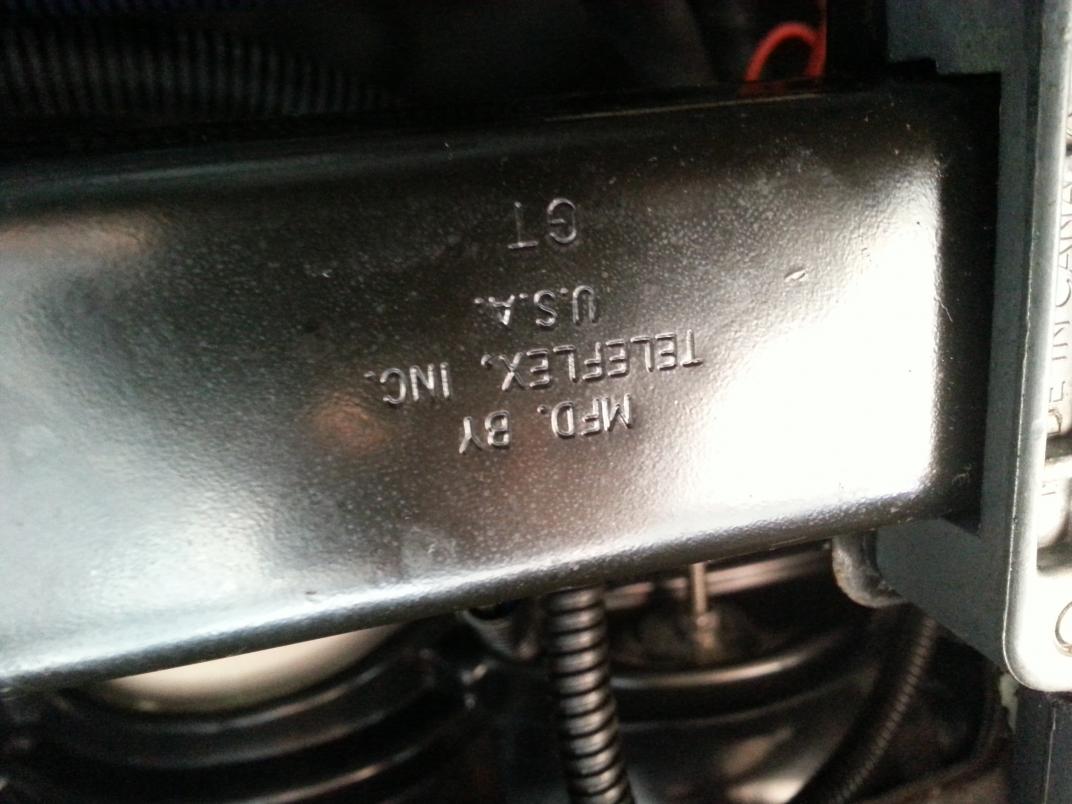

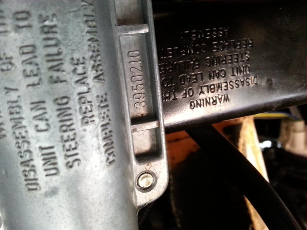

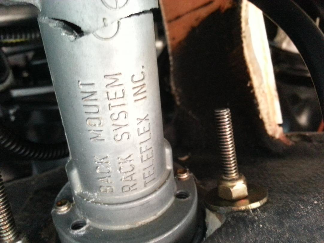

		I have noticed my steering was tighter than normal but planned on sticking it out for the rest of the year until yesterday when the Back Mount Rack system by Teleflex inc cracked. This left me with zero turning capabilities and I wanted to get some advice from the community. I am going to attach some pictures. Thanks for the help in advance.

		You need to replace it . It can be welded but when it comes to steering I would just replace it
		2008 Launch 20 steering issue
		Pull the cable out , is that a steering rack ? Take more pics overall
		The part that's broke it the steering column outter housing , the culprit was probably the cable binding when turning , teleflex offers that same style for around 160.00 for column / helm and cable . Remove and measure cable from end of black sleeve to end of black sleeve and add a foot . That's the size you need .
