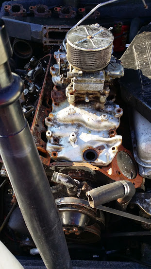

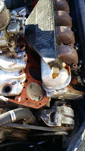

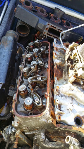

I just bought an 1987 Supra Saltare and need some engine help. It might be missing some pieces and need some pictures or diagrams of what it should look like. Trying to upload some pictures but says file is too large.
Wow, I don't want to be a downer but I hope you got it cheap. Looking at the state of dis-assembly, I'd say you've got a bit of a project on your hands. Firstly before you even consider putting it back together, you need to know why it was taken apart. Do you know the story?
To answer your question though, from what I can see, you're missing the thermostat housing and hoses, push rods for both sides, distributor and wiring, ignition coil, and of course all the associated gaskets. Putting it all back together isn't that big a job if you know what you're doing, it's just nuts and bolts. What I'd be more concerned about is how long it's been sitting open. You've got a bunch of mating surfaces that have been exposed for all the time it's been sitting like that, and they'll all need to be properly cleaned before it goes back together.

You'll be throwing good money after bad if you start bolting that engine back together. It's obviously got problems and needs a complete rebuild -- and I'd definitely have the block magnafluxed (checked for cracks) and have the heads gone through. It's not impossible for you to DIY a good portion of this but step 1 is going to be to yank it out of the boat and start disassembly.
The good news is that it's a 454 and stock parts are relatively cheap.
I believe this saltare was on CL, advertised as working great over the summer, but was not winterized at the end of the season, cracking the exhaust manifolds, perhaps more.
Full rebuild....

I am going to put in a rebuilt 454 as this one does have a cracked block. The problem is I am not sure where some of the brackets are supposed to be mounted as some are removed. That is why I would like a picture or diagram of what goes where.
glad to hear your replacing the engine. That one has seen better days. Even if the block wasnt cracked, it looks like its been sitting apart so long that the cylinder walls are probably rusted and will never seal again properly with out a rebuild. I can take a few pics of the accessory brackets on my 454 next time im at my boat if no one can provide them.
