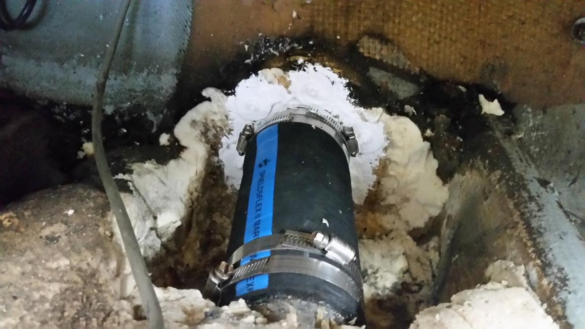

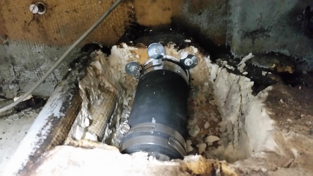

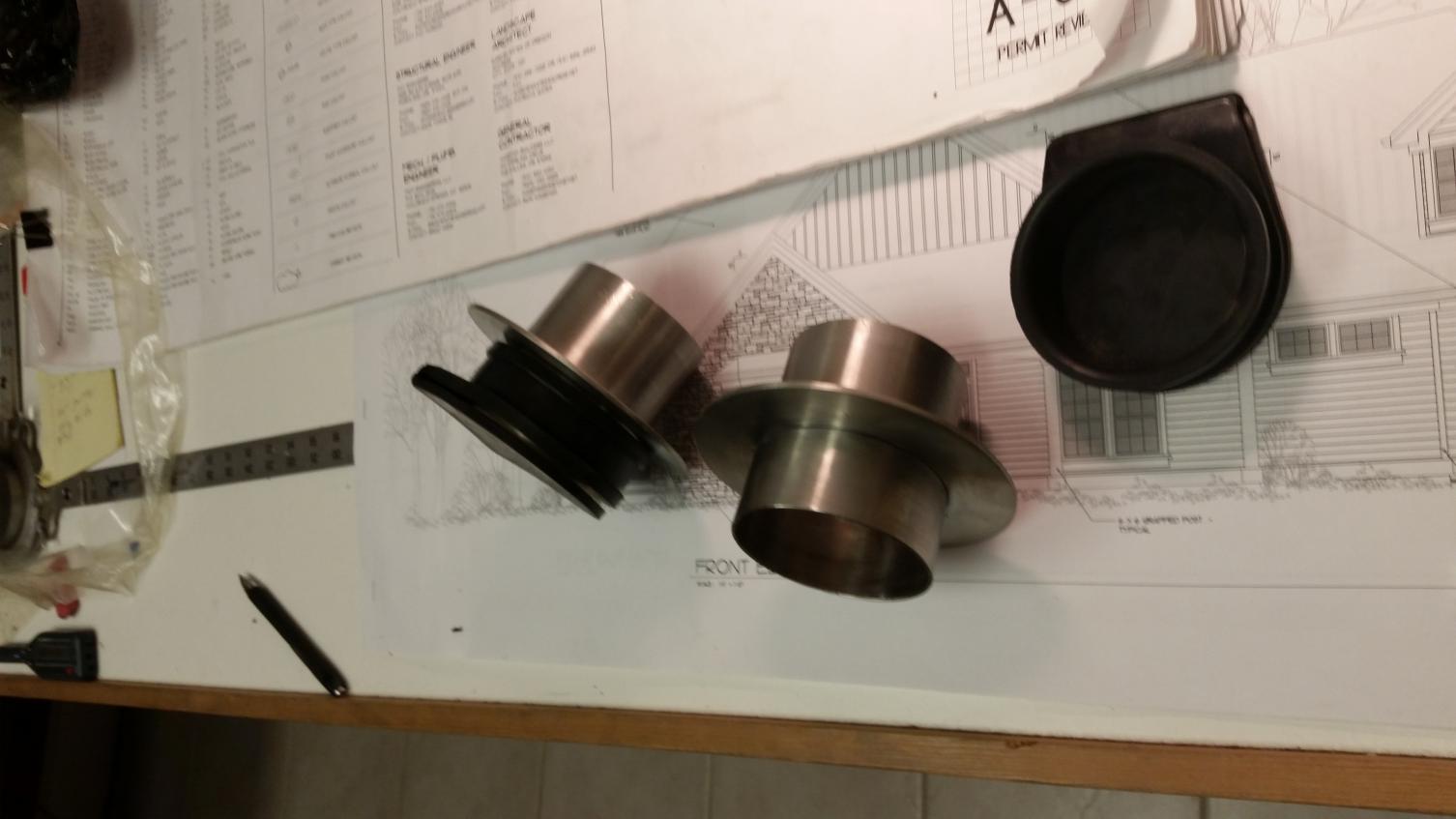

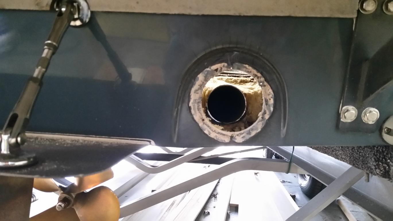

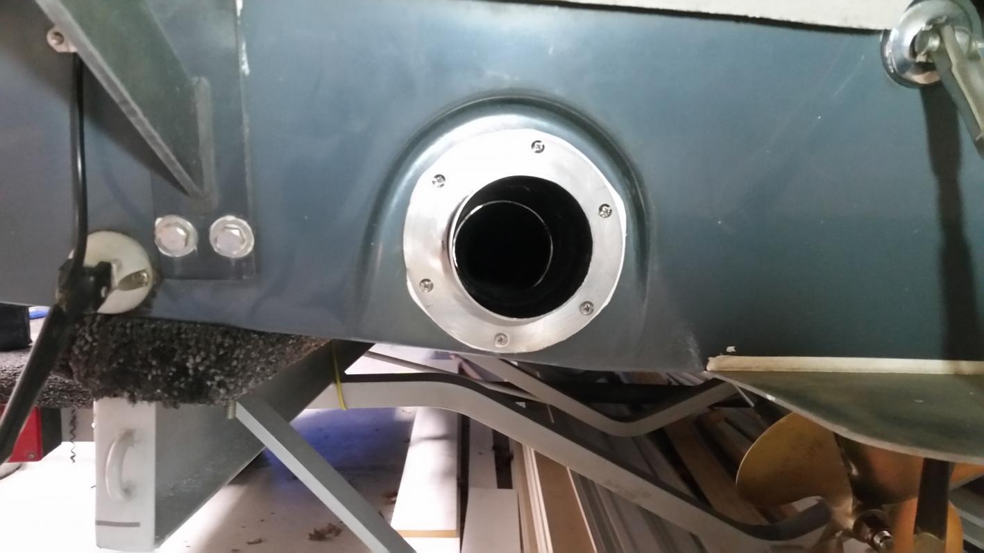

Attachment 16893Attachment 16894Attachment 16895Attachment 16896Well I decided to get busy and get rid of my super traps here’s what I came up with.
I went to the local stainless steel fabricator there actual forte is building vats for making beer. I drew up a simple sketch for the plant engineer he told me no problem I can have them ready for you tomorrow. One day later and $125 I was pretty happy with the end result. I found the rubber flaps on eBay $22. I spent Saturday and Sunday this weekend doing the install hopefully I can finish it up next weekend. I was really surprised that my 30 year old foam was not wet. The only place I found it moist at all was right up next to the super traps.
No problem, it looks like you ended up cutting the old pipe inside the transom and then bridging the gap with 3" exhaust hose. Is that correct? That is what my new setup is basically only I ditched the all metal exhaust for fiberglass mufflers that are both quieter and much lighter than what I took out.
Yes exactly rite. I cut out 5 inches of stainless steel pipe.Cutting the bottom side of the pipe proved to be a real challenge. I went through about 8 Dremel blades to cut the pipe from the inside. Filled in the gap with 8 inches exhaust tubing. Which gave about 2 1/2" inches per end for a seal. Today I inserted 30 inch glass pack baffles. I wasn't sure if it would work well so I picked up 2-30 inch glass packs from the local muffler shop cut them open remove the baffle and the glass packing .Then I had the muffler guy expand the ends of the baffle so they would just barely fit inside the existing stainless steel exhaust pipe. I'm aware that the aluminized steel baffle will probably rust out quickly. But if I like what it sounds like they're easy to remove and replace them with stainless next winter. Plus it gives me the option to re-pack the glass pack if needed. I fired up the engine this afternoon and ran it for about 20 minutes there's a definite noticeable drop in sound omissions. I hope I like what it sounds like when I hit the water. The muffler guy told me I would be able to tune the sound by moving the baffle from the front to the back.I'm sure I'll give it a try I like to tinker.Getting the exhaust warm also gave me a chance to somewhat check for leaks and re-tighten the hose clamps before covering up my work. Hopefully I will never see them again.
