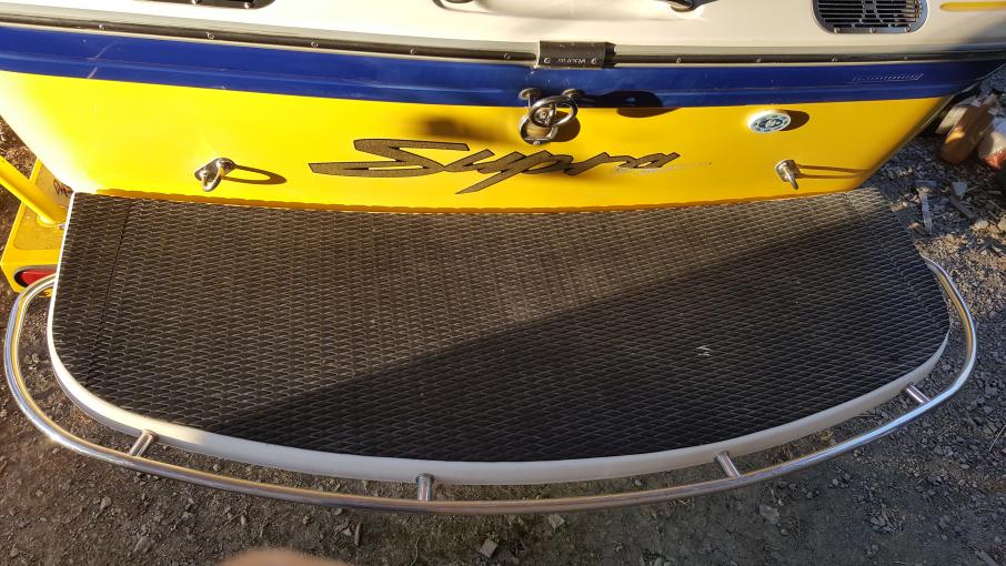

I made one. Turned out great. I took 2 pcs of 3/4 sandy ply from Home Depot, glued and screwed them together. Then cut it down to 66" by 32". Used fiberglass resin only no matting and did 1 thick coat. Then applied two layers of Hercules truck bedliner. Took off the old fiberglass one drilled pilot holes in the new platform and filled them with 3m marine sealant. Used the existing brackets to hold the platform in place. It has held up great for the past 2 months. Total cost was around $150. I bought the Gray mat on amazon for $75. Total man hours around 4 hours. I can build 5 of these before i reach the cost of the Surf platforms made by Supra.Attachment 17564

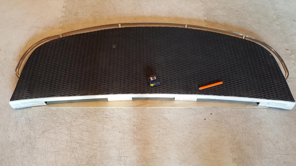

I did some work on my deck today. Used the same dimensions that Trayson used.
This was my current deck which would dig into my surf wave really bad

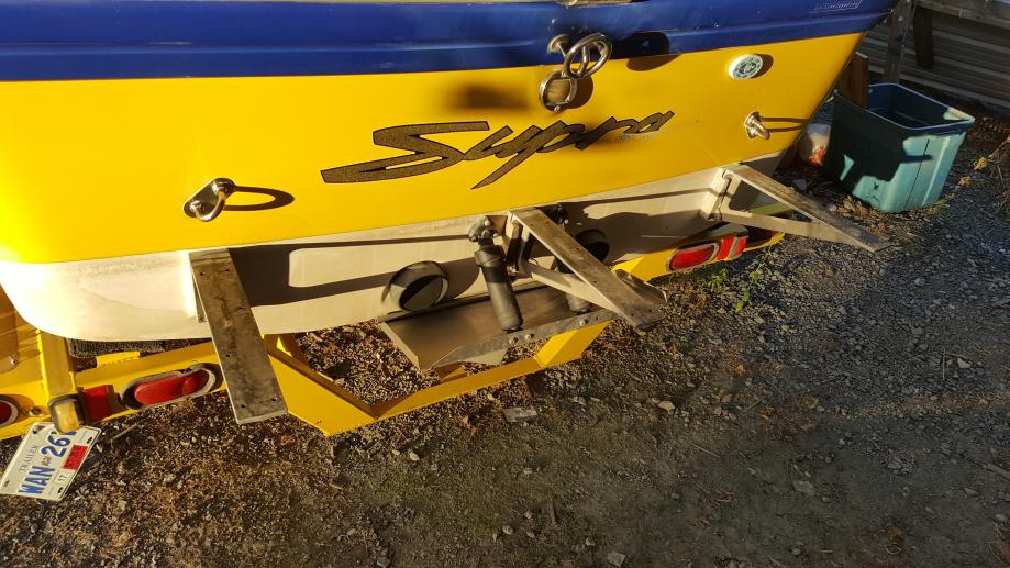

Here are my brackets with the deck off
Attachment 17578

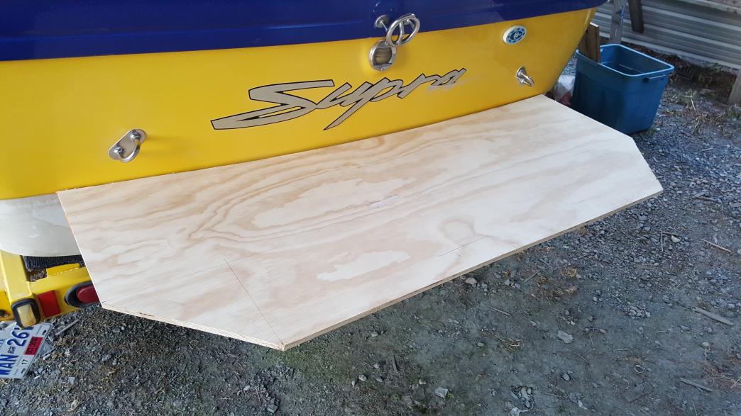

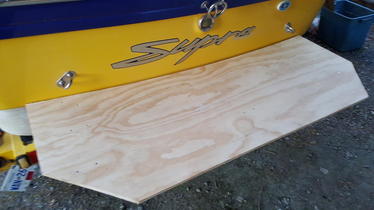

Cut my boat to 60x24, I then traced the old deck so it would fit nicely on the back of the boat
Attachment 17579
Here it is on after I traced it out and cut with my Jiggy
Attachment 17581

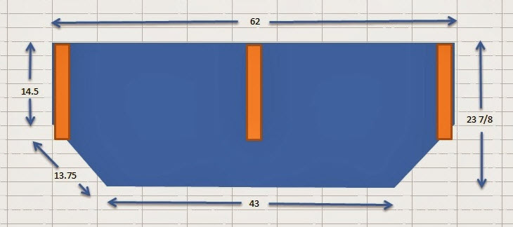

3 Attachment(s)
I used the same dimensions as Trayson did since they seemed to work for him.
Attachment 17582

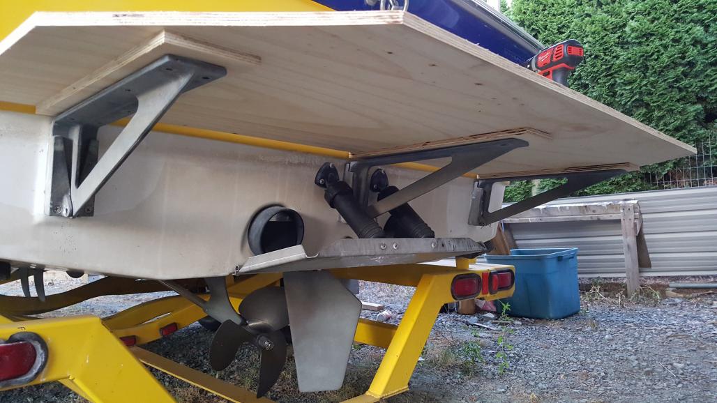

I then cut some strips to so that I could then use my stock screws. I screwed into the strips from the top of the deck then but the screws in the bottom. Note to self don't use a impact on those screws as they are VERY soft.
Attachment 17583

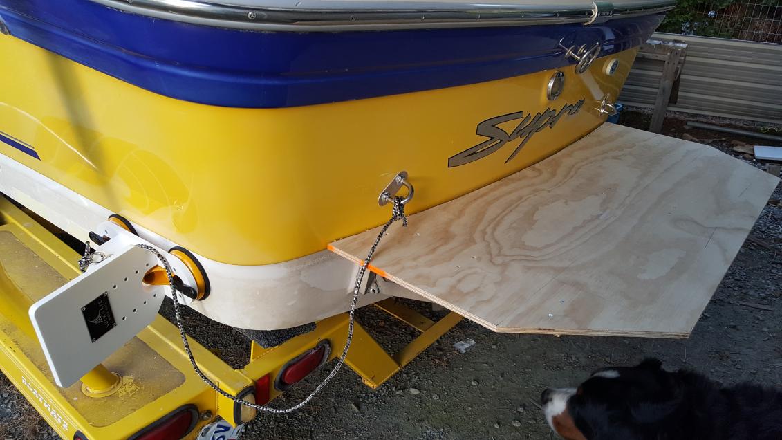

Here is the setup! Can't wait to see how the deck does tomorrow!
Attachment 17585

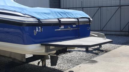

great job. yeah, definitely round the corners. here's the one I did on my Moomba XLV:
https://lh3.googleusercontent.com/-M...027_201259.jpg
