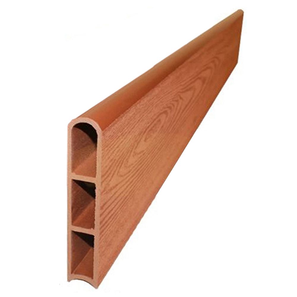

I'm trying to come up with a viable composite option for the stringers and I've found a few products that are intriguing. Here's one that I thought might work if I could find long enough boards and perhaps fill the core channels with Seacast. Attachment 17889
These composite boards are exactly 1" wide by 5.5" tall. I thought they might work but I'd like to hear some thoughts on how I should test them out prior to use. Most importantly, I obviously need to know what the actual dimensions of the original stringers are first.
