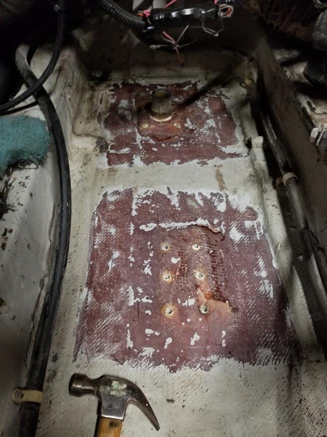

Don't know how hard things got hit, but I'm trying to determine if there was fiberglass work done. The rudder has to have a number of washers put in to space the tiller arm up high enough that the rudder sits flush to the boat underneath by the prop. Also odd, is that there is no rear drain plug. The features surrounding it are all there, and if someone did fiberglass work, they did a pretty good job...
The tiller arm needs about 5/8" spacing to make the rudder sit correctly in the boat. Is there a piece of plywood or something missing in the area that the rudder port sits?

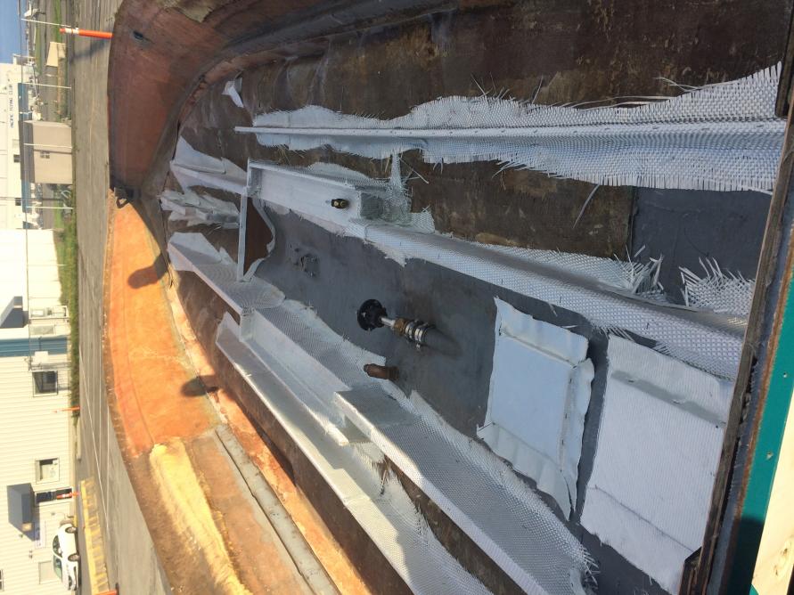

Attachment 18521

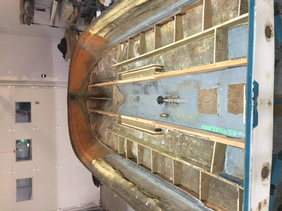

For example, see the second picture in this thread: https://forum.supraboats.com/showthr...steering-cable

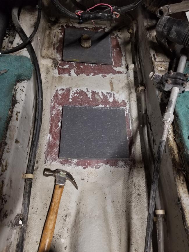

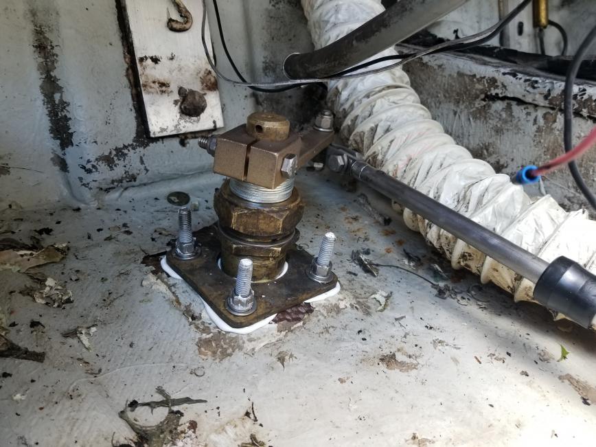

If you look beyond the FAE, you can see where the drain plug would be, but it doesn't exist.
Attachment 18522
Thoughts on this are appreciated! Thanks everyone.
