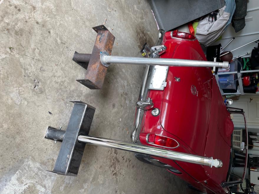

2. The ski pylon over time has rust welded itself together. I guessing I would need to cut it out and then replace. Has anyone found an aftermarket ski plyon replacement?
