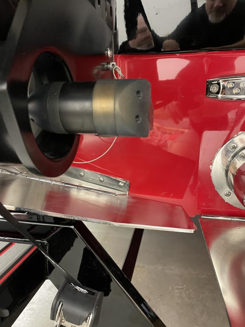

Still doesn't seem normal to me. Also of note that I pointed out to the dealer, the port side thruster motor is discolored. Turning gold on the motor itself. That isn't happening on the starboard side. He did say that was odd but still assured me that the beeping alarm is normal.

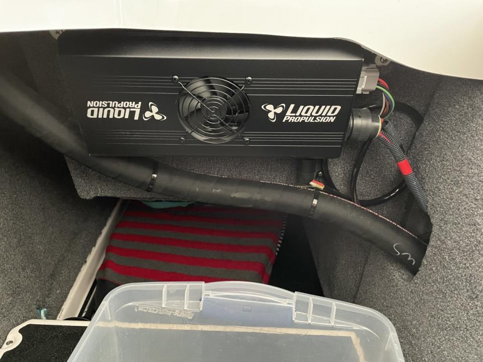

I have the thrusters and some of your concerns appear normal.
First off check the control module in the port side of surf locker.
Looks like this....
https://uploads.tapatalk-cdn.com/202...52fc427e76.jpg
I hear the beeping with key off in accessory mode, but it goes away when key is off and shut down.
I also turn my battery switch off when not in use.
There is a thruster controller on the port and starboard back seats, when boat is powered, those cooling fans will run. Thrusters use a ton of power to run.
If you have the liquid Lumens underwater lights, the light controller also has a separate RGB controller with a cooling fan that is completely separate system from the thrusters.
Liquid Lumens and liquid propulsion are sister companies.
I have overheated my thrusters, but I was absolutely using them aggressively. They will shut down and it takes awhile to cool down.
Discoloration is not ok.

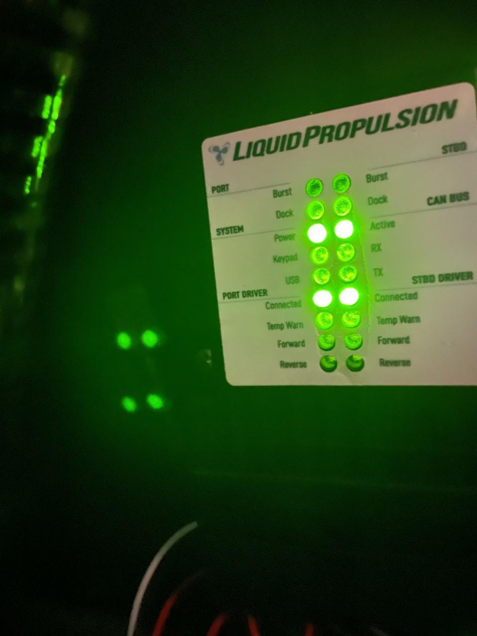

Did you reach out to RoboSanLucas on Moomba forum?
The discoloration seems wrong. My guess is the beep will show a red light fault on the controller.
