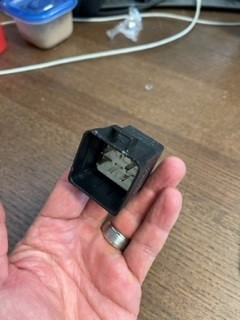

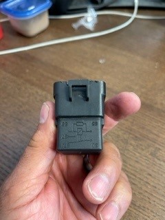

Went out on the water two weeks ago. Boat fired right up and off we went. Stopped for about an hour to eat. Came back to boat and it would not start. Turned over great but sounds like its not getting fuel.
I replaced the fuel pump and harness because the connections were all corroded and just fell apart.
Now that the new pump is installed I dont hear it run when I turn the key on.
I dont have a clue where the relay is or if the issues might be fuses. I have never seen anything on the engine that remotely looks like a fuse box.
Please help if you can. Very frustrated that one minute its running fine and the next its not.
