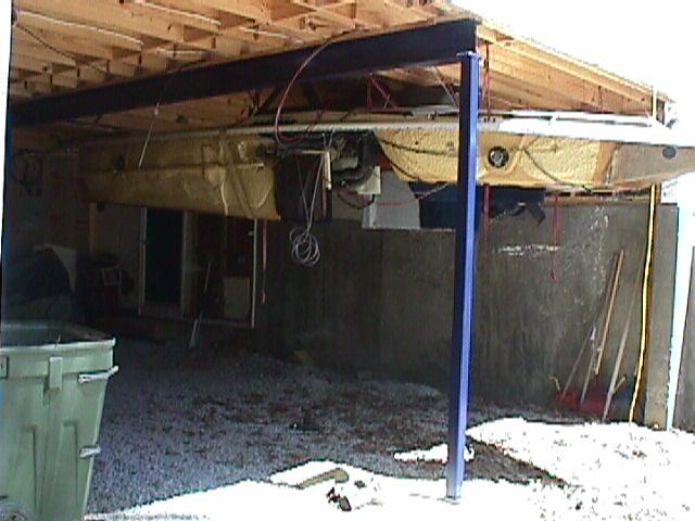

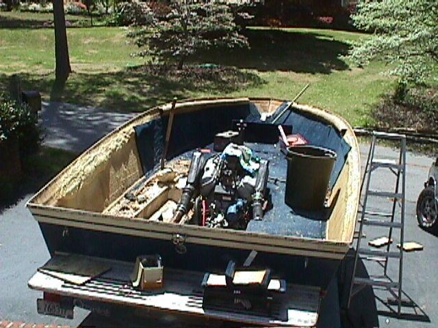

Thought i would post some pics of my '86 saltare floor rebuild project. It has now been 11 years since this was done, and i still have a solid deck & stringers without any compromise. I removed the upper half and suspended it from my garage ceiling..

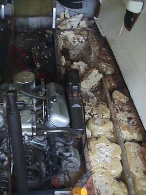

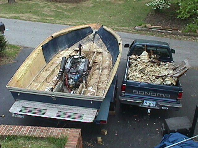

(another story, another project build in process). set the circular saw depth to just cut out the decking, and took out the whole floor. Attachment 8112 Attachment 8114
Found that a shovel was the best means to remove the saturated foam, note how much foam ... filled the bed of my truck!
Attachment 8115.

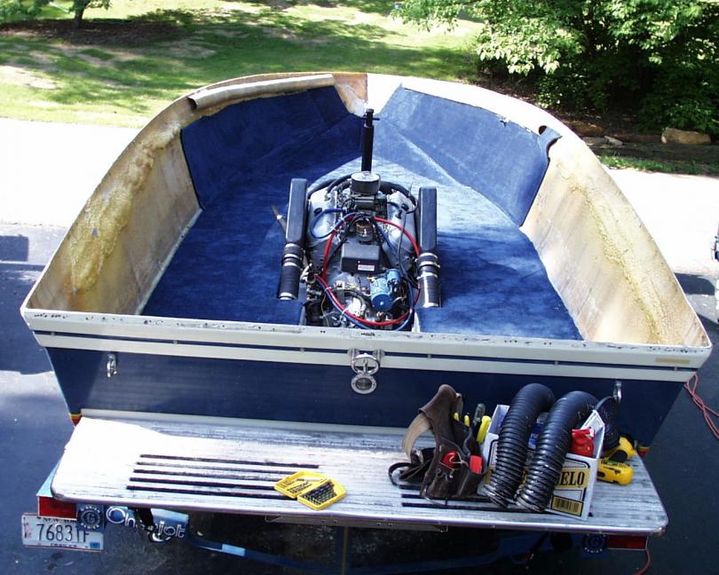

At this point, i determined that the stringers needed replaced too, and brought the boat back to supra where Anthony took care of it from here, installing new stringers, flooring and carpet.
Attachment 8111
