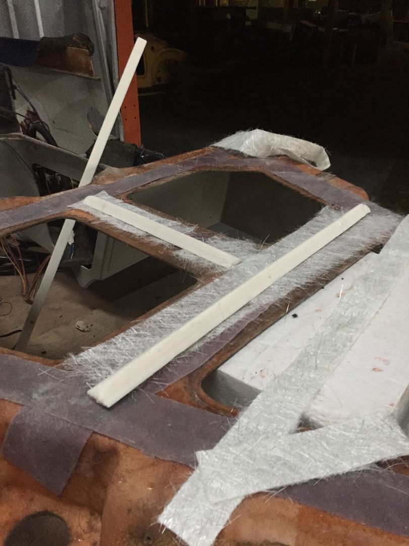

Added 1/2 round foam core embedded in 1.5 oz csm and covered with 4.5 oz of csm to stiffen the playpen area.

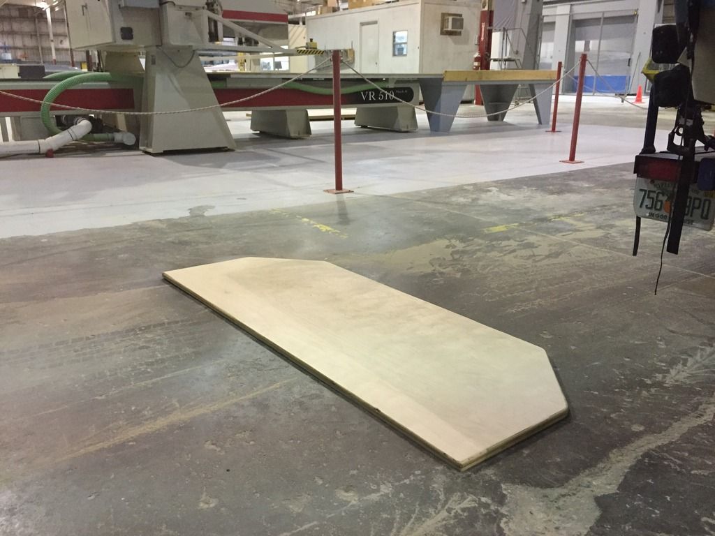

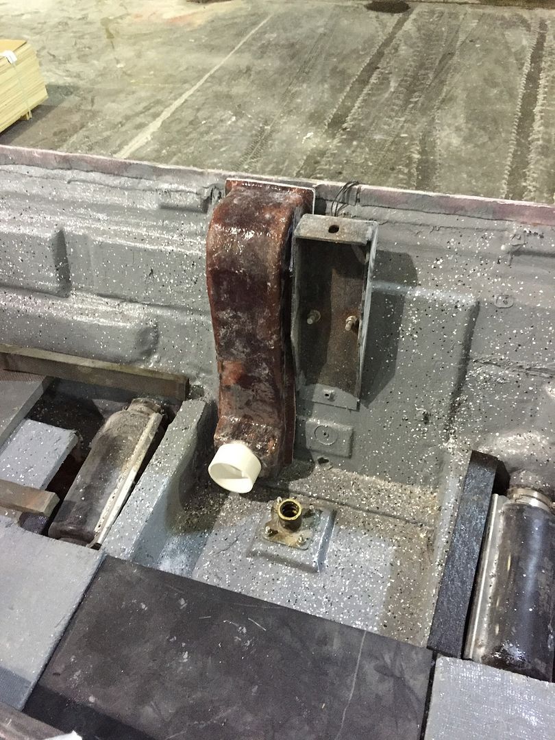

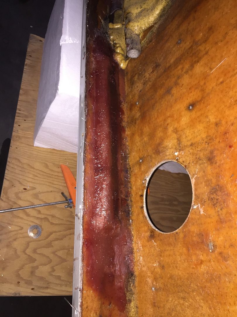

I covered the 3/4" aquaplast backing for the tower with a layer of 1708 and csm A bit of an overkill.
