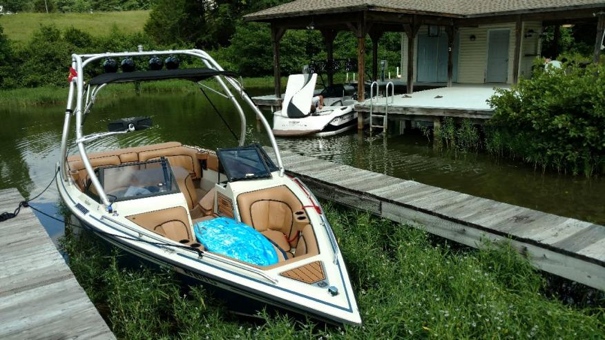

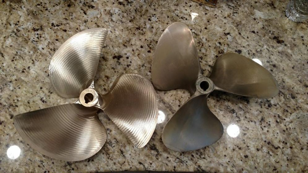

At the end of last season I ended up cracking two pistons and sent the chunks into the heads and out the valves. Over the winter I had the motor rebuilt. Its now bored .060 over making it roughly a 468. Forged bottom end, heads have been gone through, everything with wear or any seals/plugs has been replaced or upgraded. Low rise intake manifold and a 750 carb. Also, recently picked up an ACME 541 prop. I went from 36 mph @ 4900rpm to 47mph @ 4900rpm with 3 people and 41mph @ 4900rpm with 9 people. Im very happy with the boat's performance.
Some pics from Lake Anna this year
Attachment 18262
Attachment 18263
Attachment 18264
Also went to a ACME 541 this season, changed the whole performances : better take off, better acceleration etc.
Still one of my favorite rebuild ! Love the vinyl color.
Did you wrap the dash yet ?
I love the new prop, better everything on mine aswell!

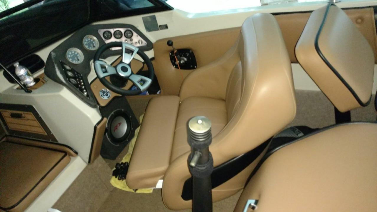

I love your interior, I'm quite a ways out on my rebuild but yours is definitely a tasteful and clean job. How has the yeti seat held up. I'm thinking toward a more permanent seat in the same location and was just curious what your thoughts were on how it works out.
The seat is working out great so far. Seems to get used just as much as any other seat. Permanent wouldn't be a bad idea. If mine were permanent I would make it so I could store things under and still make it semi-removable just in case any motor work had to be done.

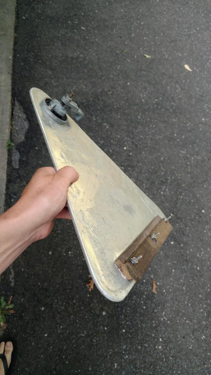

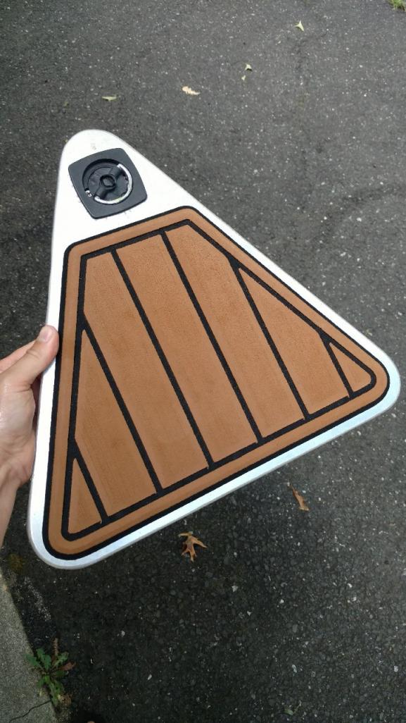

Toymanator- Here's some more pics of the anchor door and gatorstep
Attachment 18265
Attachment 18266
Attachment 18267
Attachment 18268

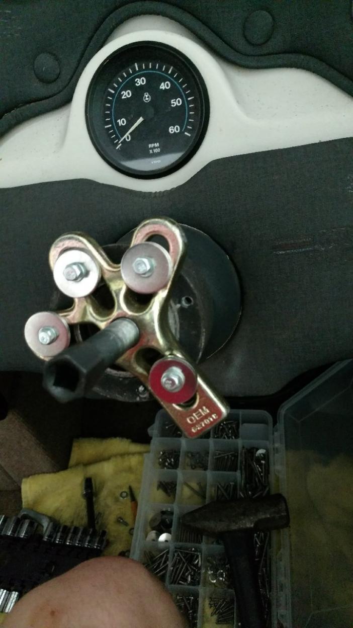

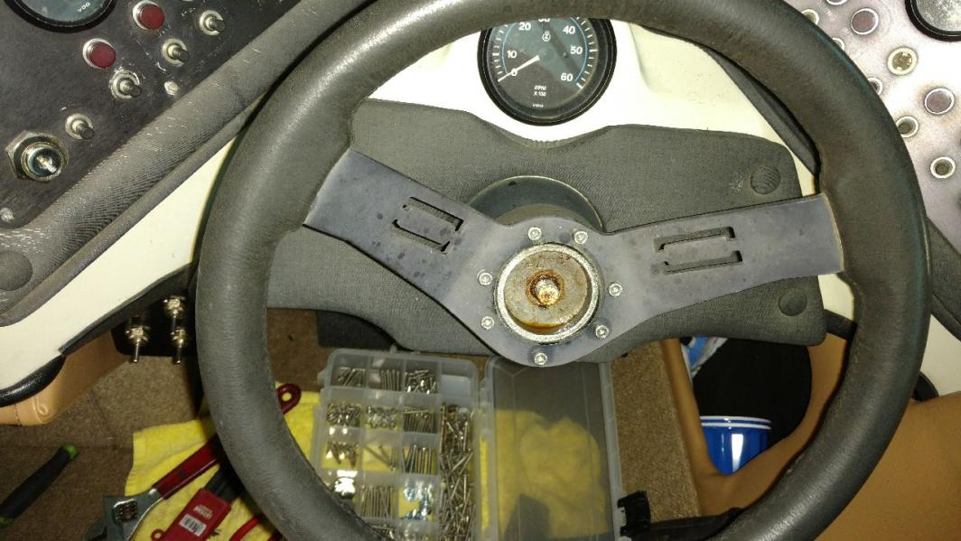

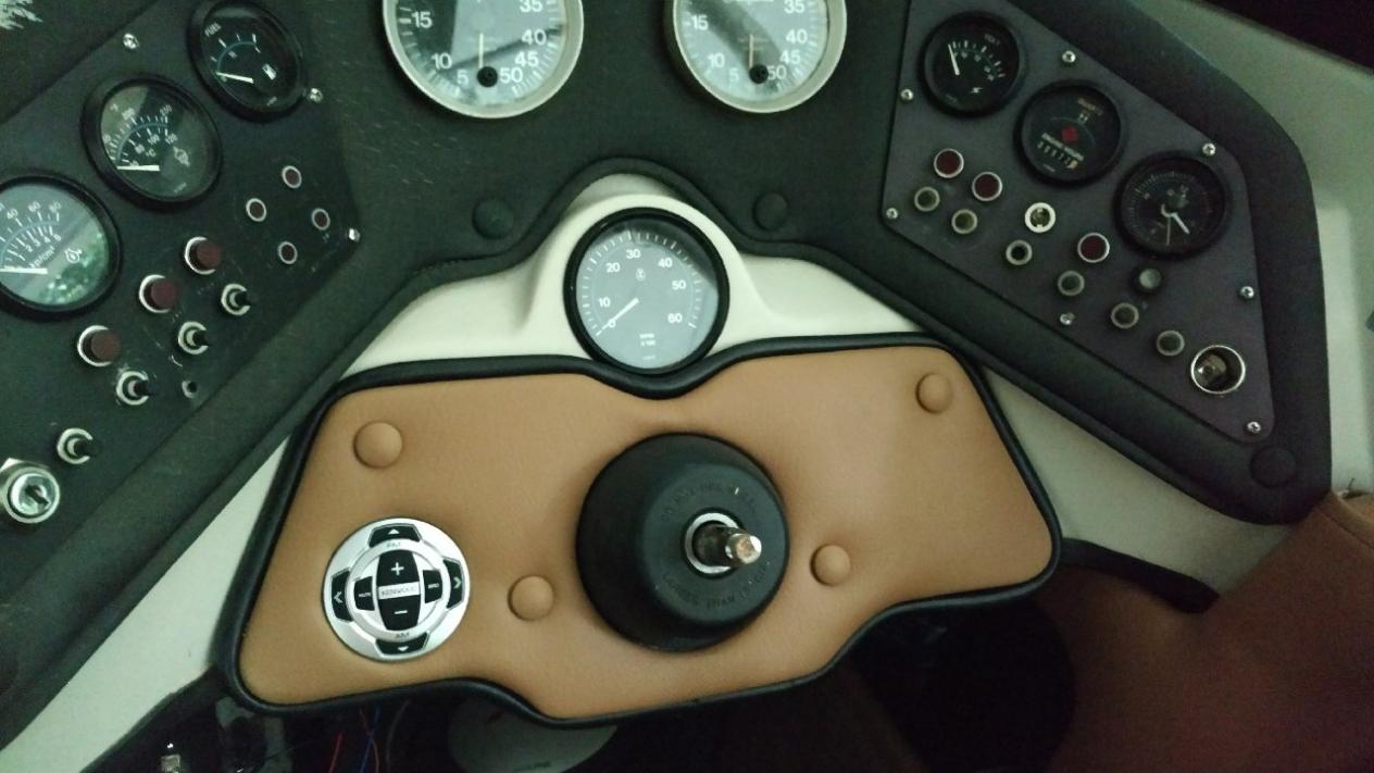

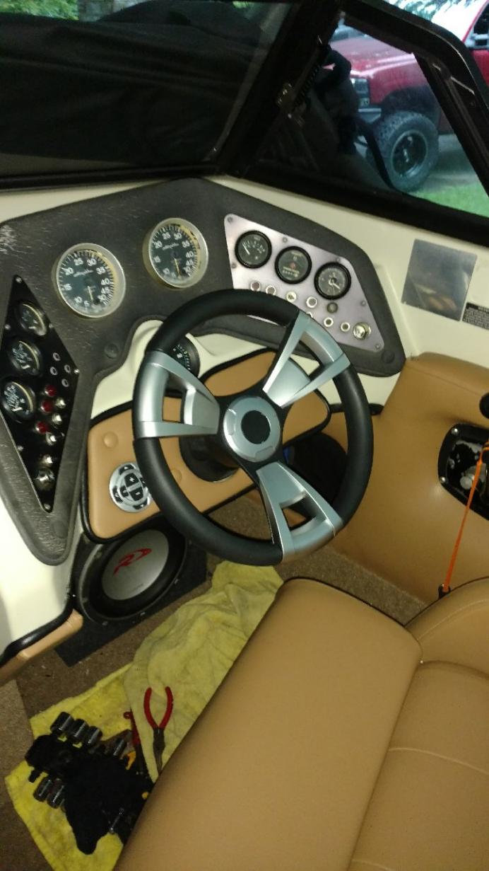

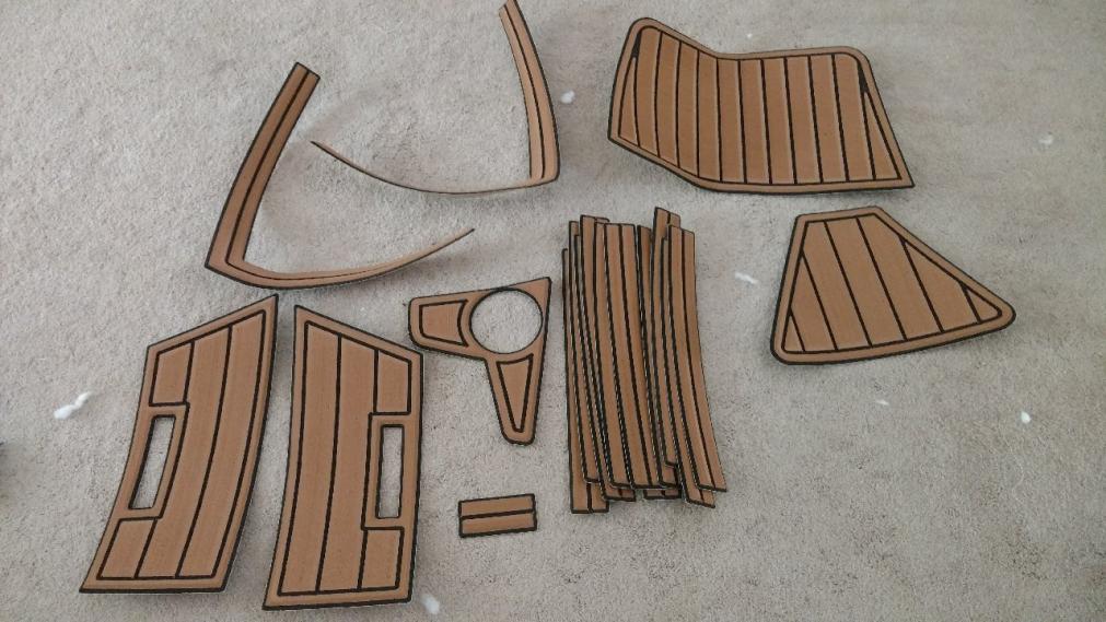

Got some time to rebuild the lower dash panel and install the new wheel and remote. Now I really need to rebuild the upper dash with some new rockers and gauges....
Attachment 18280
Attachment 18281
Attachment 18282
Attachment 18283
Attachment 18284
