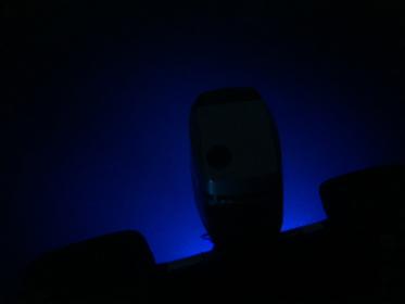

Attachment 16251Attachment 16251
Cool man ! How bright are they Vs round ones ?
It's hard to tell because I have 4 on my bass boat and three on my supra but from looking at them they look brighter and the blue light projects further in the water. It's not really a fair comparison though cause the supra has the platform on it and the bass boat doesn't plus the bass boat sits a lot higher in the water but I'm going to build some new ones for the supra this fall. They do seem brighter though. I saw a blue haze after looking at them out of the water and don't remember tre round ones doing that to me.
