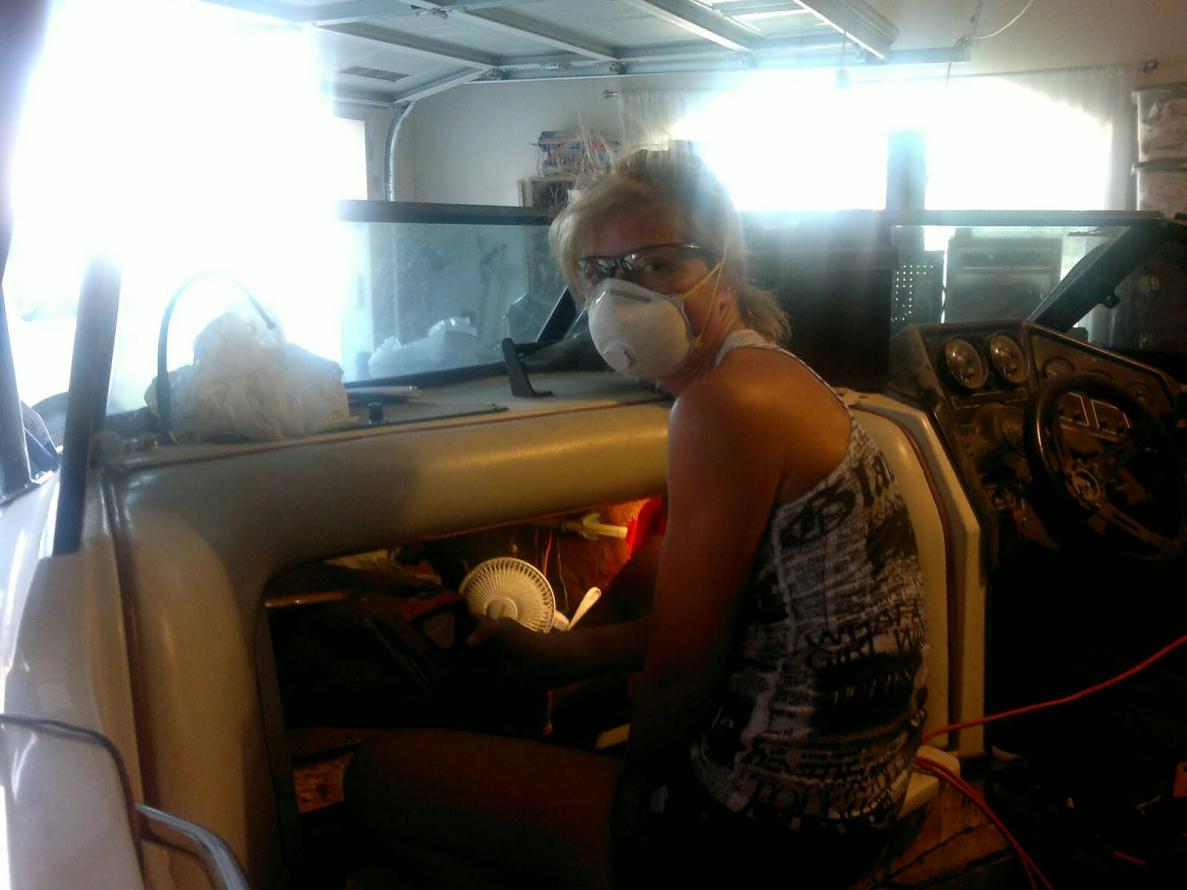

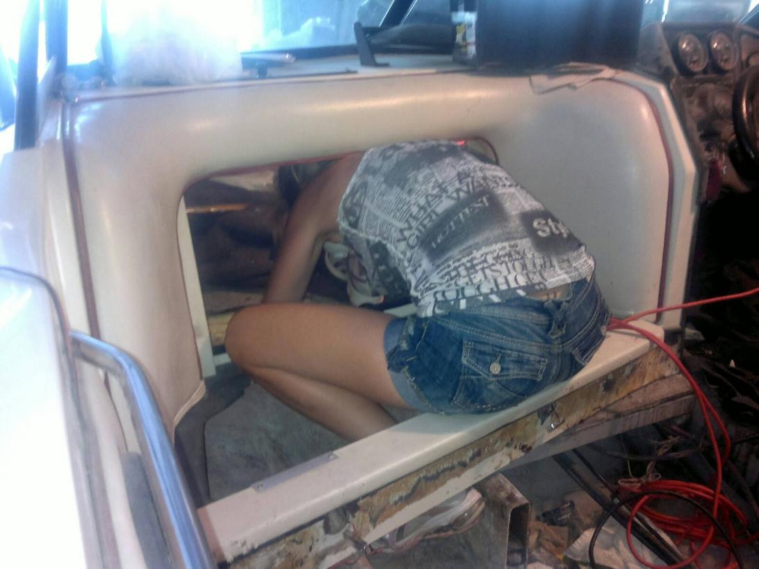

Attachment 8352
Attachment 8353
Ha ha ! West side !!!! Lol what trip ... Yeah I'm originally from east tx . Mallakoff county .. But I live I'n hurst now ..
On your motor mounts I just measured from my old and cut it out of the 2bys x 4 long remember there was a void (gap) under the old so I just took a measurement of 4 1/2 starting from the front and went to 3 1/2 .. And how tuff is it doing all that work with it all together ? Jeez lol and I have more pics I'm laying my deck this weekend just waiting for my accelerator and 1708 to come I'n ... And good luck to you as well friend! -lively-
Dang lively you movin fast . The weather is holdin me back hopefully I can get my deck on around christmas
Ok ok .. So I still have to glass the ribs In and then lay the deck but it's getting there .. I have been working on my dash as well , I'm just gonna glass it and make a smooth finish instead of the vinyl wrap .. And then all the damn sanding on the boat to prep for paint .. Ben that accelerator helps out alot !! Heat lamps and space heaters I'n a make shift tent !! Lol the rental for the shop was to much money so I just bit the bullet and made my own .. I'll take some pics later this week ... Where u at on yours ?
uhhh lol im still on one side. I have around a whole month off from school starting next week so itll be time to work and i know the other side will go faster since i will know halfway what im doin. Im trying to decide some stuff like should i glass the main stringers in and then add the cross ribs or should i put them in before i glass the stringers? what you think?
