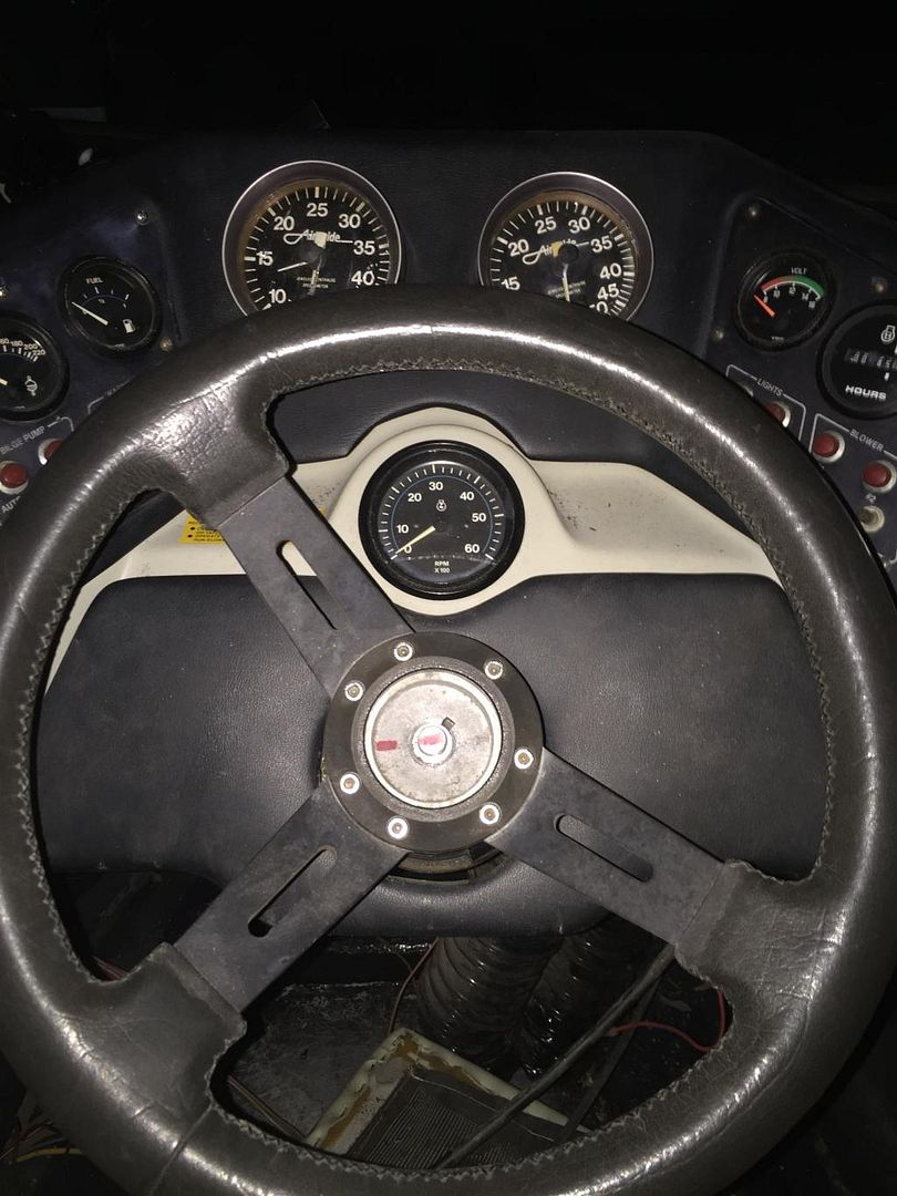

I'm not close to my boat right now, but I have pictures from when I had trouble removing the steering wheel.
http://i722.photobucket.com/albums/w...pss1n2jsqe.jpg
http://i722.photobucket.com/albums/w...psrkbjp5ts.jpg
Ah....looks like I may be off about 90 degrees. Thanks!
And becareful, the center position isn't same on idle speed and high speed. My steering Wheel is perfectly centered at high speed and about 30° off CCW at idle speed. Make a choice ;)

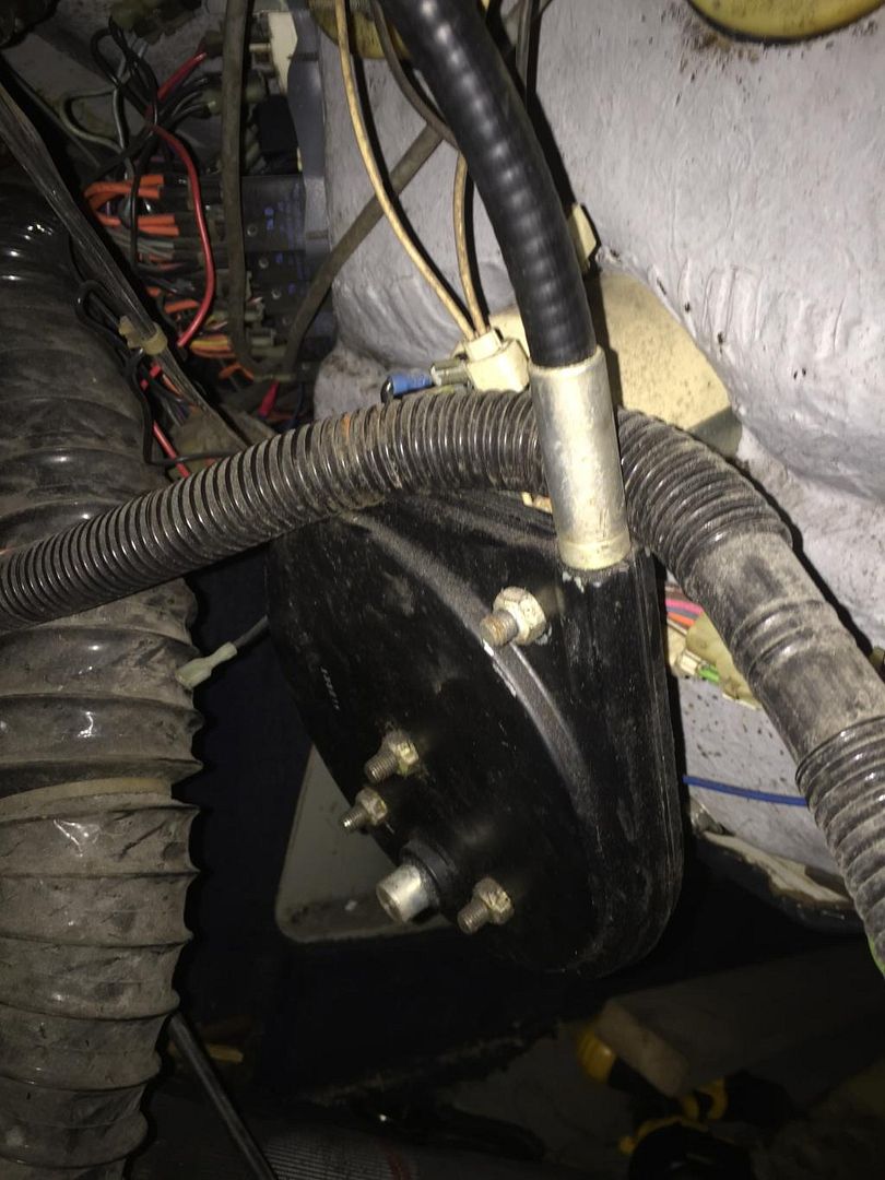

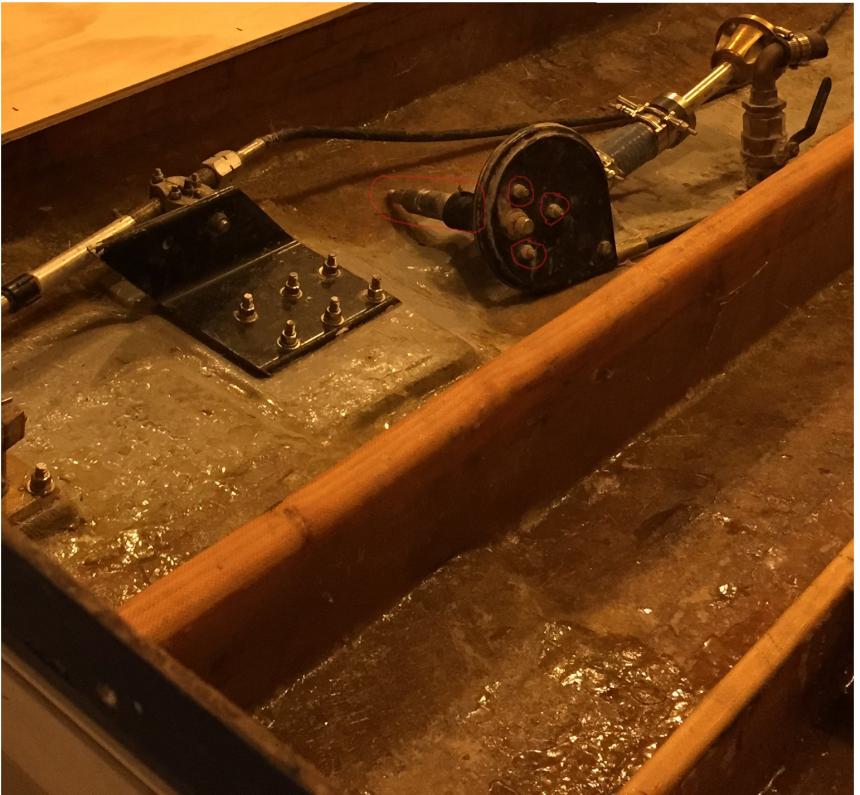

Yes, there is. If you unbolt the three bolts that hold the steering "column" to the round steering rack, you can clock it accordingly. First simply spin your hub fully in each direction, and note the center. Also check that the rudder is centered, or close. After center is marked, you simply remove the column and index it accordingly. It just sits on a splined shaft, so you can pretty much get it dead center. Reinstall everything and be on your way!
I have circled the three bolts to remove, as well as the column. This is the best picture I have, but you should be able to figure it out.
