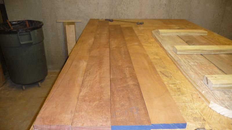

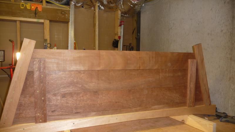

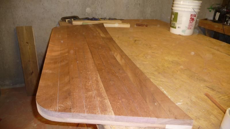

You are correct since there were no slots in it I was afraid it would be slippery when wet. I cut the groves about 3/16'' deep With a table saw and rounded the edges with sand paper . They channel the water off the top like the tread on a tire. I doubled up all the edges with 3/4'' and added braces where the platform brackets mount. I use gorilla glue on all my marine projects. Its been almost 3 years since the build and I haven't had any complaints . Ill give the owner a call today and see how its holding up.
http://i303.photobucket.com/albums/n...ps65e88926.jpg
http://i303.photobucket.com/albums/n...psbe9e26e6.jpg
http://i303.photobucket.com/albums/n...ps654ce8cc.jpg
http://i303.photobucket.com/albums/n...ps3f382dd4.jpg
