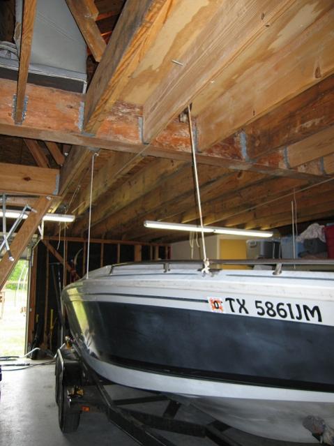

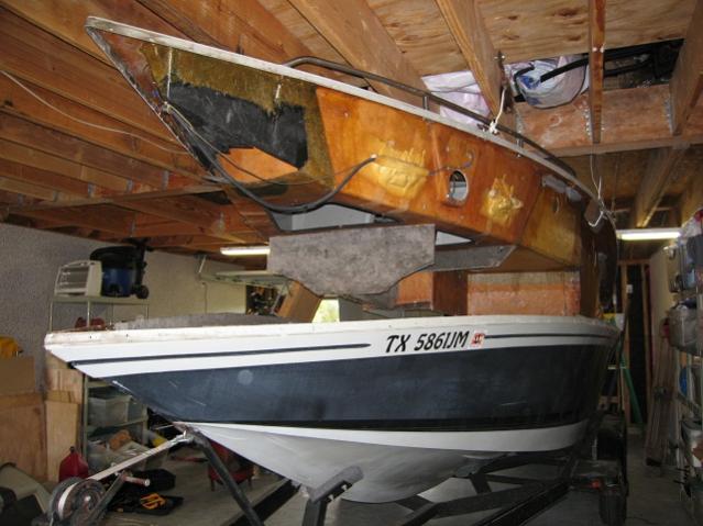

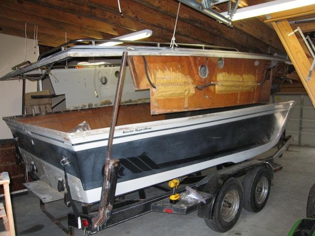

Now that is a cool set up
I think that may be cheating.... lol
Love it!
Wow! What is the lift rated for and what is it attached to on the top side??
Showoff. 8)
I hope to be able to do that in my next house. I already told my wife we will have I-beams everywhere.
ngavdba, that is just nuts. Your lift is pretty much exactly the same as the 1960s vintage lift we rebuilt in my dad's boathouse, but you know, his is in a boathouse not the garage! Nice work, very "outside the box"
Wretched excess! I call foul, not fair, and cheater. Oh & btw - congrats on the really cool set-up.
