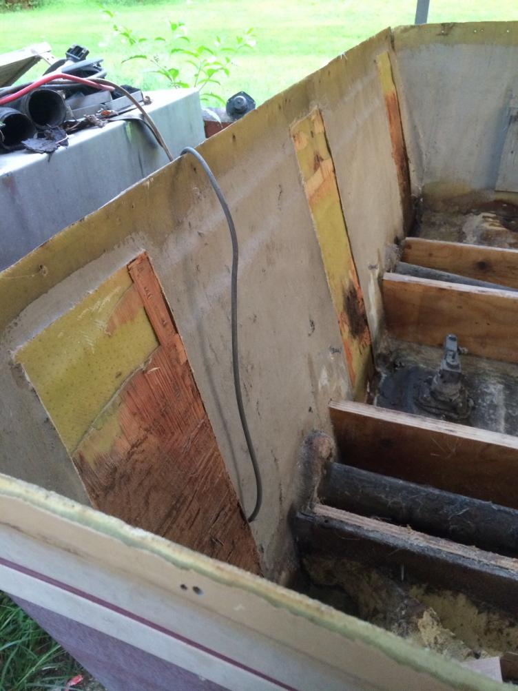

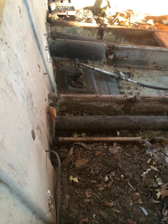

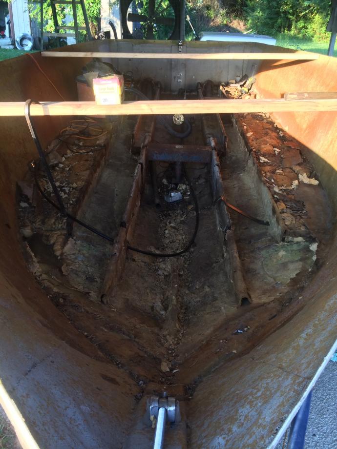

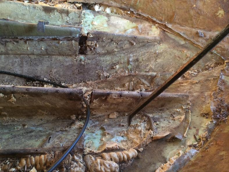

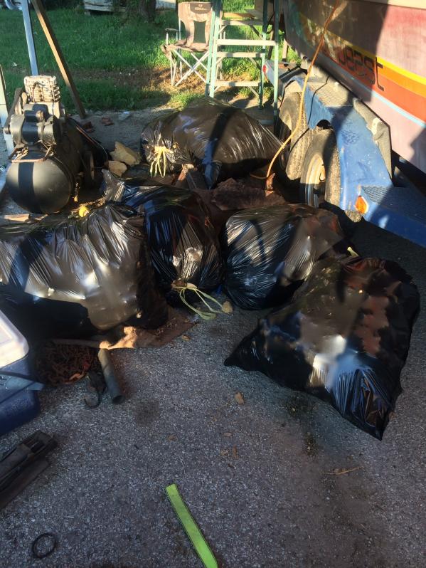

A few hundred pounds of foam removed. Attachment 15062 Attachment 15063 Attachment 15064 Attachment 15065 Attachment 15066

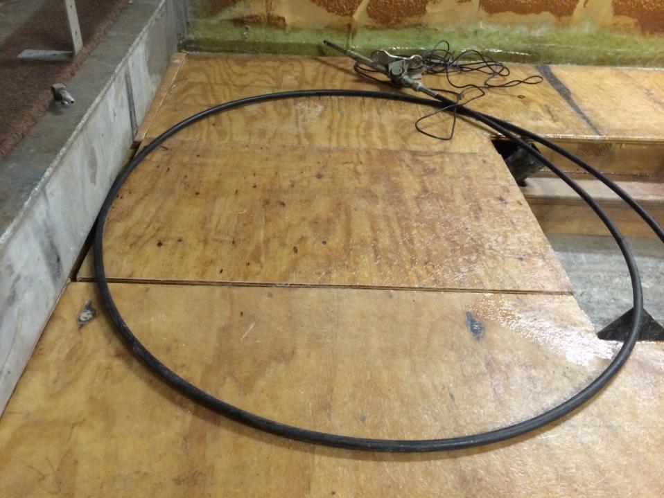

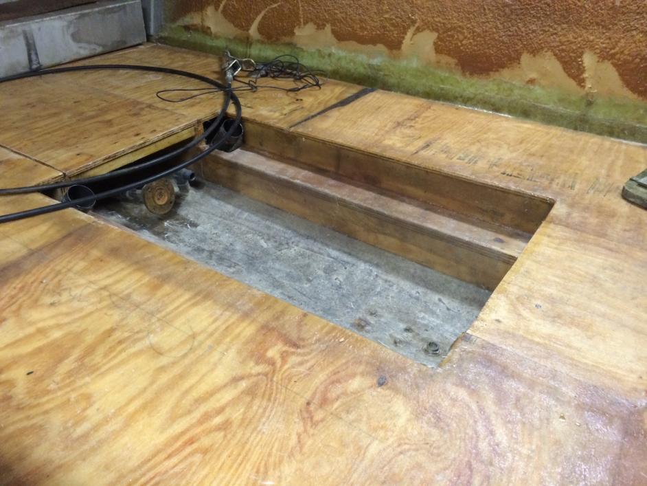

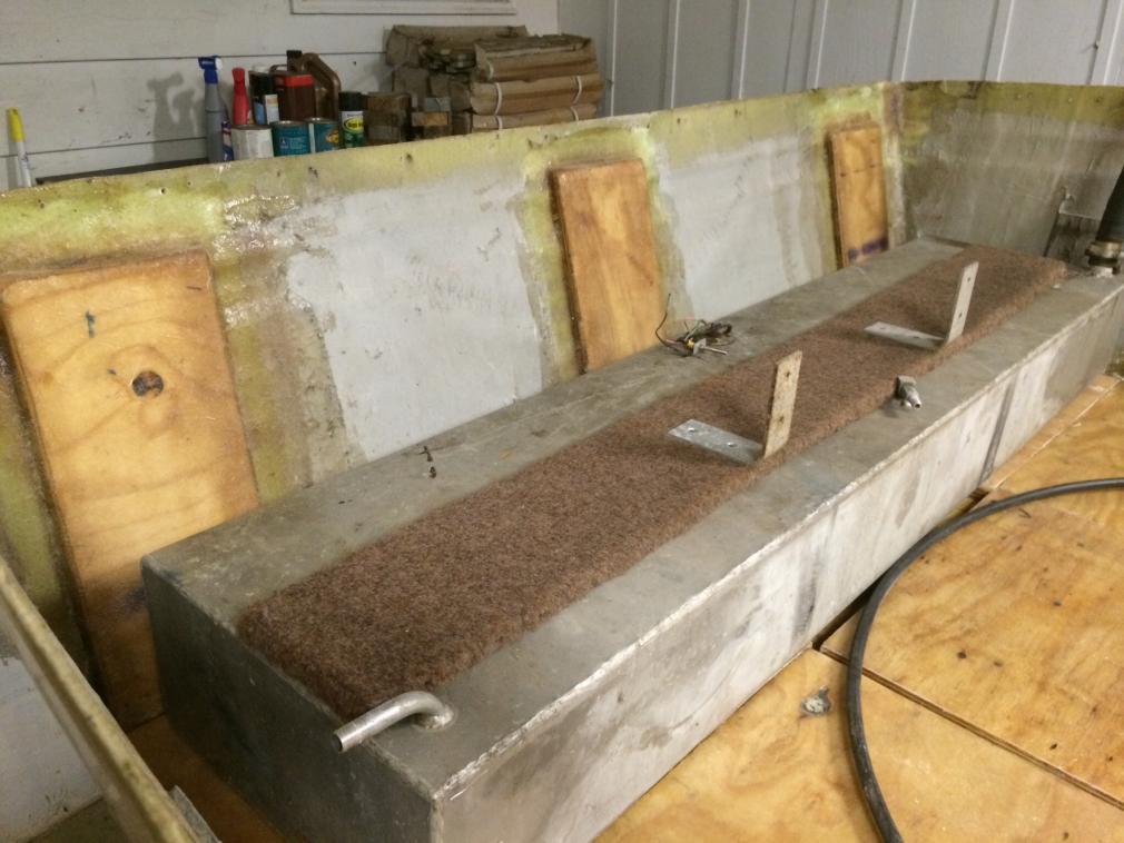

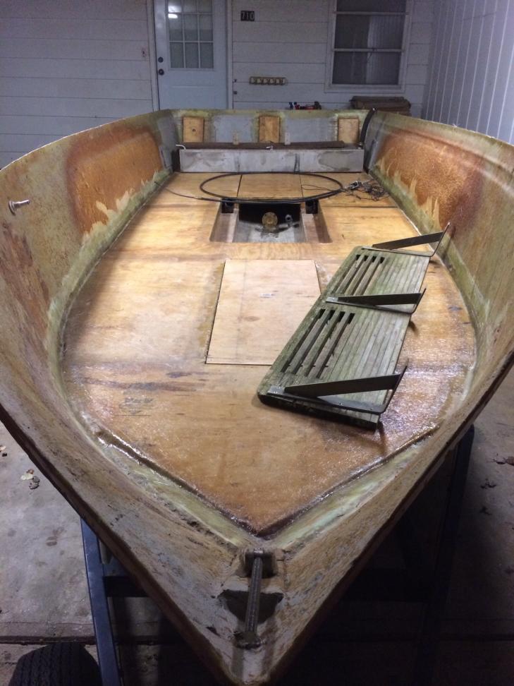

Attachment 15079 Attachment 15080 Attachment 15081 Attachment 15082 floors and stringers done
