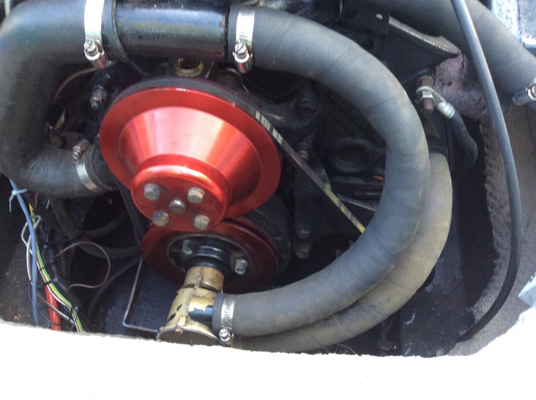

Here is a pic of the front of the engine. Attachment 15841

It sounds like you've narrowed it to the water pump or alternator. WHen you spin those by hand do you feel any binding?
I took the belt off again and started it up - no noise. Spun the pump and alternator pulleys and did not get any "sounds". The only way I can get the alternator to make a sound is if I switch directions when spinning it (so I do not think that is the issue). Ordered a new belt as there was some wear on the side.
