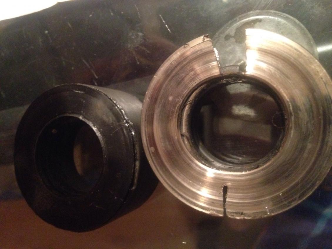

Attachment 16544Attachment 16545Attachment 16546Attachment 16547Attachment 16548
Ok a few questions :
1. Are these couplers supposed to be press fit onto shaft ?
2. The shaft has a small lip from the seal heating up and failing , should I take it it get machined or buy a new shaft and coupler ?
3. Before I stabbed the engine 5 yrs ago I pulled the coupler and shaft together to replace the bellow . But when I removed the set screws the coupler slipped right off and there are two set screw divets in the shaft where the set screws landed . Is that ok ? Does it create a stress point ?
4. Is the prop shaft centered with the rudder or off to the right ? Cause mines off to the right a bit . And when I tried to budge the prop shaft to meet shaft to shaft log true I felt tension and seems I'll have to move strut a bit .
Thanks for the help gents !

As for your question about the shaft, not sure mine will be of much help but here is a pick of the end of my shaft and coupler when I pulled the engine.
Attachment 16549
If you look closely, there is a nut down in the center of the coupler that is threaded on the shaft. There are also two set screws which are probably in the same location as your coupler. From what I can gather is that I have a slightly beefed up coupler and shaft compared to a few boats on here like Rob's Salt which seems to have an affinity for slipping the shaft from the coupler.:p
