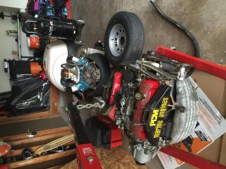

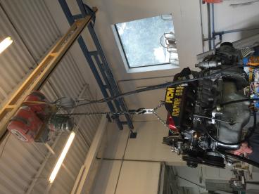

Alright guys, I got the old engine pulled yesterday. Lucked out by a granite shop my brother worked for letting me used their shop crane. Made it simple. Had 6 bolts loosened. Took all of 1 hr to back the boat in. Hoisting the engine. And dropping it into the truck bed. Now time to start swapping parts in the garage and removing those stubborn bolts in the manifolds how y'all suggested. Attachment 17632

I ended up having to swap more than I thought including the water pump, the timing chain cover, the oil pan, distributor, valve covers. Pulleys, oil pump screen, and all the gaskets that go

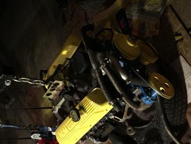

Along with that. So that's where I am today. I received the wr My gasket for the timing chain can get unless that would all be back and installed. While the parts were off. I cleaned everything in engine degreaser and Clr. Added some paint and poof. Blue and yellow theme.

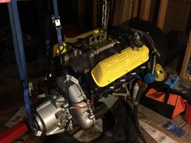

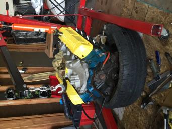

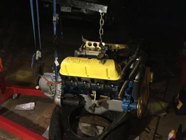

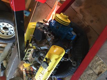

Anyways I'm going to get after the headers again sometime but iv been staying pretty busy with everything else. today I got the timing chain cover, water pump, harmonic balancer and all my pulley assemblies besides the alternator on. I also got the transmission transferred over as well. all that's left is valve cover gaskets to get them back on permanently. A gasket for a water intake. And of course the headers which I can assemble after the motor is in back in the boat if need be. Here are some pictures.

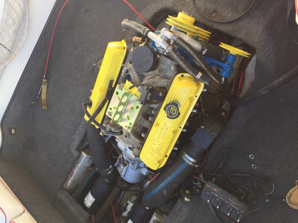

Here is is dropped back onto the boat. I won't get it out this season but I hope to have it ready for next spring. Thanks for all the help and I am sure I will have more questions as I hook everything up especially electrical. Attachment 17782
