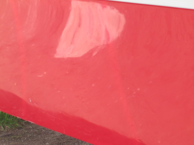

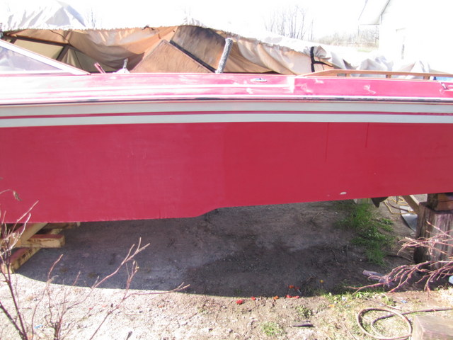

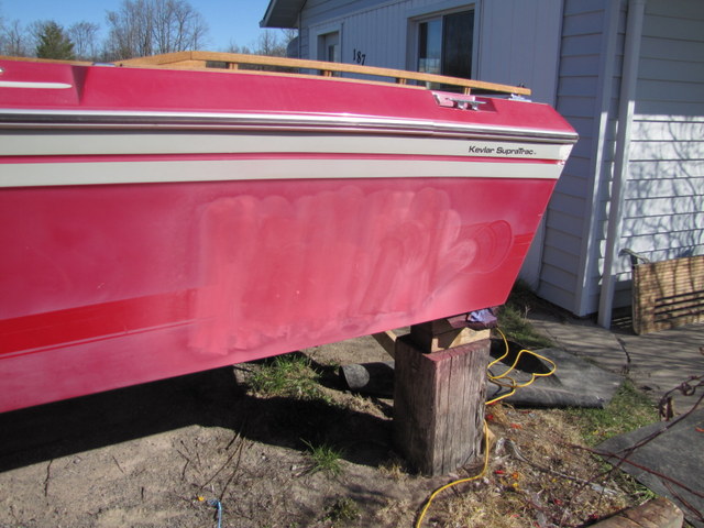

Finish sanding the blasted hull!!!! :) All I have to do is Buff it with compound. Hopefully it doesn't rain tomorrow even though it says it's going to. Will post pics when hopefully tomorrow.
Looks good...so have you compounded or polished at all yet or is that just after sanding?
Looks really nice.
It has compound and polish on it. Just have the right side to do with compound and polish. :)

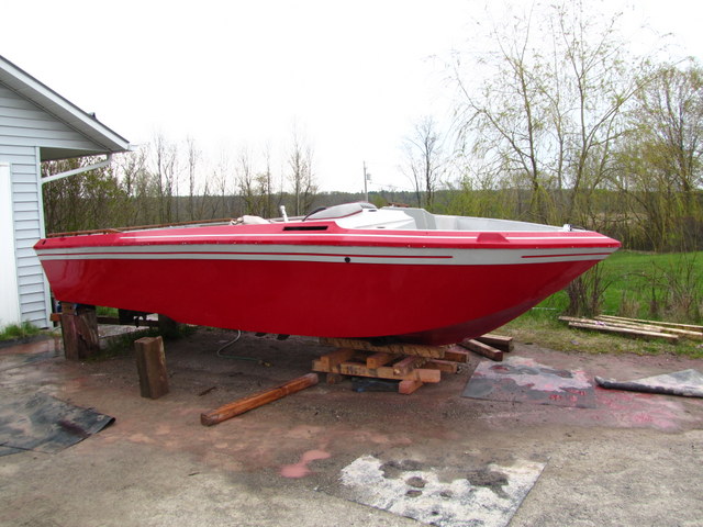

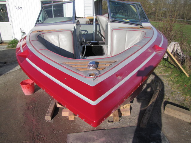

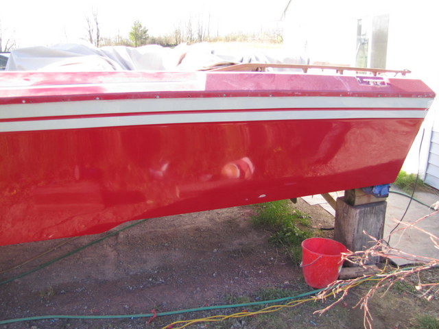

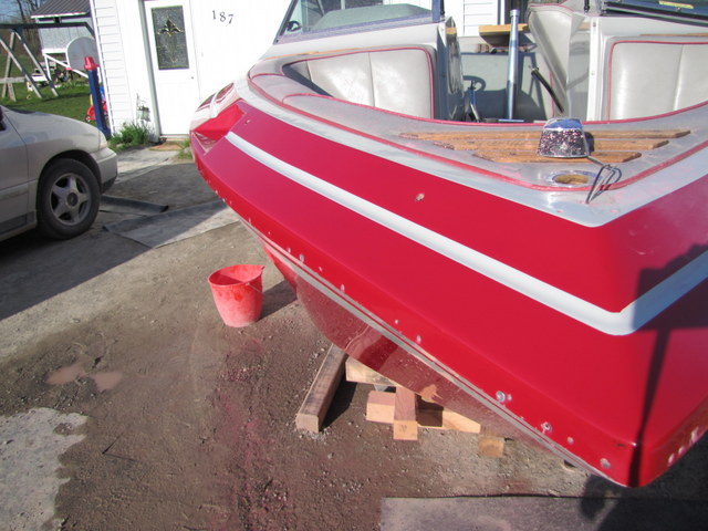

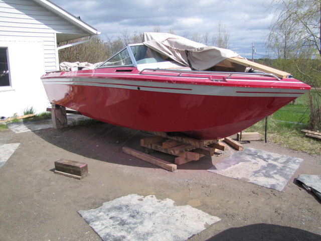

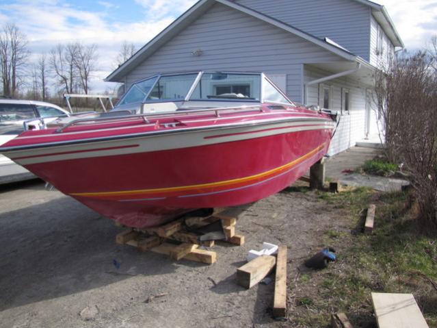

Finally!!!! got the right side done today...well except for the bottom itwas to wet to lay under the boat and finish it. Hopefully on the weekend. Time to start the top. (sigh) at least there isn't much more to do, and the plus side is I can do it standing up....my back is killing me.
Here's the pics.
Attachment 9592Attachment 9593Attachment 9594Attachment 9595
she looks good man ! all that hard work is finally paying off ! cant wait to see when its all done
Showed my son Nolan a recent pick of the boat. He said "Nice ski boat!!" Then I informed him he used to ride in it !! Had to pick his jaw up from the floor.
hahaha! thanks. Still don't know what I want to put on it.... I have an idea... lets see if it works... stay tuned.

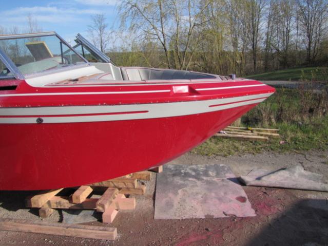

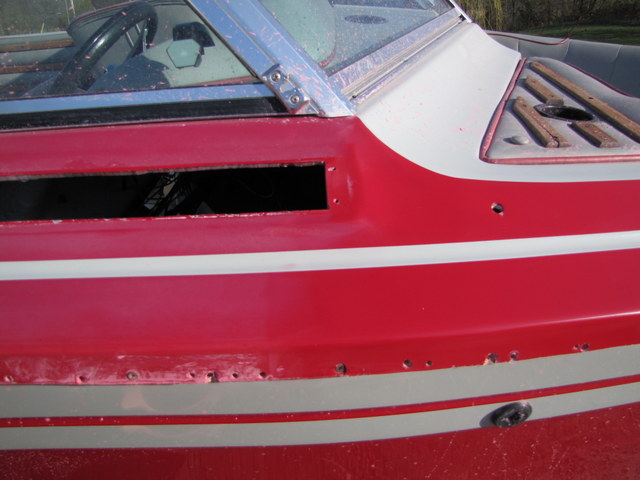

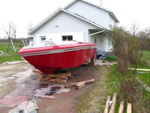

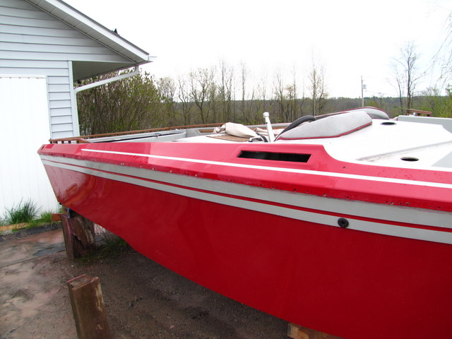

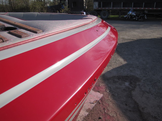

So I didn't have all day but did take a few hours to work at the top. Took off the bow rails, cleats and went at it. Am doing the top by hand for the most part and got the right side bow portion done. I'm doing small sections but completely finishing them. Question... How hard is it to take off the windshield? I realize that most wouldn't... but looking to do a thorough job. Here's the pics from today's work.
Attachment 9625Attachment 9626Attachment 9627Attachment 9628Attachment 9629
Amazing restauration ! Can you list exactly what do you use for that work ? What sand paper, what polish, what tool ? I would like to do the same on my hull.
6" orbital sander, 320,600,800,1500,
used my 7" rotary buffer, 3m buffing compound, Yacht Bright's Buff Magic, and pro polish.
Had to go down to 120 for the hull. 320 for the top.
One more... I can't get over the difference.

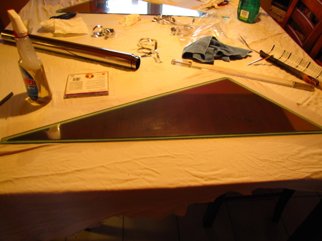

Decided to tint the side windows... should I do the fronts too? Suppose to be mirror finish 20% tint.
Attachment 9679
I got looking how much I have taken apart.... almost into stringer rebuild territory! :)
The boat looks naked.
Often thought of tinting the windows too, don't worry about tinting the fronts(just do it) . You will find you rarely sit while driving. I would stand with one hand on the RHS window frame and a knee on the centre portion of the walk through while the other hand on the wheel. I liked the extra vision while driving plus the wind in my hair. You might find it different on an inland lake, but I doubt it.

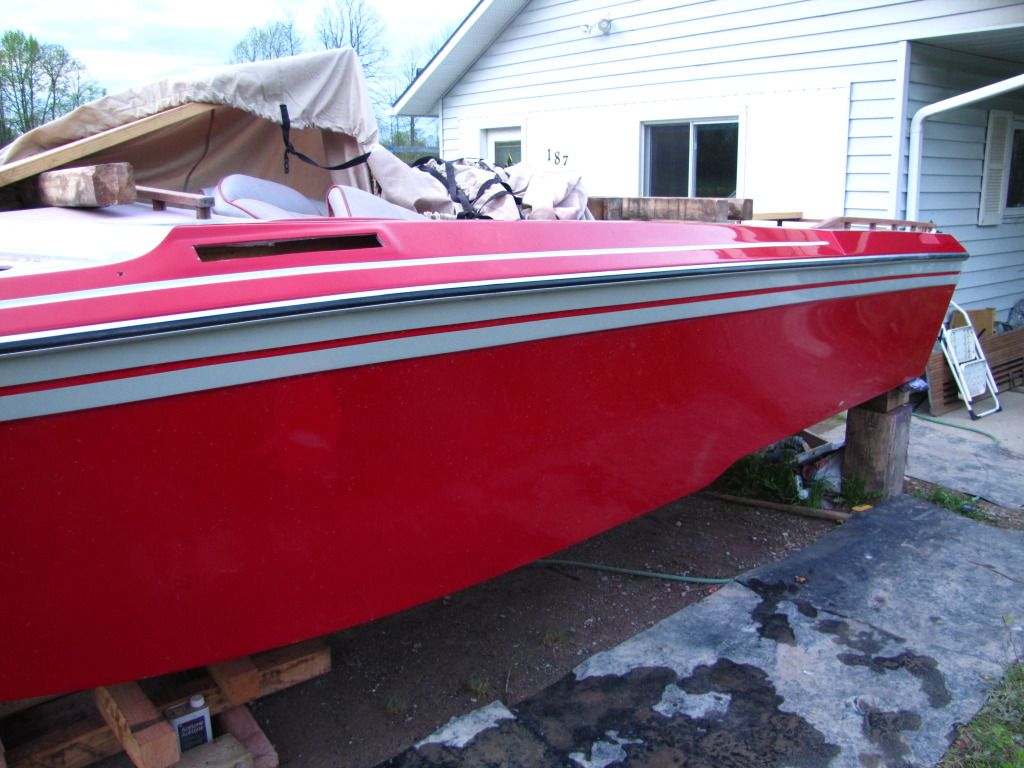

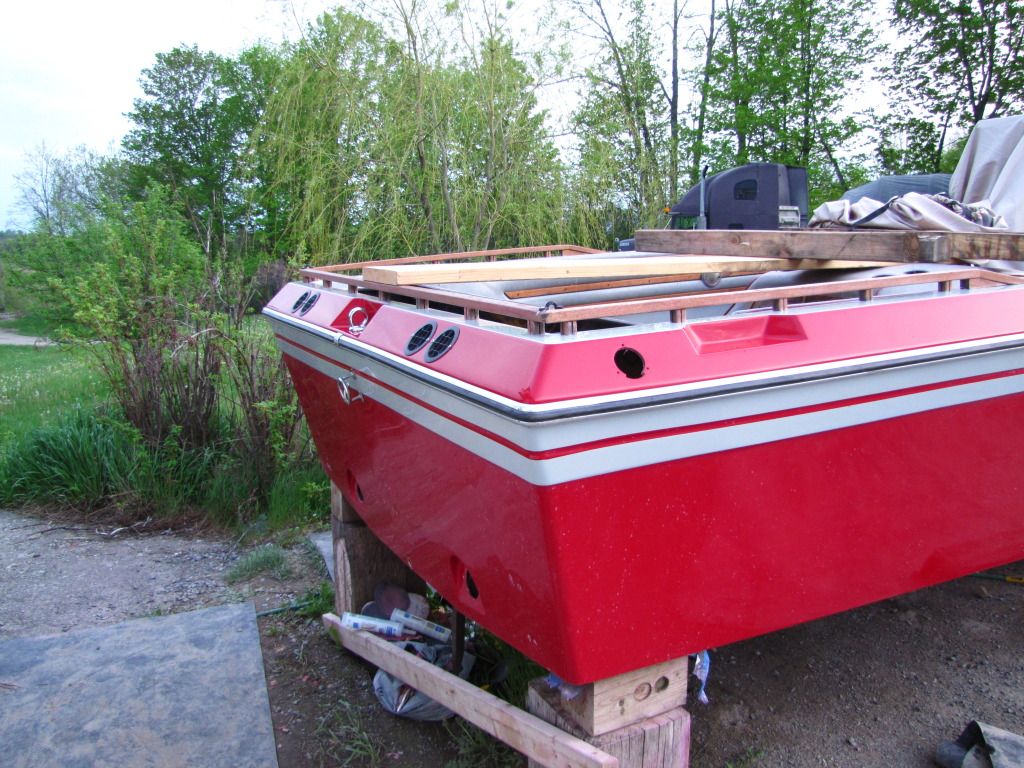

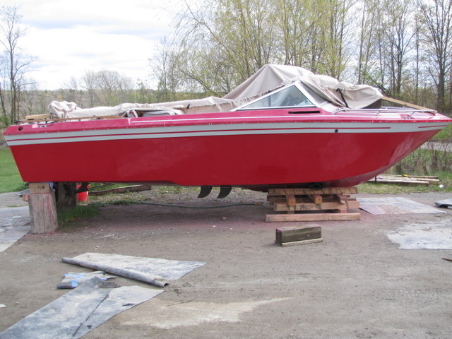

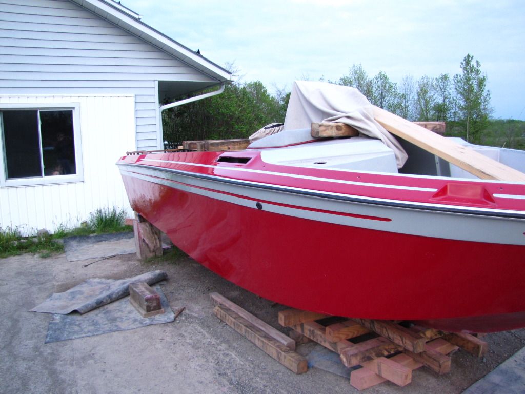

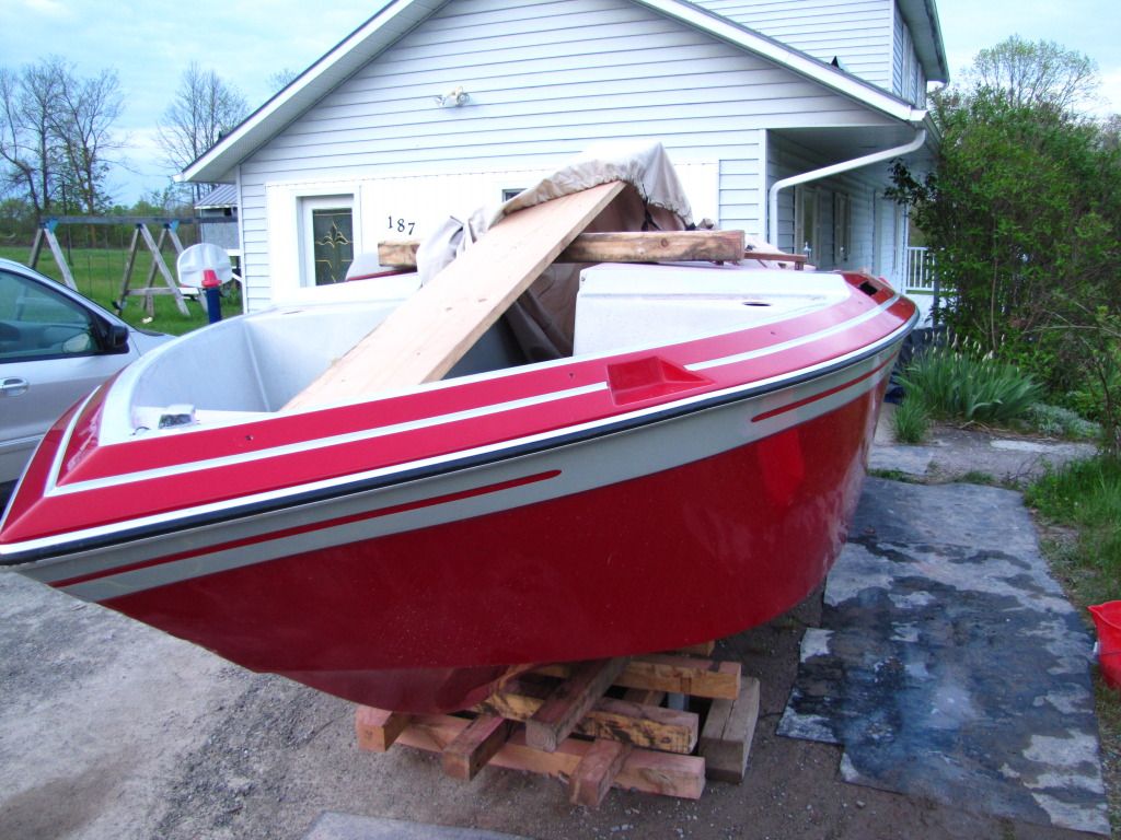

So this afternoon has been the first time in almost 10 days that I've been able to work on the boat.... grrrr. Anyways got the top finished, rub rail back on and rear lifting hook/ tow hook in, and rear vents... Lot of time on my feet but finally I'm done with all the sanding... just have to clean and put her back together. My tower came in, I have to got and pick it up, so lots of work next weekend. Thinking It should be on the trailer and in the water by the beginning of June....I hope.
http://i1067.photobucket.com/albums/...i/IMG_1214.jpghttp://i1067.photobucket.com/albums/...i/IMG_1213.jpghttp://i1067.photobucket.com/albums/...i/IMG_1212.jpghttp://i1067.photobucket.com/albums/...i/IMG_1211.jpg
http://i1067.photobucket.com/albums/...i/IMG_1210.jpg
Sorry for the water spots. :oops:
Looks great!
Looking awesome. You've got that shining great.
She sure cleans up nice!

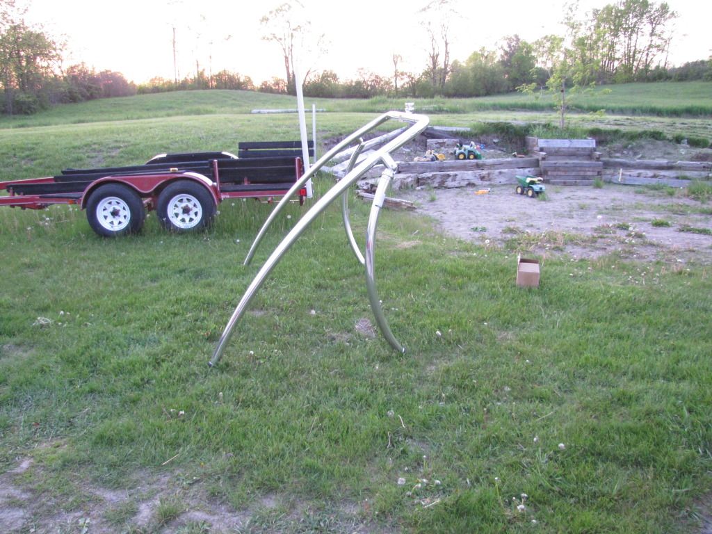

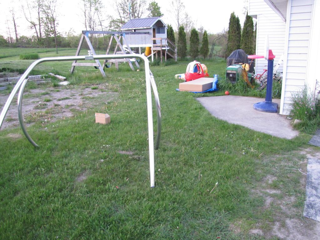

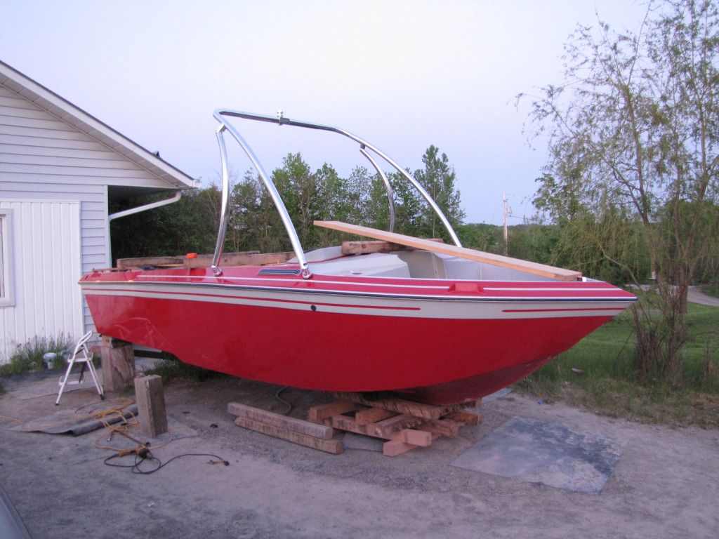

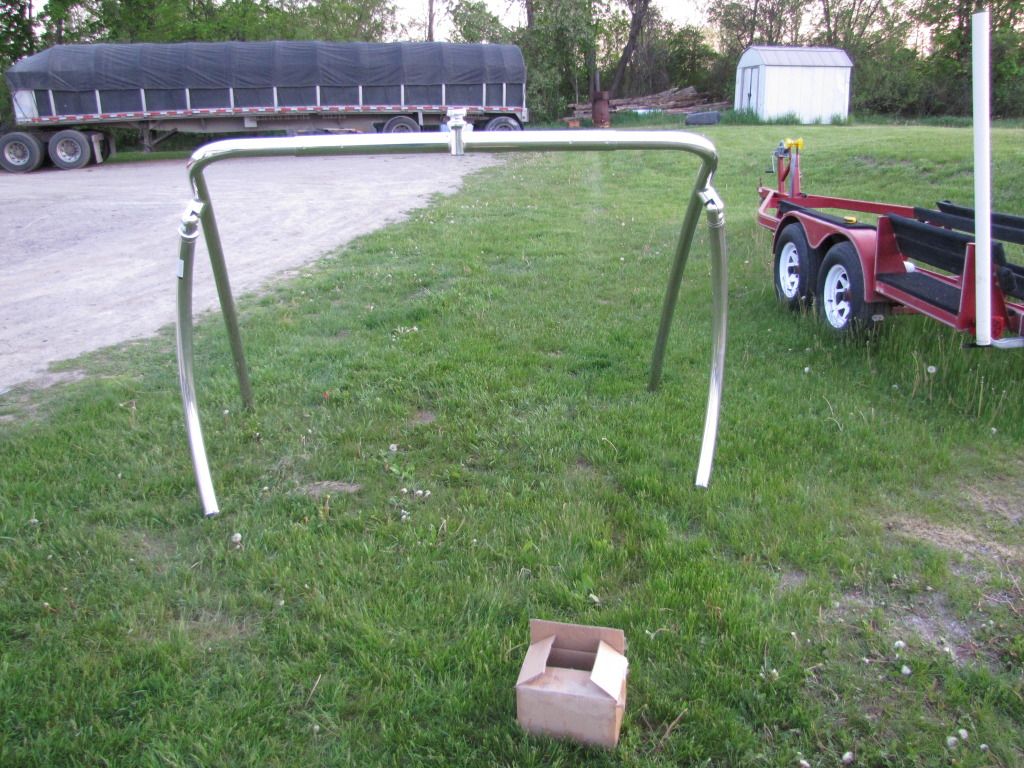

Ya it sucks but I'm piecing it together now. Picked up my tower yesterday... did a quick set up on the lawn to see what it looked like... I don't mind it.
http://i1067.photobucket.com/albums/...i/IMG_1229.jpg
http://i1067.photobucket.com/albums/...i/IMG_1230.jpghttp://i1067.photobucket.com/albums/...i/IMG_1233.jpg
Not sure if I like how it bows out... I can adjust it a little, and maybe it will depend too where the feet get place.

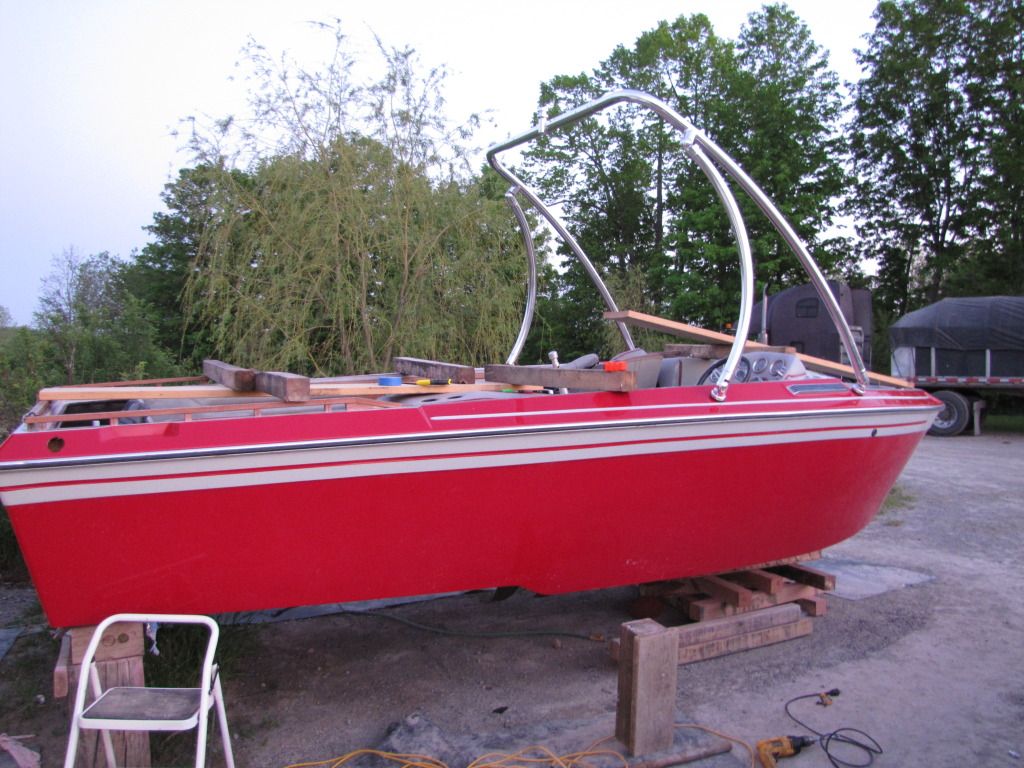

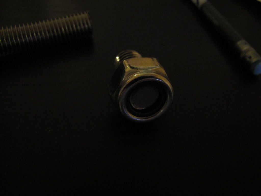

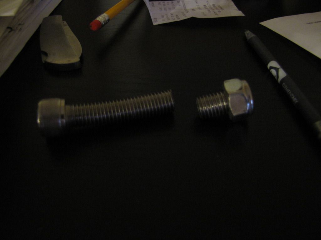

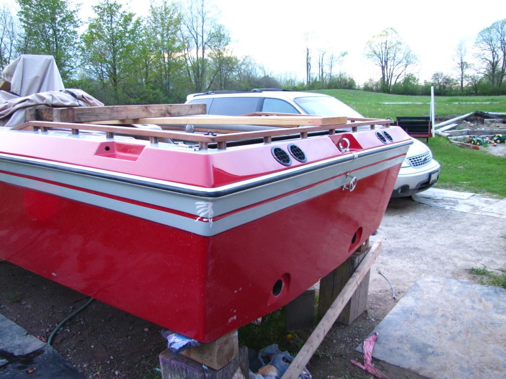

well..... not the best of days for me. Tower is almost on... really tough to put backing on and wiggle my arms in the small spaces. On top of that on one of the bolts the thread was damaged a little bit but I decided to use it anyway.. long story short I ended up having to snap the bolt to get it off. Gonna see if they'll send me a new one...I doubt it. anyway don't think it looks to bad any thoughts?
http://i1067.photobucket.com/albums/...i/IMG_1234.jpghttp://i1067.photobucket.com/albums/...i/IMG_1235.jpghttp://i1067.photobucket.com/albums/...i/IMG_1236.jpghttp://i1067.photobucket.com/albums/...i/IMG_1240.jpg
Didn't even make it to the nylock...

tower looks great. red/grey hull is a knockout. gonna be turning some heads for sure.
The rear arms on the tower will swivle in.
I just put a realy similar tower on the bravura last week.
I like the way they bow out less chance of hiting your head on the tube.
