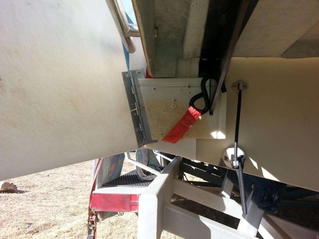

I wonder what I could pull off. As it is, I can get a surfable wave with the following:
- 250 under rear seat
- 370 on surf side floor beside doghouse
- 750 on top of the 370 bag, as far back into the back seat as possible
- Passengers sitting middle/rear and observer seat.
- No bow weight, wake plate 3/4" down
- I have another little 150 bag I can throw wherever, but we haven't played with it too much.
So, with that setup, we're certainly listing. We run water to the rubrail to the first rear cleat when underway and also are about 4 to 6" below the rub rail at the rear corner at rest.
Our floor space then is most of what's in front of the observer seat, the floor on the non-surf side beside the doghouse, and a little spot of floor behind the doghouse (back/middle).
I'm wondering what a surfgate change would really look like. if anything I'd imagine it'd mean I could move the 370 to the non-surf side which would mean that all the floor on either side of the doghouse would then be gone, but the boat wouldn't be listing that much. DEFINITELY a trade off when I'm working with a DD. Of course I'd like to run less listed, but I'm not excited about giving up any more of my already limited space...
Thoughts? I'm totally open to discussion/suggestions from other boat owners...
