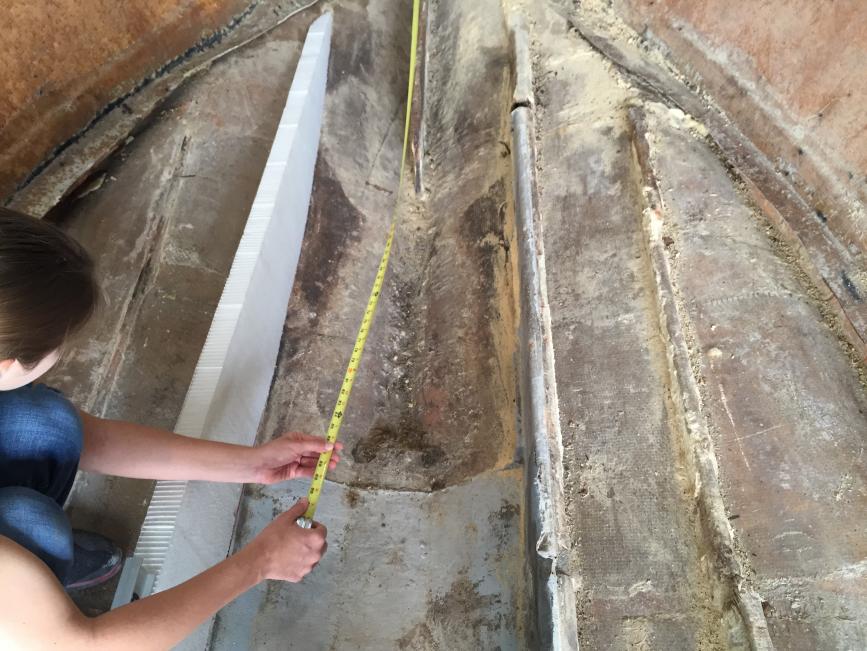

Flips, you didn't happen to take a measurement of the placement of the two rectanglur holes cut in the floor where the cables and wire harness pass through, did you? I can't seem to find that dimension in my notes. I have pictures but want to be more accurate. I'm going to make a trip to measure my top deck this weekend, but thought you may have an answer.
How's your boat coming along? Im excited to see your progress, seems you've been moving quickly. I'm def Interested to see another restored Mariah!

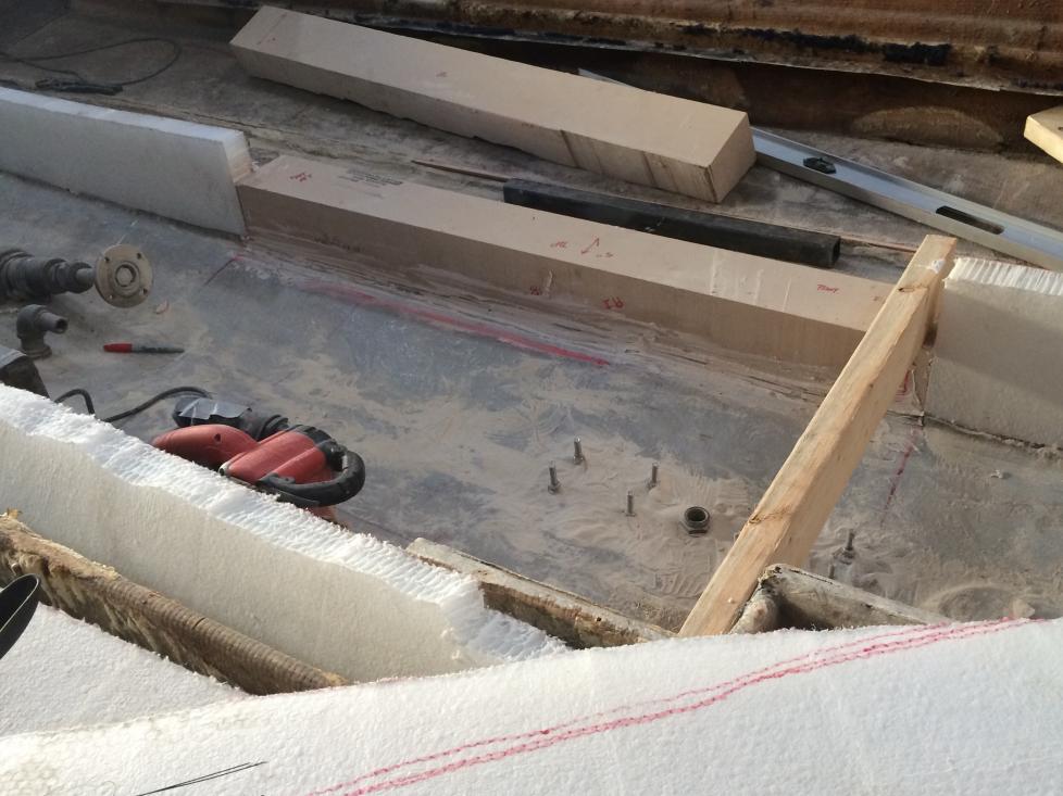

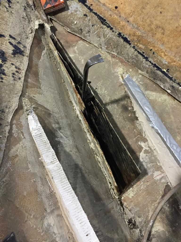

I actually didn't take dimensions for that. I do know the width of it was just wide enough to have the the wire housing (pipe) to pass though. I just remember it was tight. The location on the floor is right where the built in cooler is and just inside of the longitudinal stringer. I will be working on it tomorrow so I'll see if there are any other references.

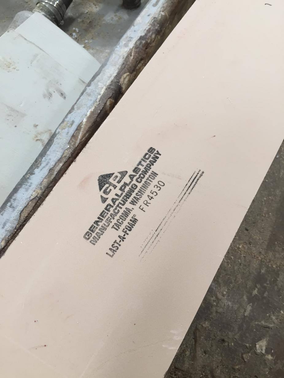

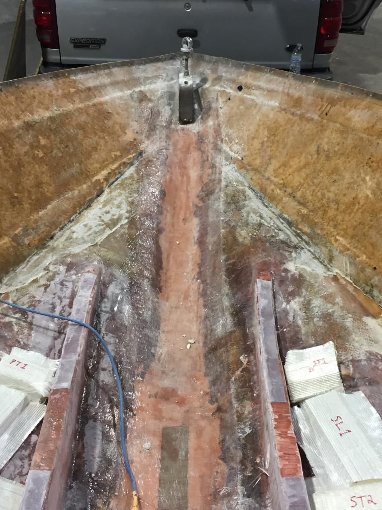

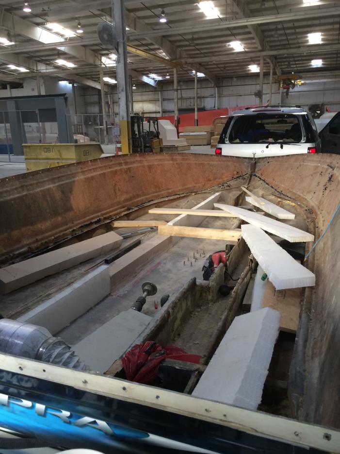

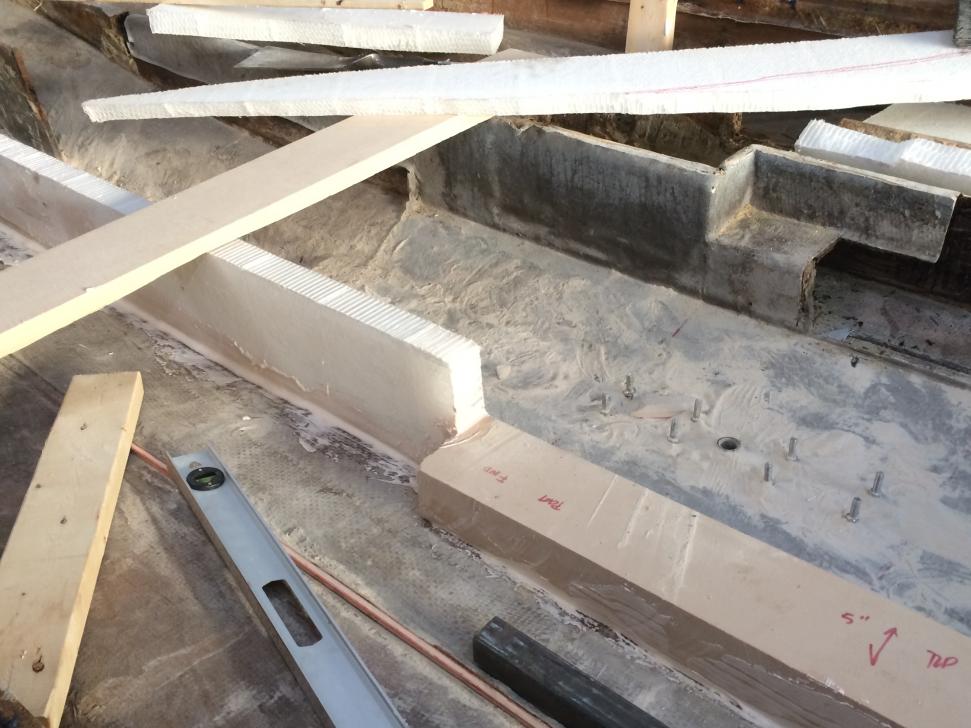

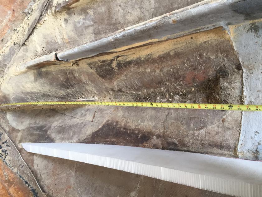

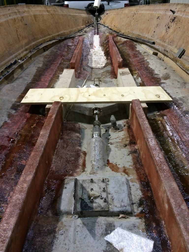

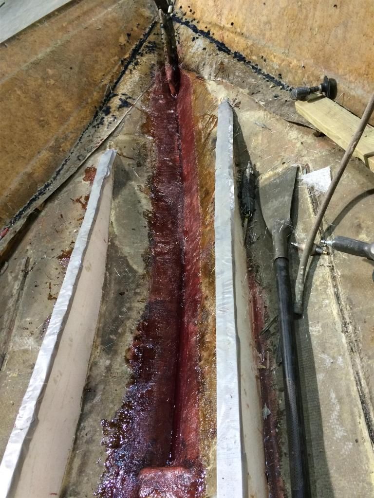

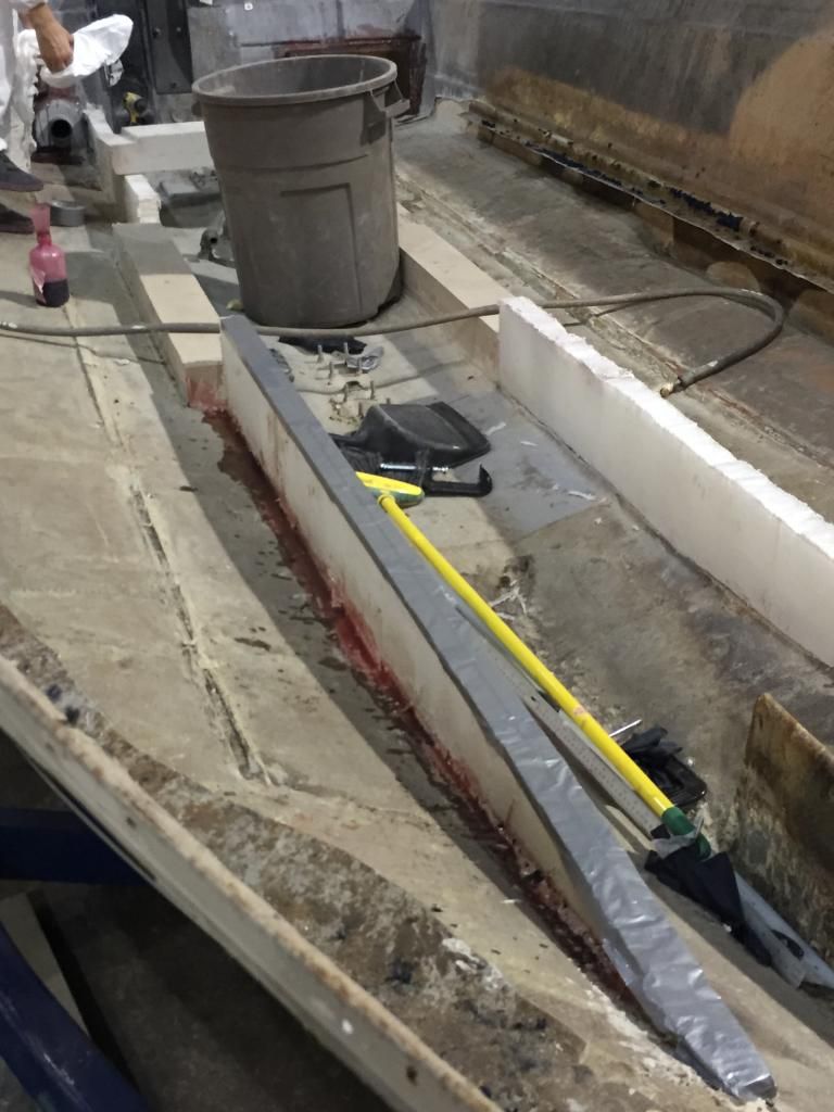

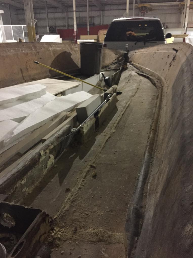

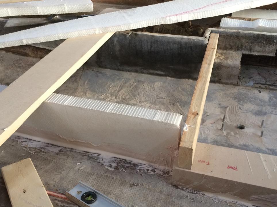

As far as progress on the boat, I have changed directions as far as material. Although I already bought the lumber, I decided to go with wood free stringers. I will be using a mix of 2" thick Nida Core, 3/4" divinycell, and various density foams blocks (I have access to scrap between 2lb and 30lb) for the bulkheads.
Engine well mounting material...

That foam is interesting and it seems like you know what you're doing. How does it compare in cost to wood?

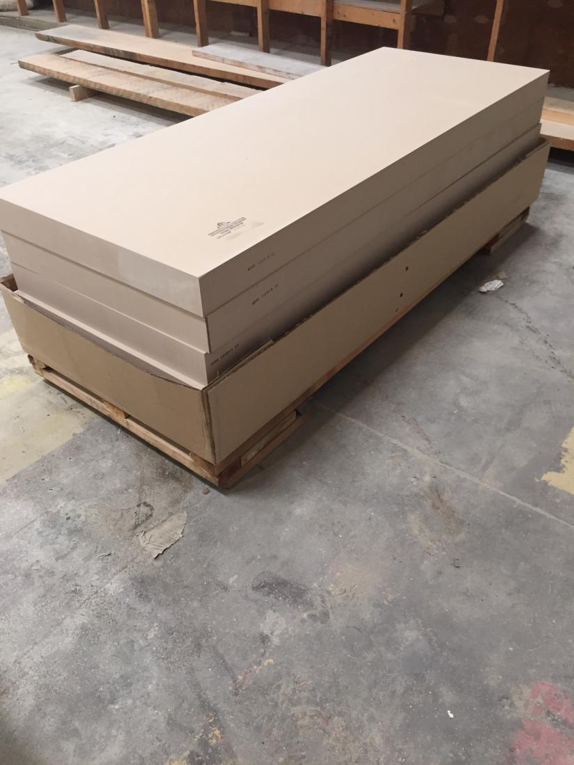

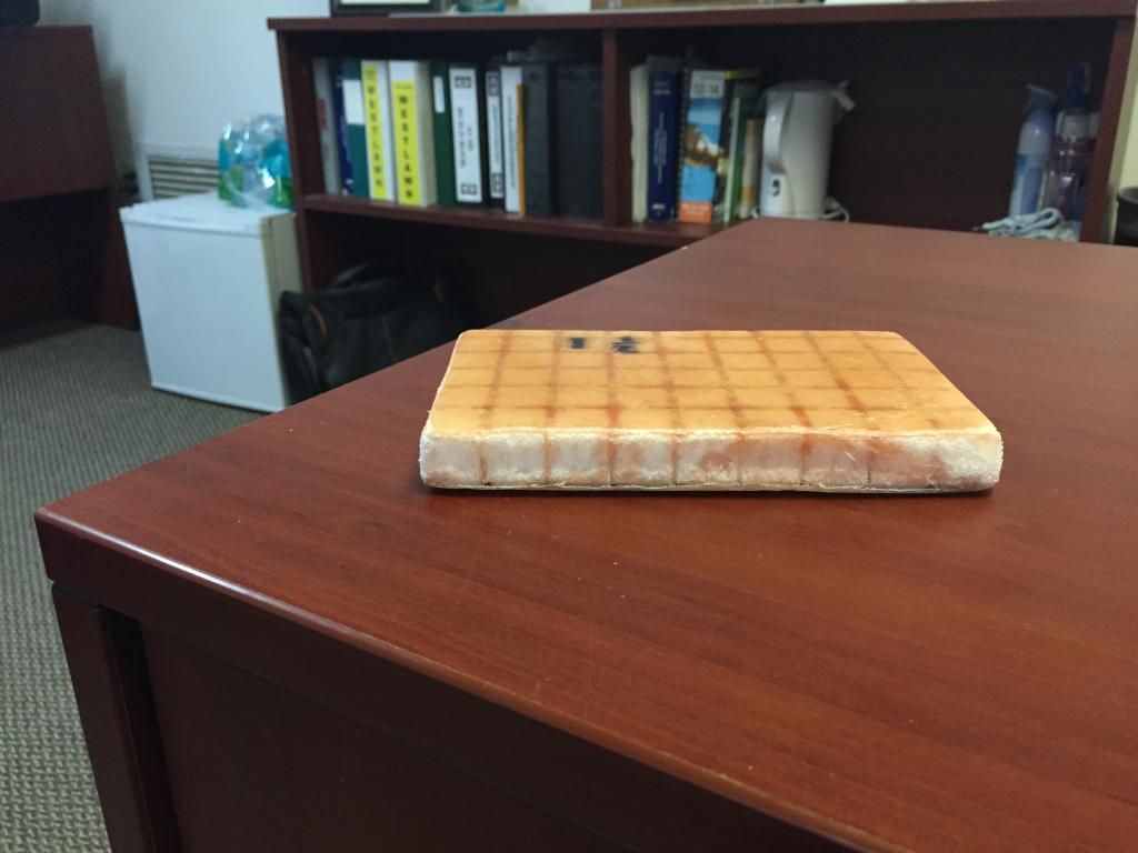

Its pretty expensive material. About $1K for a sheet of 3'x7'x 6". Luckily, I was able to get my hands on some scrap. Otherwise, I would have used wood.
Attachment 15468
The compression strength is considerably higher than wood. Douglas Fir for example is about 400 psi. This high density foam tooling board is 2,185 psi @ 75° and 1,384 psi @ 160°.

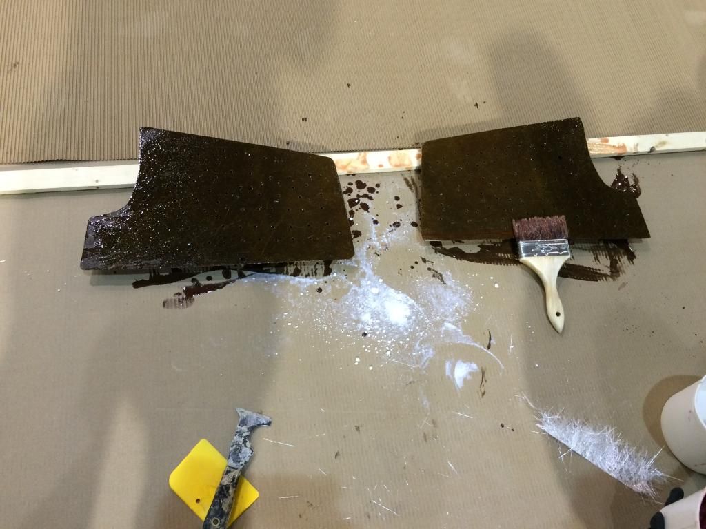

Test panel and removed swim platform
I chopped 1.5 oz on both sides of a test panel of Airex T90. Its pretty strong and light. I was thinking about vacuum bagging, but it would be a lot faster to chop.

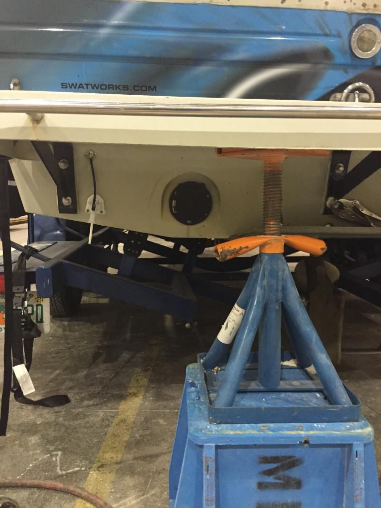

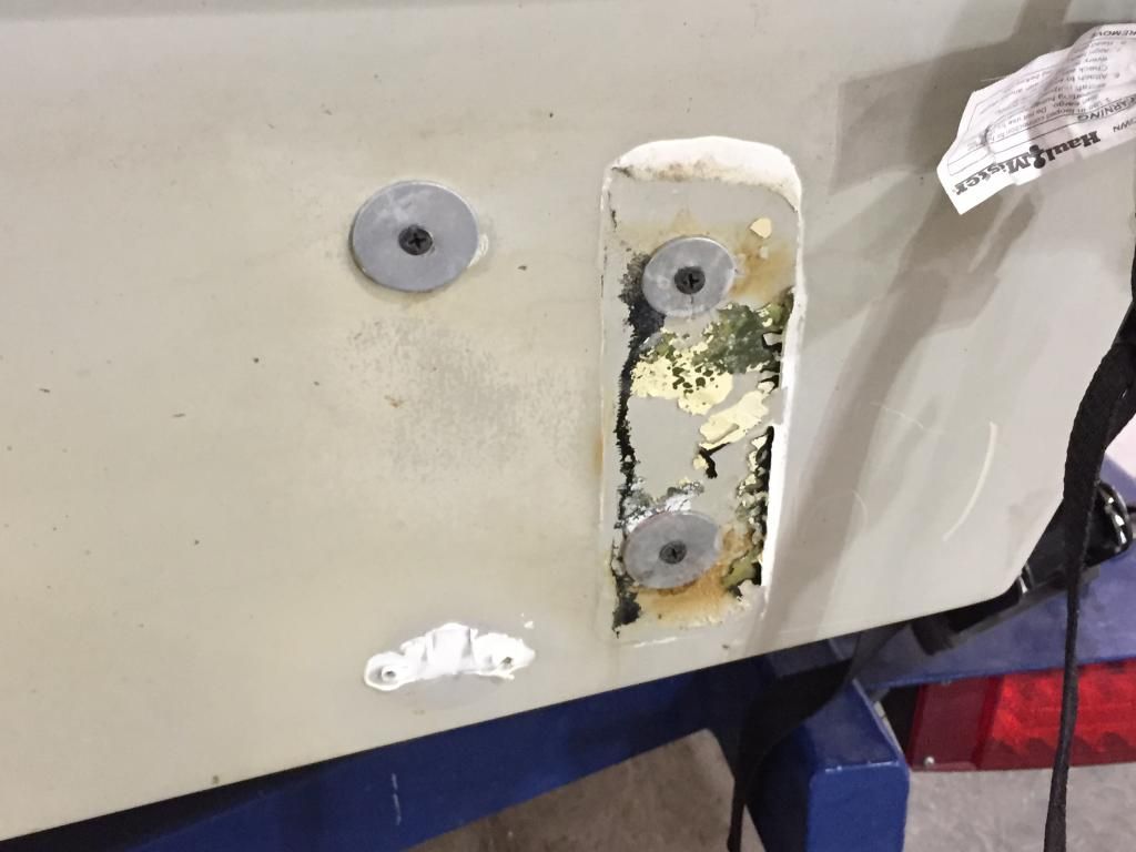

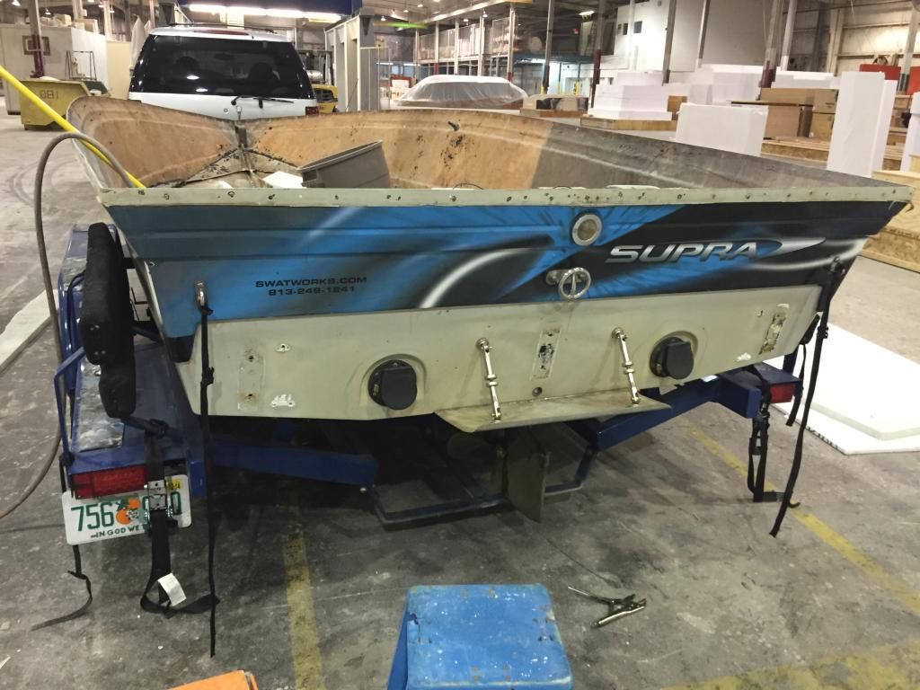

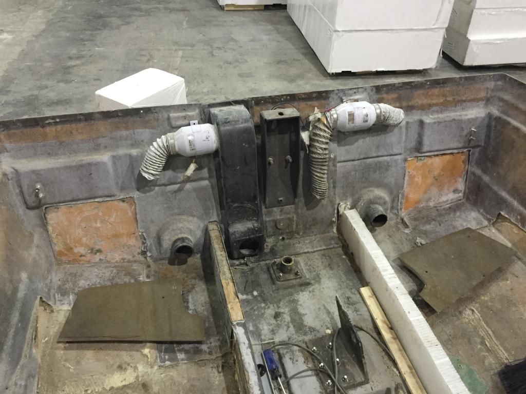

I also removed my swim platform to get access to the transom boards. I plan on moving the outer brackets closer to make room for an actuator for a surf tab.
http://i722.photobucket.com/albums/w...ps84534e91.jpg
http://i722.photobucket.com/albums/w...ps6246fa12.jpg

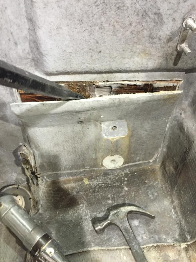

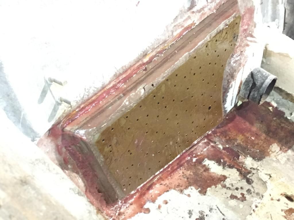

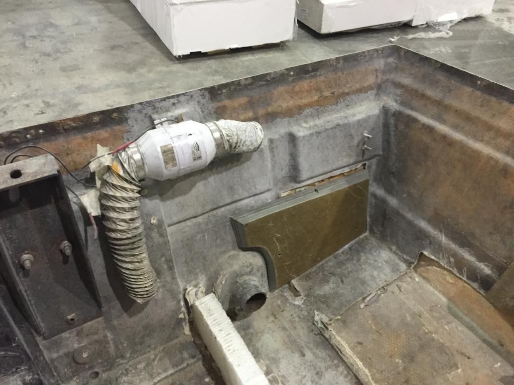

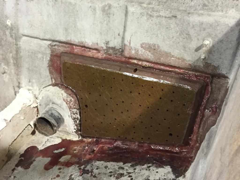

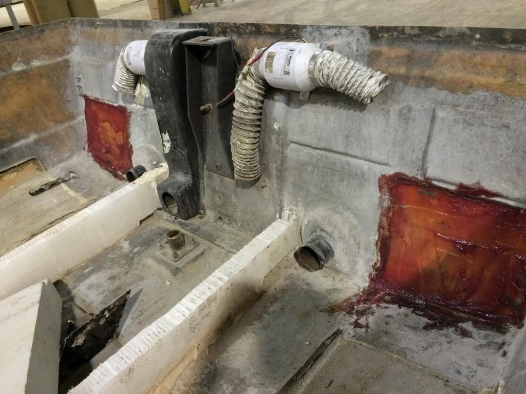

Replacing Transom Boards with Coosa
I had one dull sounding spot on the portside outboard bottom corner. I am replacing them with 2" Coosa board and cut it to shape. I made them a little bigger to accommodate the moving of the swim platform brackets. All others were solid. I am going to go ahead and replace the starboard side even it was solid. I am keeping the top ones original. I have still have quite a bit of grinding to do before the mount and glass these in.
http://i722.photobucket.com/albums/w...ps916e130f.jpg
http://i722.photobucket.com/albums/w...ps8c91ee96.jpg
http://i722.photobucket.com/albums/w...psa007a4e0.jpg
http://i722.photobucket.com/albums/w...psbce2f7bd.jpg
