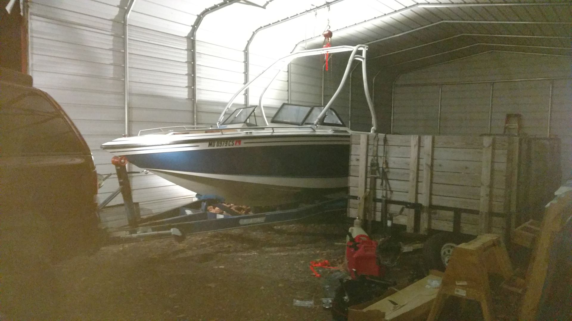

Been busy with work so not much to update but here's some tower peeks. I still have to mount the front. With winter storm Jonas rolling in, its covered up until I can get back out to my buddies house to finish the tower.

That's a nice looking tower on the Saltare.
Do you plan some speakers on it ?

Got the tower finished up and the bimini is on the way!

That looks great except for the snow!
You got that right! I'm in need of summer

UPDATE- Roswell Bimini and tower mirror arm came in, have to wait to install because the tower collapsed is about 6" too tall for my garage door. So once spring hits, hopefully the speakers, bimini, and mirror will go on. I finished the last seat bottom now onto the seat backs. Im thinking of splitting the rear ski locker pad into two separate pads and adding a teak walk through so you don't have to walk across the padding to get in and out of the back of the boat.

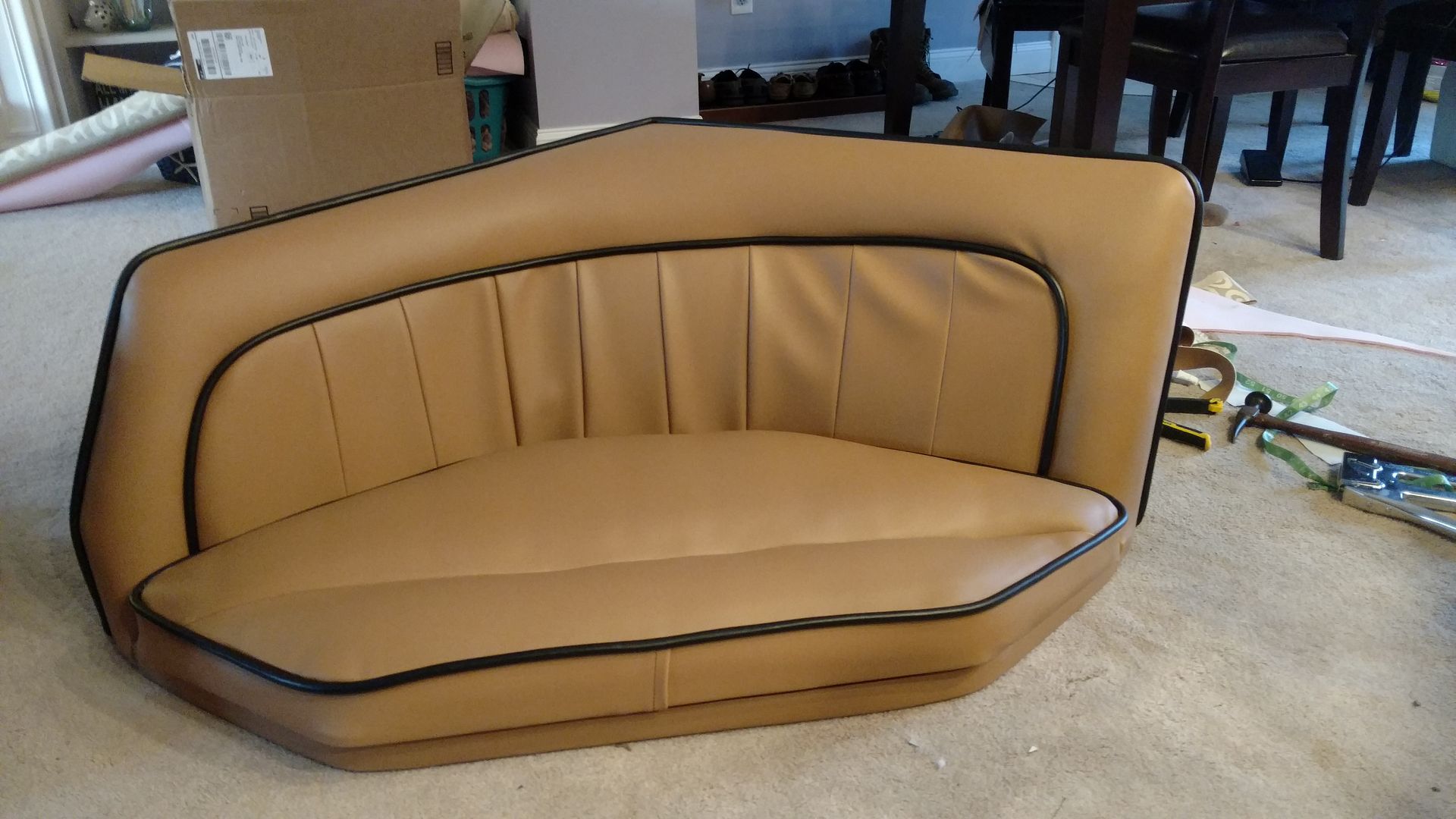

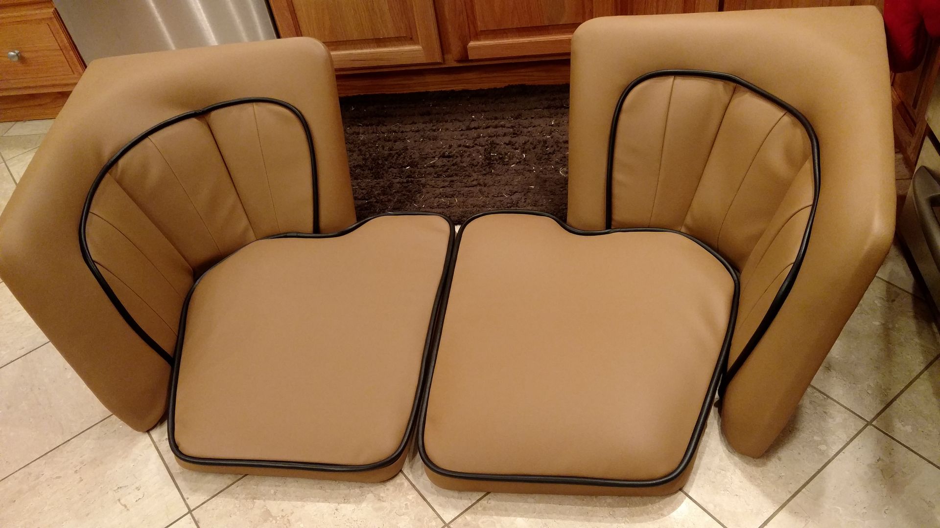

I got 2 of the 3 bow back pieces done. They have some wrinkles that I couldn't get out without taking everything back apart, but Im happy with them. They don't stand out as much in person as they do in the pic.
http://i968.photobucket.com/albums/a..._171518645.jpg
I swear man. You could have a second career. I really like that tuffed look on the back rests.
Thanks for the love Titan!

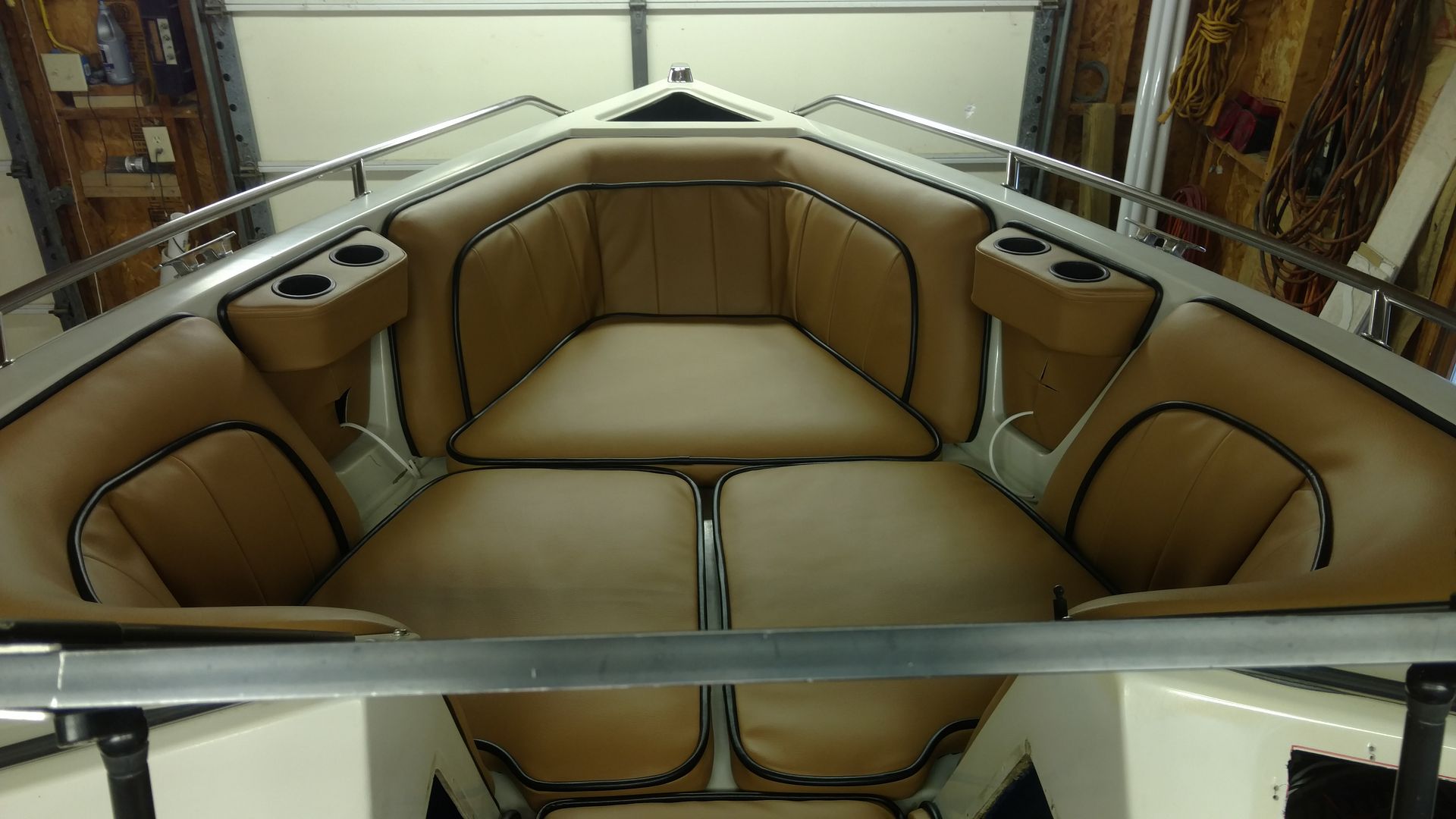

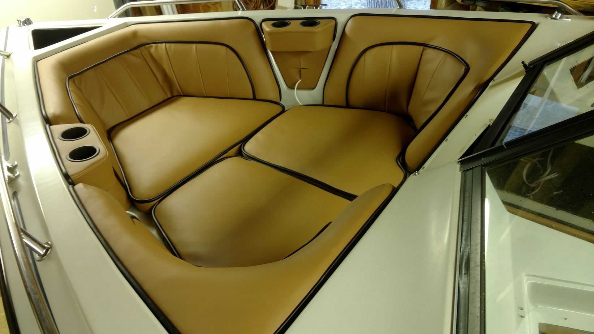

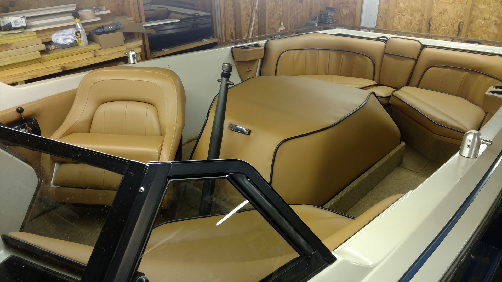

Found some time today to set the bow area in... Onto the pics!
http://i968.photobucket.com/albums/a..._153605526.jpg
http://i968.photobucket.com/albums/a..._153737855.jpg
http://i968.photobucket.com/albums/a..._153650264.jpg
Very slick looking
That interior is awesome! Very nice work, I love the colors you've picked. Not something Id have thought of but it is bad ass.

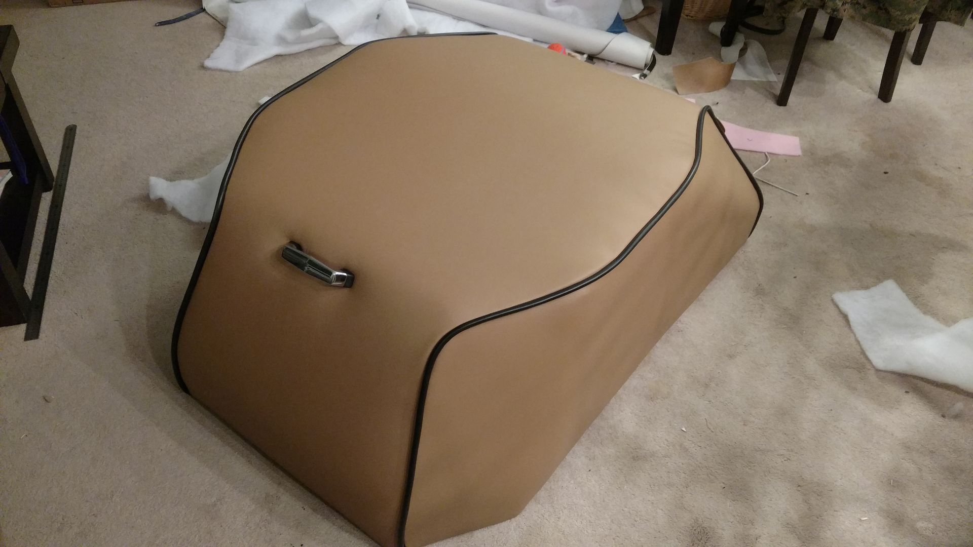

Thanks guys. Here's the observer seat and motor cover

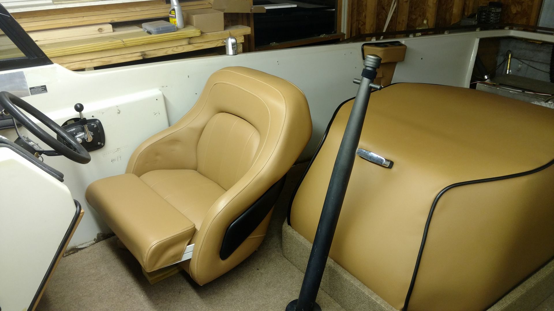

Test fitting the driver seat. Pedestal is on the way along with two new control cables and connectors. Going to replace this stuff before I mount the interior, last thing i want is a huge grease smudge on the new interior :(. Hopefully I can sew up the two rear seat backs this weekend.

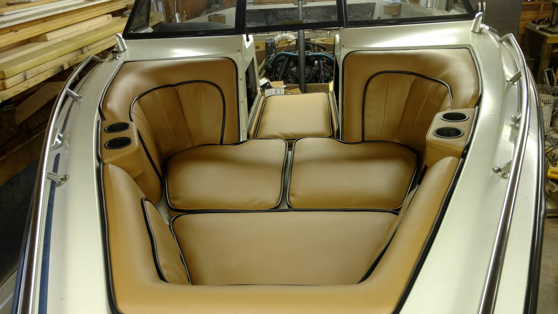

I installed my new control cables with new brass fittings, seat pedestal and interior pieces. I'll have to cut the center rear seat a little skinnier for a better fit. Next will be installing the sound system and some other goodies
http://i968.photobucket.com/albums/a..._202326686.jpg
That interior is a one-of-a-kind. What a unique color combination - great work.
Wonderful color, very nice DIY job !
Can't wait to see it finalised.
Impressive!
beautiful.
