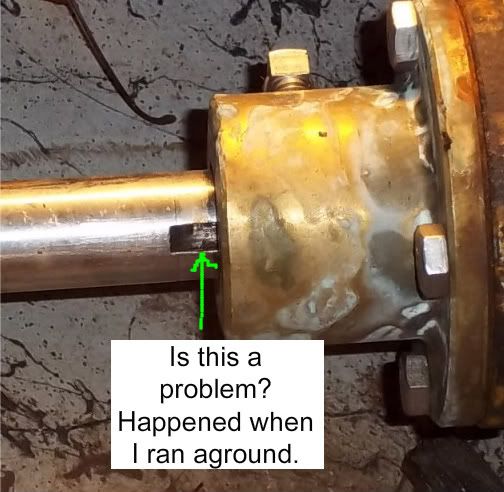

I have no idea how to remove the rudder assembly out to get the vertical post straightend out. Can anyone help?
http://i914.photobucket.com/albums/a...100_0129-1.jpg
This happened when the engine was taken out. Since running aground, I was wondering if this is a problem. Any thoughts?
http://i914.photobucket.com/albums/a...100_0132-1.jpg
Thanks for any help
NeilMcg
You can spray it down with pent. oil. Put the nut back on the threaded
stud a few threads, then tap it loose. (hard rubber or brass hammer). You should be able to move the wedge stud back and forth. Move it to the loose spot, it won't come out till the rudder shaft drops down out of lever arm. Try loosening the packing nut. Try taping the rudder shaft down and off of arm. Don't hit it with anything hard rubber hammer wood doll. Puller if needed. I think you might have to put a couple bolts back in flange if you back off the packing nut and hopefully the nut might help break the arm free.
Good Luck

I'm guessing that the prop-shaft moving that much once released from the tranny means that your strut is bent. Just another item to add to the list.

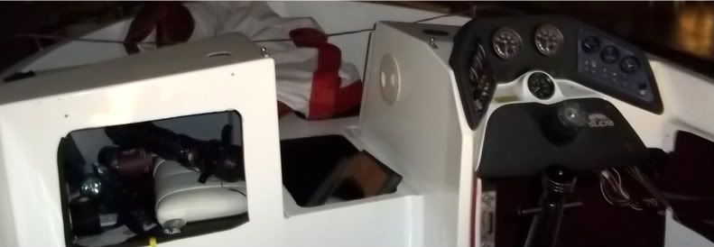

Computer died...finally I got my new one.
You guys were right. I ended up buying a new strut from SkiDim and am having the shaft checked. I may go to a 13x14 prop for a little better top end (thoughts?) Upholstery is 75% done. Floor will be in this weekend and once the carpet is laid, I'll re-join the hull/deck. Engine will be in within 3 weeks and then off to the graphics shop.

Whoa! The upholstery looks AWESOME! Did you do it yourself?!
