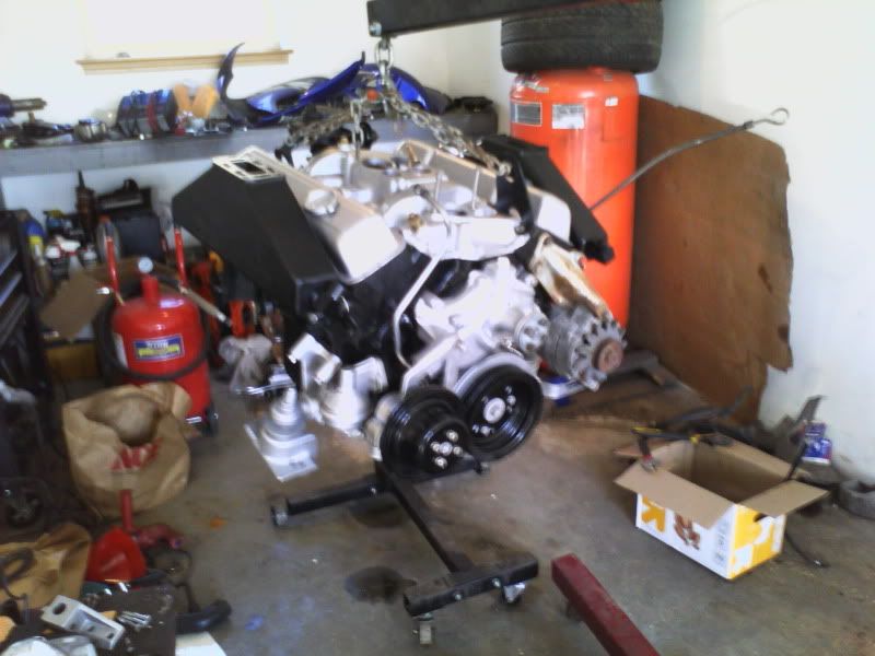

Alright guys, a long overdue update...
I decided against sandblasting the "new" 400 and hit it with the "wire brush in the drill" method.
WOW! That's a lot of work! It took me forever to get all the old grease, paint, and rust off of that thing.
My camera was out of commission for most of that experience so I didn't really get any good pics. (It's pretty boring to look at anyways.) I took off the oil-pan, intake, timing cover, etc, etc, and changed all the gaskets.
I painted it all up in black and silver engine paint, and put everything together.
I'm really hoping everything works, but that's probably wishful thinking. I really doubt the alternator works, which is why I didn't brush and paint that.
Anyway here is a pic of the "finished" engine:
http://i36.photobucket.com/albums/e9...ras/engine.jpg
Took the "new" engine down to work and utilized the chain-hoist there to put the engine in the boat on Sunday.
I'm still fine-tuning the alignment, which has been very tedious as the old rusty mounts don't like to adjust very easily.
I think I will take a little break on the alignment for a while and concentrate on getting the engine running, and fixing the through-hull on the exhaust.

Here's another of the engine taken with my phone:
http://i36.photobucket.com/albums/e9...as/engine2.jpg
I'm too embarrassed to put-up a pic of it in the boat (I'm sure I will eventually) cause it's terrible inside the boat. All you other guys have these immaculate stringers/bilges etc. Mine looks downright awful. (A project for next season)
Looking great! I know it's nice to reach some milestones in the big project like this. Go ahead and show us pics of the motor in the boat. We'll understand!
Your bilge is not alone! I seem to have a once a year deep cleaning that is required to bring mine up to snuff....We just can't do everything and play on the water.....great work so far motor looks amazing..
The fiberglass job on the stringers is... interesting... for lack of a better term. Whoever did the "stringer repair" must have been in a hurry. There's lots of epoxy everywhere, some exposed mat material, there are quite a few things stuck in the epoxy etc. I was thinking I would just paint it up with some bilge-coat, but after seeing it, I realized there's no point. So, we're just gonna run like this for a season or two until I can afford to have it all redone.
I was a little worried about the quality of the wood, but when I drilled my holes and tightened-up the lags, everything seemed solid, so I should be good!
It makes me a little sad to put such a pretty engine in that ugly bilge but, I'm ready to get on the water already!

I have been on this forum for a while, but I have some how missed this whole thread. Its a perfect thread to watch.....great motor rebuild/paint and what not. My boat I believe was used in salt also, and show some minor rust here and there. I am slowly taking things apart and painting when I get a chance, or when they need to be replaced they get painted. Good luck, and cant' wait for the pictures.
Nice job on it by the way!
Thanks Shane!
I haven't been up-dating it at all, so that's probably why you haven't noticed it.
When you paint stuff, be sure to get all the rust off first. Do a couple thin coats to start, a couple thick coats, then finish with a thin coat.
The reason I say that is because, I don't think I used enough paint on mine. My intake manifold rusted-through the paint down in the little "valleys" where it got wet a few times. It didn't "bubble through" from underneath, but I think the water soaked down through the paint. Same thing happened to my valve covers, thermostat housing, etc.
Maybe look-into getting some of that original PCM paint that skidim sells. Supposedly that's the stuff that PCM uses on exhaust manifolds/risers. Maybe that would be more "water-proof". I plan to re-do some of my parts this fall when I winterize.
Yeah, most my pics from this season are of the wet-sanding/buffing proccess. I just need to poke my GF over and over until she will email them to me.
Thanks for the kind words. My boat is definately one of the roughest/ugliest boats on the forum, but hopefully as I get more and more done, the turn-around will just be that much better! :)
