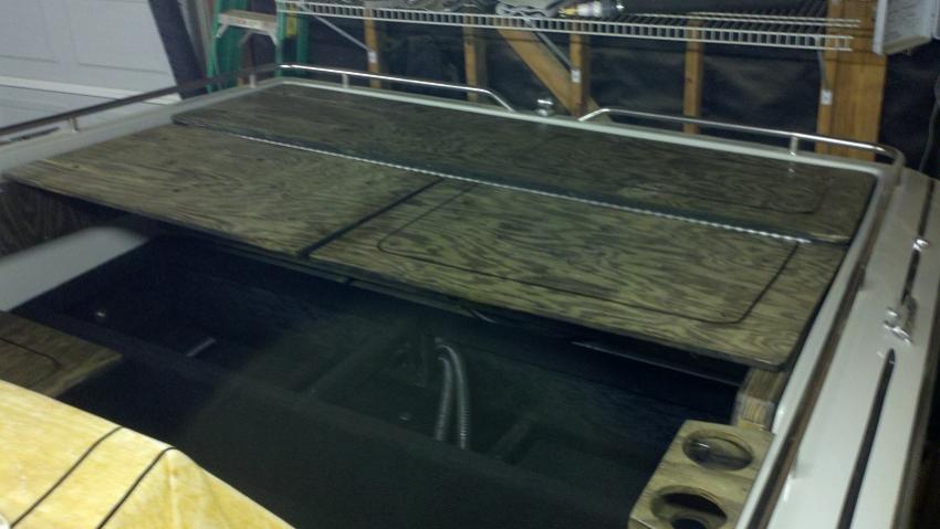

Yep, it's a lot of wood - but I think I'm still lighter than before with all the saturated foam and rotten wood. Be curious to see how she sits in the water when it's all said & done. Maybe just some additional permanent ballast? I'll see how the bow teak trim cleans up & make a decision then.
By corner seat, do you mean the rear facing observer's seat? It's a separate base, seat bottom, and seat back (like all the rest) so no water is trapped anywhere.
Yeah, I'm a composite junky at heart, but on a timber budget at this stage. Does treated ply with 2 coats of CPES count as composite (should last as long)? - hey, at least there's some epoxy in the matrix... As much as I picked Jim's brain & experience early on in my rebuild, he can have the rear bench idea (the angles were a biatch!)

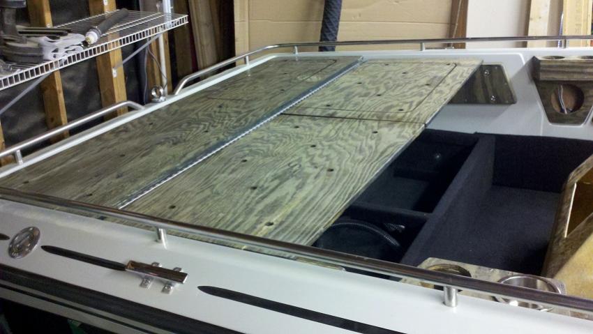

Maybe this'll help you visualize
Attachment 8919
Attachment 8918
I had to make the rear bench seat back and armrests extra wide to support the edges of the seat bottoms when "up" since the hull tapers out at the top. Once the final height is set with the upholstery, I'll add some hinged panels to the underside of the seat bottoms that fold down to support the inner edges - fronts will remain open. I've got 2 MC X-2 sacs (450# each) that fit underneath - half full with the seat bottoms down, full sacs in the "extended sundeck" mode.
