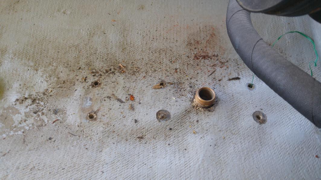

3. Do you have a picture of what went down where the water intake (fresh water intake fitting that is through-hull) is? I have a few bolt holes in a square pattern that surround that inlet. Unfortunately whatever was there to begin with was removed before I started the project. I am including a picture for a little more insight.
