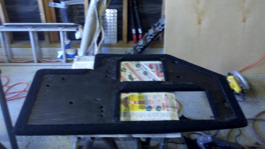

Finished carpeting the amp rack last night - 1/2" treated ply coated with poly resin (I ran out of CPES), painted back, & carpeted front. The amp rack will go on the starboard side of the driver foot well and fasten to a flange I built into the new throttle panel and to the new bracing under the bow. Cut out the backs to aid cooling the cheap A/B amps. I hope to mount & prewire the amps, fuses, dist block, PAC LC-1, etc. this weekend.

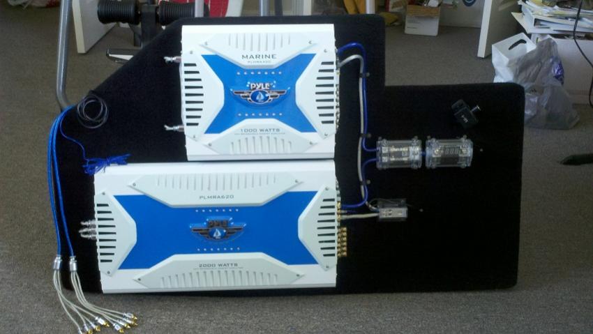

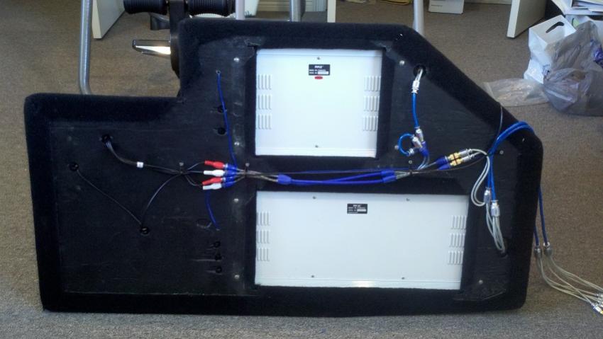

Finished loading up & prewiring the amp rack. All that's left is connect the pos, neg, and speakers. Well, and mount the radio, build the sub box, mount the speakers, run the tower wires, etc, etc, etc. - but gave me something to do while they work on the interior foam & vinyl.
My eBay special Tsunami kit had a voltmeter, so figured why not mount it - kinda cool I guess. I made an angled mount for the PAC LC-1 (that will control the towers on the top amp) to point the knob towards the driver for easier adjustment. The bottom amp is a 6 channel - 1,2,3,&4 for the cabin speakers and 5&6 bridged for the sub. Yeah, they're cheap Pyle (pile of s%$#) amps, but for 100 bucks at a close out sale - what the hell... Have no idea how good it'll sound, but at least the kids will dig the little power level led's and think dad is cool. Since the speaker/power connections are down by the driver's feet, I'll probably make a bolt on plexiglass cover for that end so nothing unexpectedly exciting happens :)
