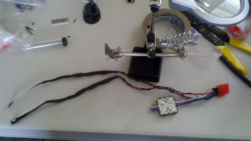

		Finished the first LED wiring harness for the speaker/cupholder pods - only three more to go...  They're all waterproof RGB.  The larger 4 light pod will be down facing in the original courtesy light location.  I'm modifying some stock incandescent housings with a lens and s/s trim ring to house this courtesy light.  The two ribbon cable single lights will go in the s/s cupholders.  These were a pain - first, they arrrived from Ozonium with a long stiff section of heat shrink that seals the built in resistors so I'll have to double back on the wires to fit them into the pod.  Second, the common annode is easy to identify with the red sheath, but there's no way to identify the remaining R, G, or B wires other than powering them up.  I'm putting them all in 4 pin connectors so I can remove the pods without cutting wires if the need ever arises.

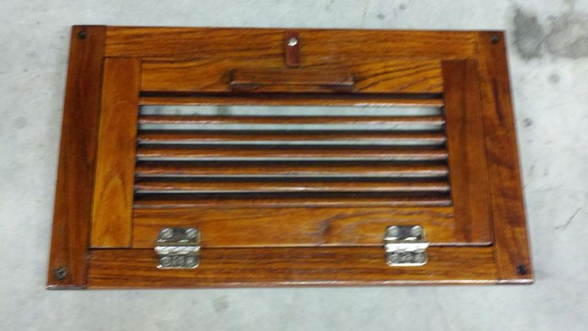

Had to replace a few missing pieces on the doghouse hatch.  Teak's just too expensive, so used some Belizian Mahogany I had.  Can't tell the difference once it's oiled up, but will be curious to see if it weathers the same?  The PO had put some crappy brass hinges on the front, but at least the new s/s ones hide the old holes.

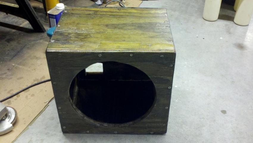

Finally, got the sub enclosure built.  Didn't want to worry about MDF getting wet, so used 3/4" treated ply, glued & screwed, with a coat of poly resin.
