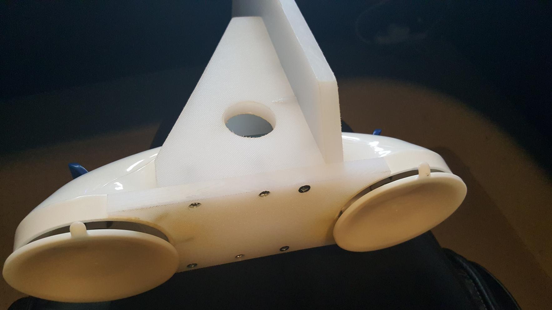

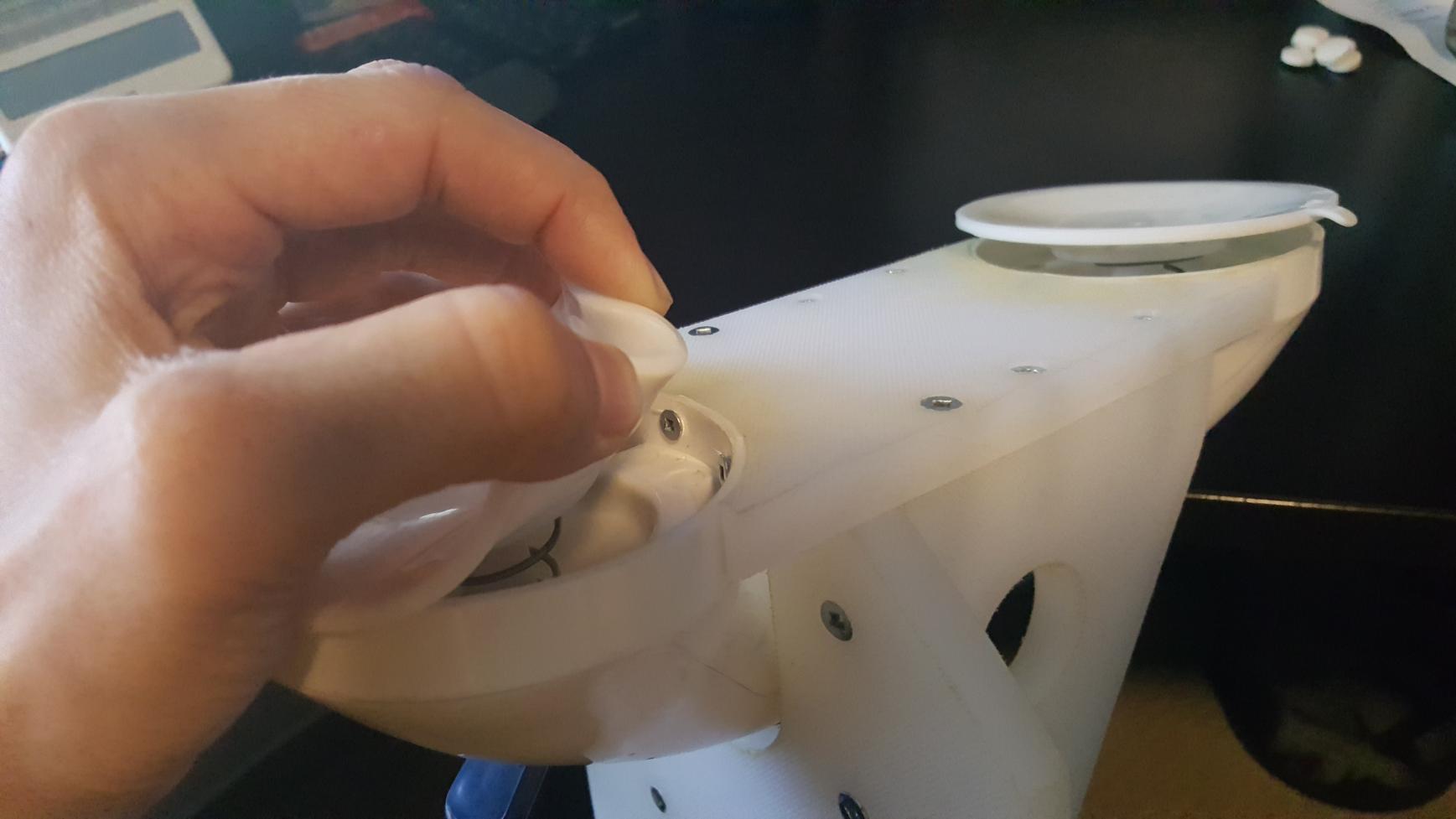

You need to take the suction cups off and then screw it in from the inside. It takes 2 people to get the pins out of the handle but it's pretty easy. It's a bit tricky to get the screws in through. I used a drill bit to make the pilot hole then used a ratchet with a drill bit at the end to get the screw in since you can't use a drill. I used a 3 1/2 hole saw and fits perfectly.
Attachment 17359
Attachment 17360

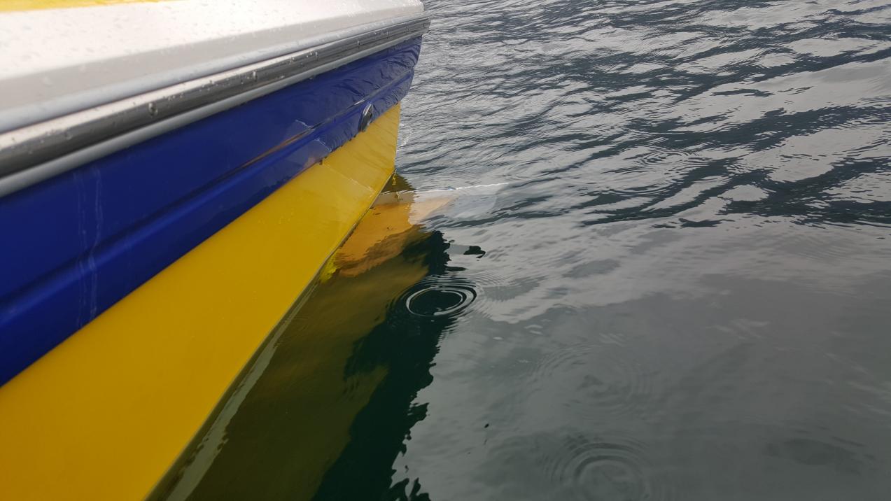

I have found the further back the blade the better.
Here is a picture of my old suckgate under water all the way to the back.
Nice thing is I can move it closer to the front of the boat if I like to play around with the placement.
Attachment 17361
I would think blade in front would push suction cups against boat while blade in back would have a tendency to pull them outward. Maybe not though since yours is working.
