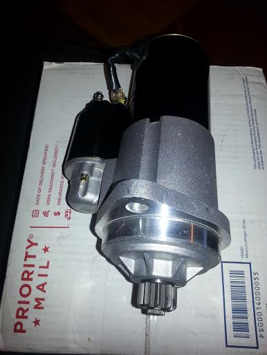

I just wanted to update this thread with my experience with SD0105. I've been running this starter for as along as I can remember (and obviously recommended it in here.) Unfortunately, my luck with this starter was spotty at best. I don't think I have had one make it through 2 seasons. They seem to get REALLY corroded on the inside. Recently I was stuck when the starter would no longer turn over and I had to paddle/swim the boat in. This was a starter that I installed of July 2013 so I only had it for 14-15 months.
This was the DB Electrical version but I suspect most of them come out of the same chinese/mexico factories.
Anyway -- I took the starter apart and was apalled at the poor construction. The armature had some really bad deformities on it (that must have been that way from the factory.) These defects had caused all but 1 brush to be broken, and the brush springs to also have broken off and been chewed up in the field windings.
I decided enough was enough -- I'm done with SD0105!
In all of my other vehicles, I always upgrade the starters to PMGR type starters when I replace them. For some reason, I had not been able to find a PMGR starter suitable for the 454 marine engine. It requires a starter that spins CCW and all of the PMGR CCW starters I could find had a completely different "offset" style of mounting ears.
Finally I've found a solution, though...... and I can't believe how fast and smooth my boat now starts! The LESTER 6793 is a PMGR starter in CCW orientation. It has the same number of teeth and the same mounting ears. For whatever reason, none of the parts lookups specify that this works with the 7.4/454 engine, but I ordered it anyway and can confirm that it works perfectly. Here's the one that I purchased:
http://www.amazon.com/dp/B0094JJK7W/...332200_TE_item and here's the same item at DB Electrical (for those that prefer them):
http://www.dbelectrical.com/p-2299-n...-140-6075.aspx
It's a much smaller, more powerful and more energy efficient starter than the stock one. Swap over to it the next time your starter craps out.
http://i635.photobucket.com/albums/u...psped8drnp.jpg
What are the two purple wires for? I'm guessing this is "plug n play"?
