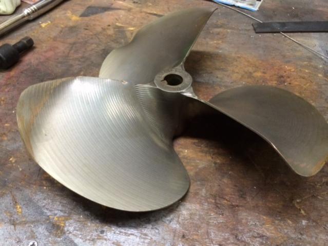

Thanks Titan ! Sometimes I over look things and should have looked at the elec print and wired it up that way . Tomorrow I'll know if my findings were correct . And I changed my prop out last night after hitting stump and ripping my new one up http://img.tapatalk.com/d/14/06/01/qahuhy3a.jpg
