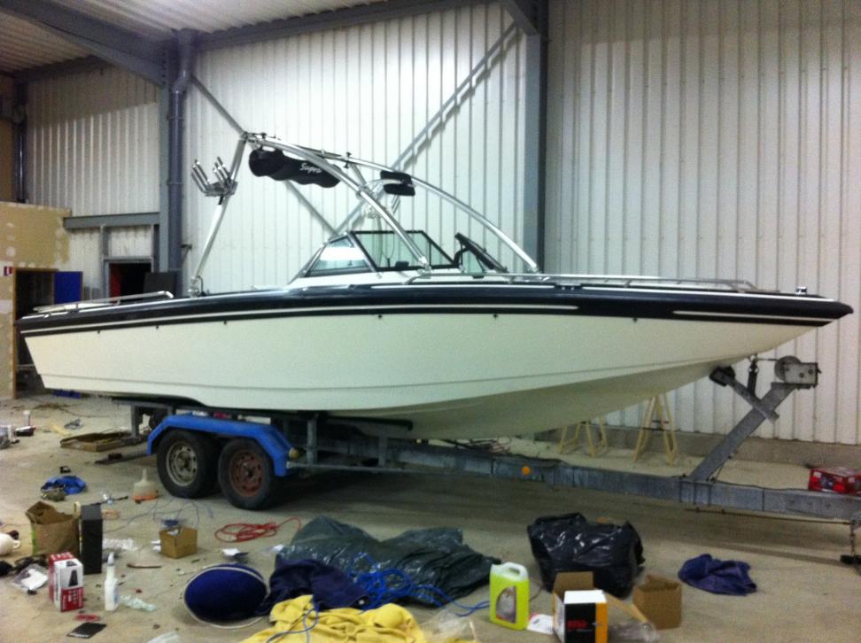

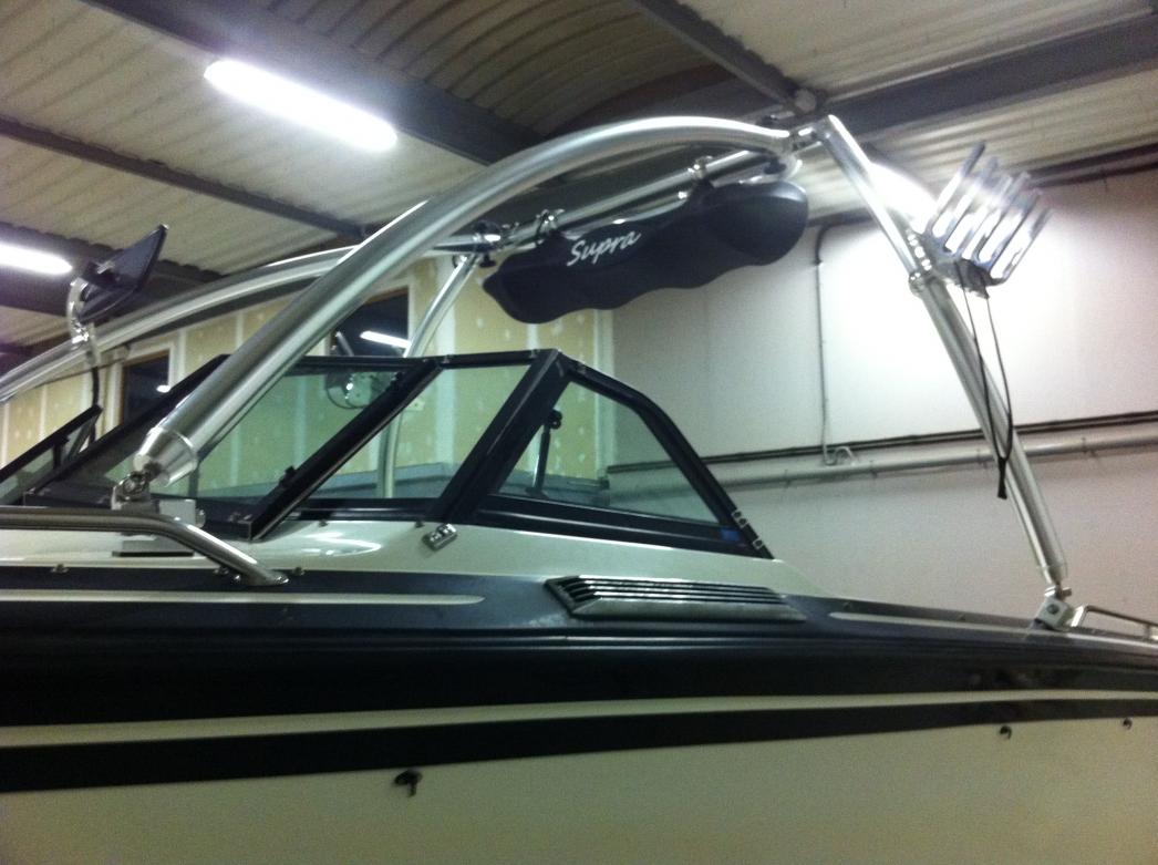

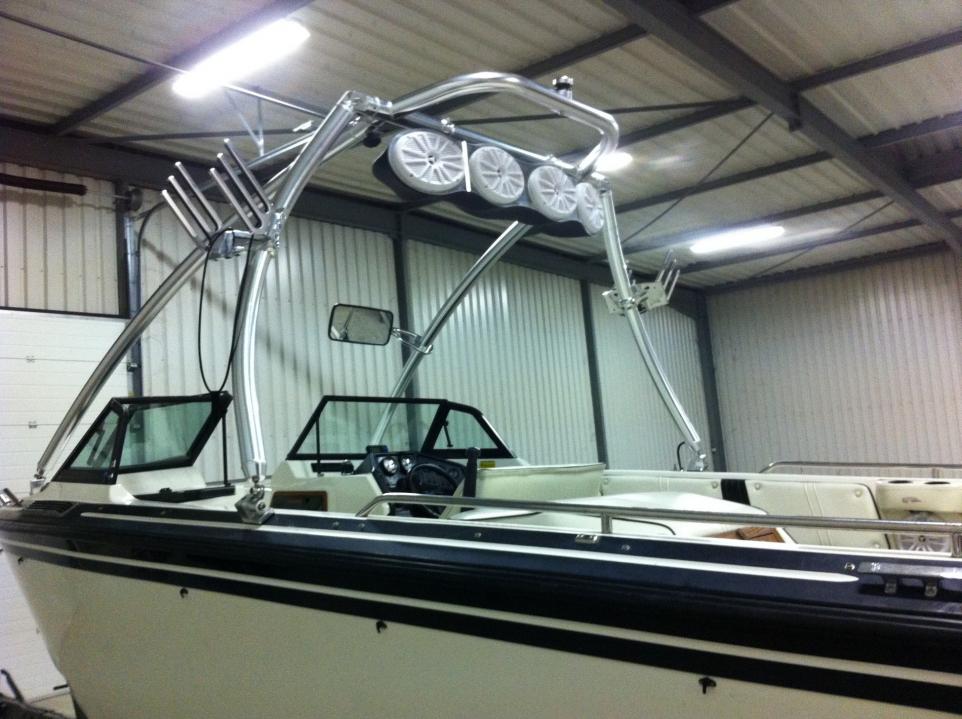

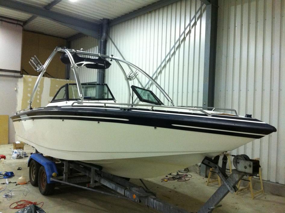

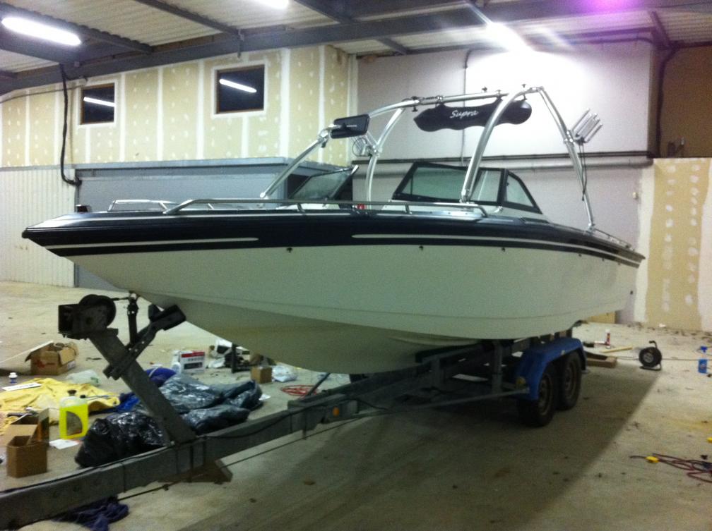

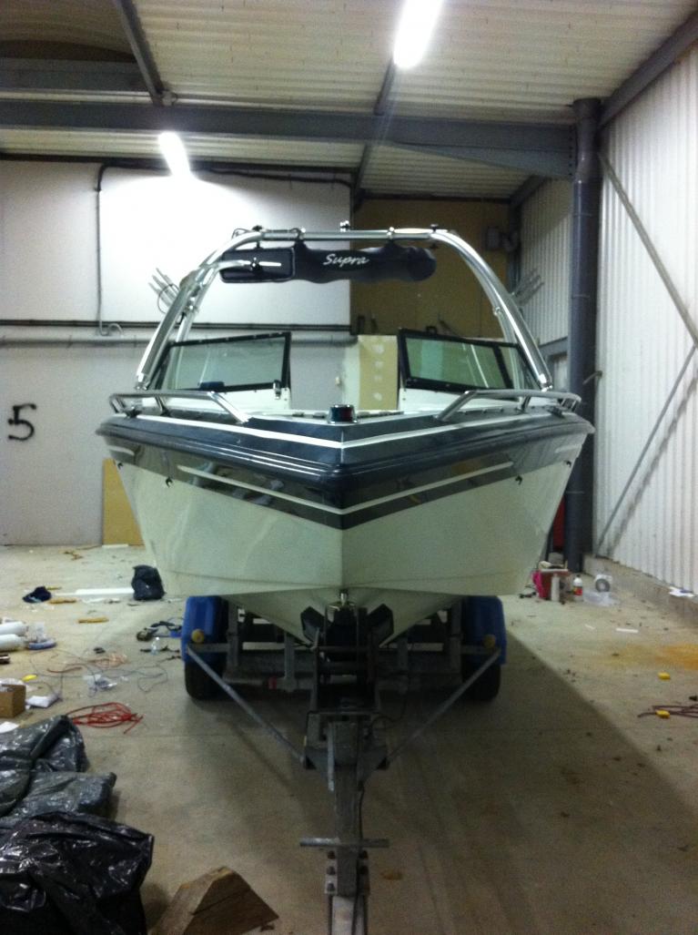

Thanks ! Here is the result on the tower. Just need the "Supra" text on the face and it's over.
Attachment 8774Attachment 8775Attachment 8777Attachment 8778
Look great
nice work
I just need to get over this not wanting to put holes in my boat to install a tower.
Thanks Century.
I was like you with my first boat. Then you drill, and you feel better, no more scare. Anyway it's fiberglass, if you fail your drilling you can recap holes.
The tower is a real good investment : It gives a good looking to your boat, good altitude to your jumps, and save tons of place if you put racks for boards.

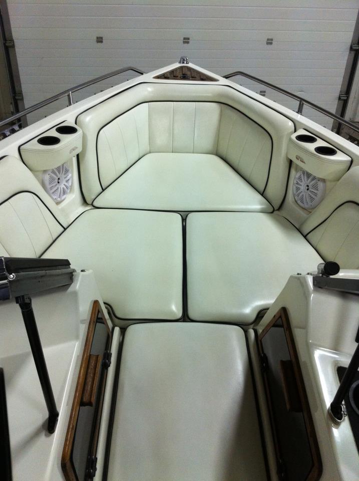

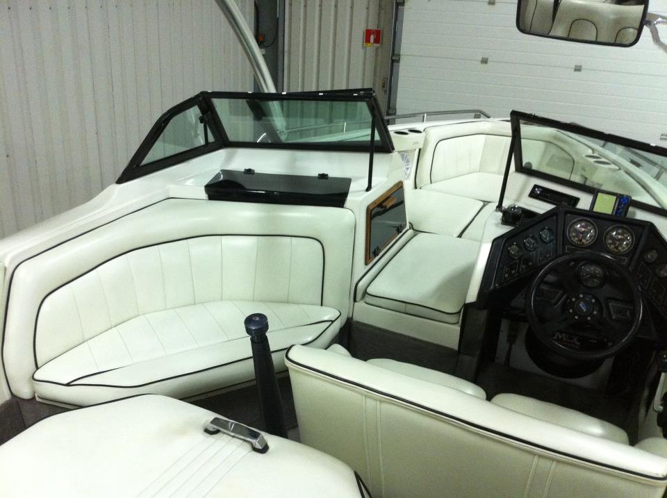

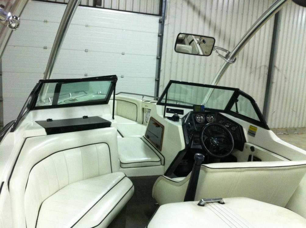

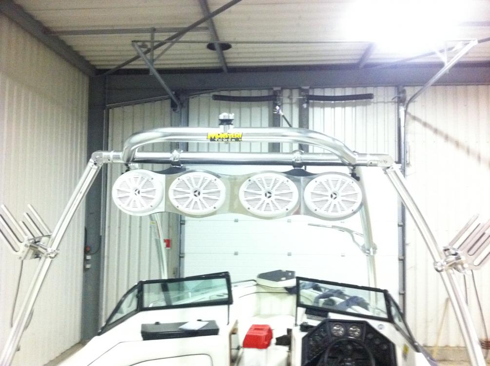

Hi everyone, last pictures indoor. Next one will be on water (next week :) )
Hifi is done, tower idem. Just need a new cover and i'ts ready for this season.
Attachment 9218Attachment 9219Attachment 9220Attachment 9221
Man that interior is looking great. The whole boat is looking great.
