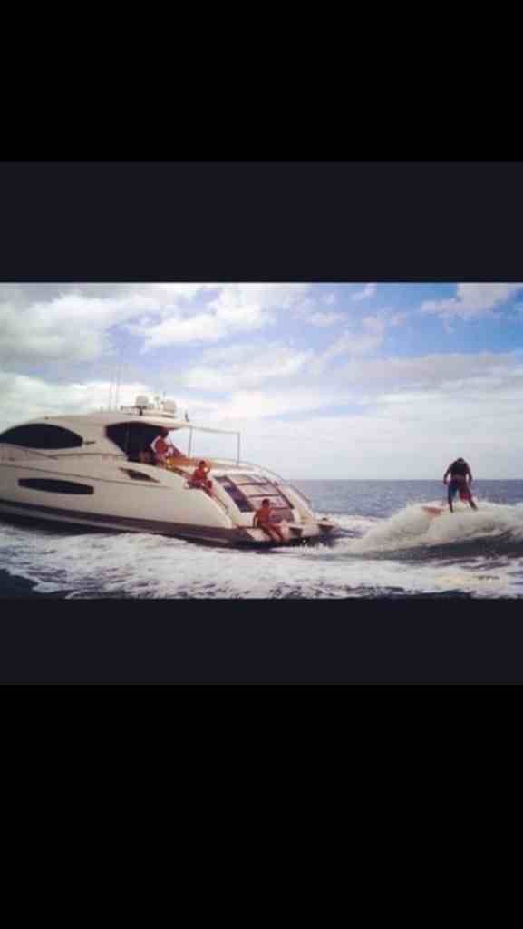

52 ft Cruisers Yacht.
http://i181.photobucket.com/albums/x...Picture975.jpg
holy crap thats an ugly wave. Big but ugly.
Yeah, 52ft boats dont respond well to ballast. We had 34 homeless people we were moving about and that was the best we could get.
i still want to surf it!
