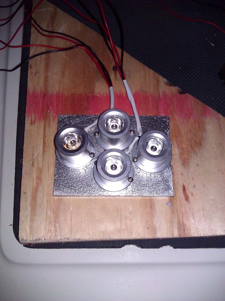

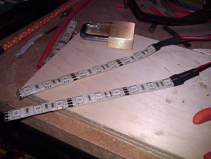

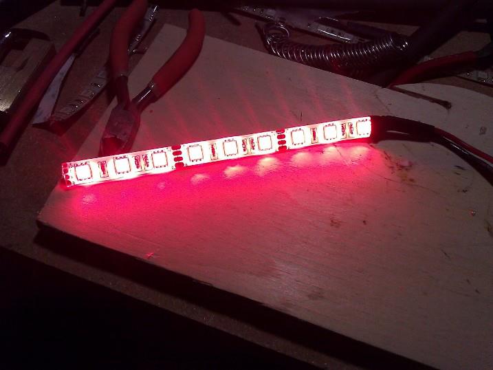

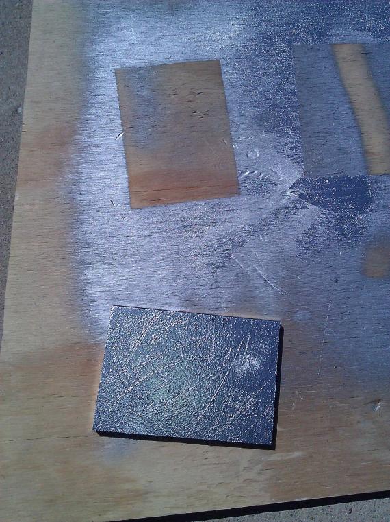

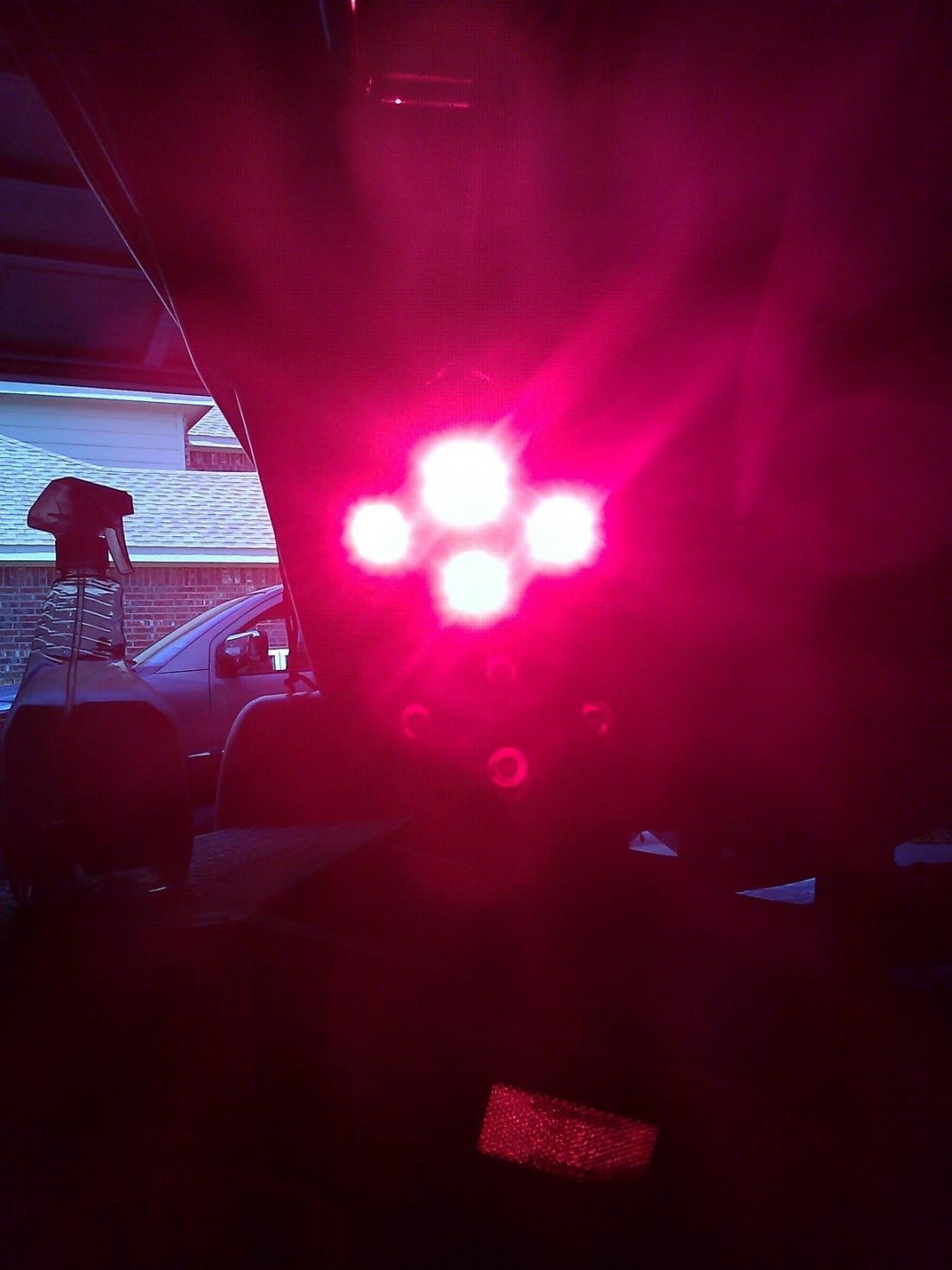

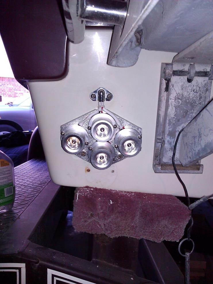

Finished my DIY leds this weekend. Had to finish it so I could get my gas tank back in. The leds seem VERY bright for the price and a GOOD substitute for the $600-$1200 option. No not equal but damn nice for the price. These arent to imprese just give a cool glow underwater.
cost:
$140 8-leds
$2.97 mount plate
$2.99 chrome spray paint
Not bad!!

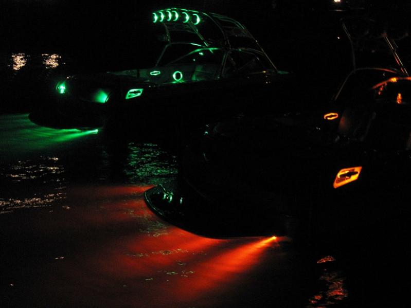

A few more and Ozniums picture of what they look like under water............................................. ..Attachment 9555Attachment 9556Attachment 9557
Jet, that last photo from ozniums site is of my buddies boat and a customers of his at the marina where I launch my boat. Those two boats freaking jam out!
Man, I wished I knew that. Im still needing some mounting ideas?? I just did a quick fix on this because Its holding up my gas tank going back in. Can you find out anything?? And, how clear is the water there where the picture was taken?? Our water here is a lil muddy and not that clear. Let me know man. How is your boat coming along??

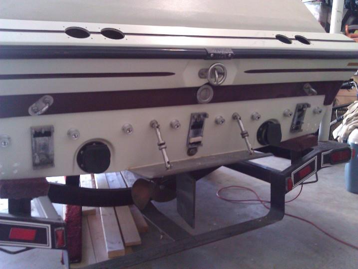

What he does is just mount them across the transom about a foot apart from each other. He uses the same kind that you got. They light up really well. Just make sure you 5200 the holes that go through the transom. He will be doing mine in a few weeks so I will post up some pics of them when they get done.

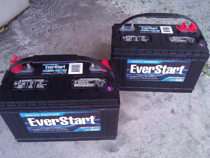

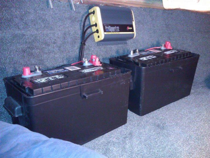

OK, charging system and battery's up n running. Final pic'sAttachment 9770Attachment 9771Attachment 9772

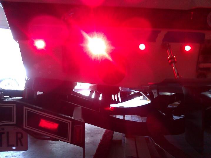

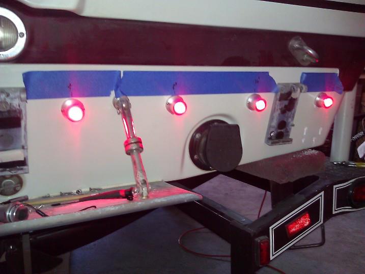

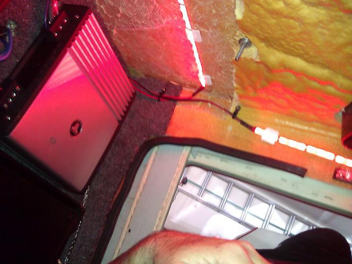

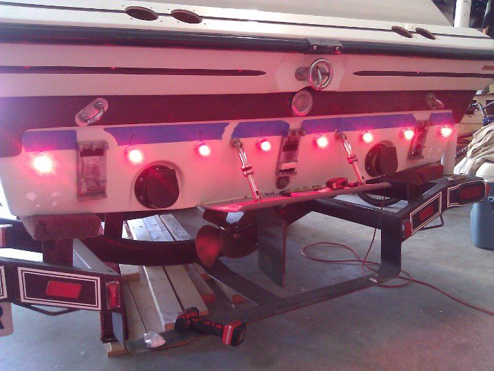

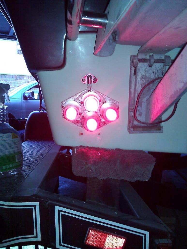

Re-did my led's this weekend. Didnt like the way the looked after it was done. After talking more with Mr Speed and looking at the pictures from Oznium, I did like the spread of the lights going all the way across insted of a cluster or a downward blast of light on the other mfr's lights. Im still 1-2 months away from being water ready so I will post up more night time pics another day.Attachment 9864Attachment 9865Attachment 9866Attachment 9867

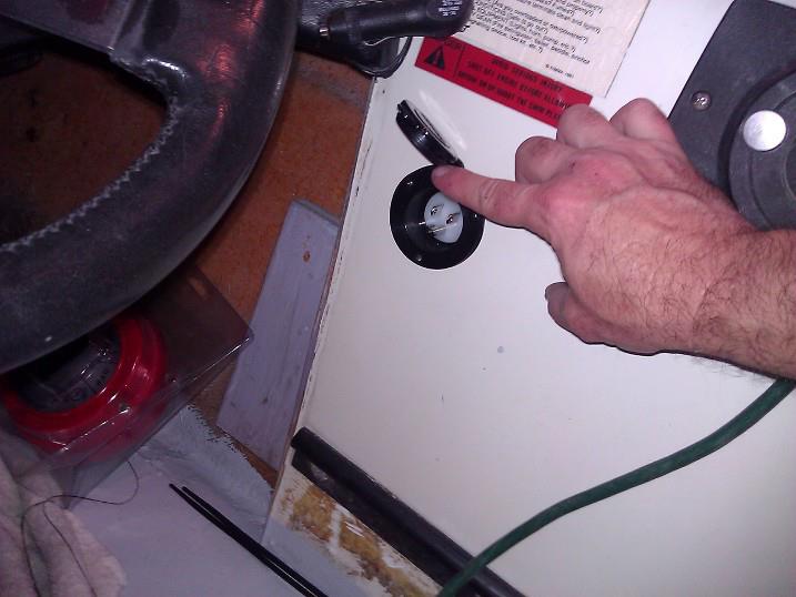

Jet -- What is the purpose of having the onboard charger port at the drivers knee? Shouldn't that plug be on the outside of the boat?
Only if you want a big whole drill thru it. lol. Most put it in the back storage compartment but I wanted mine by the driver seat so I can reach over and plug it in and Its by my work bench.

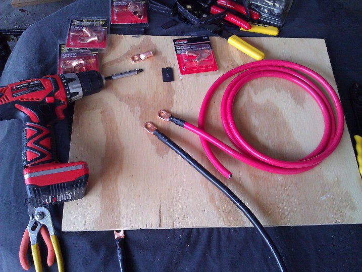

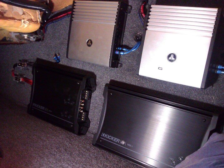

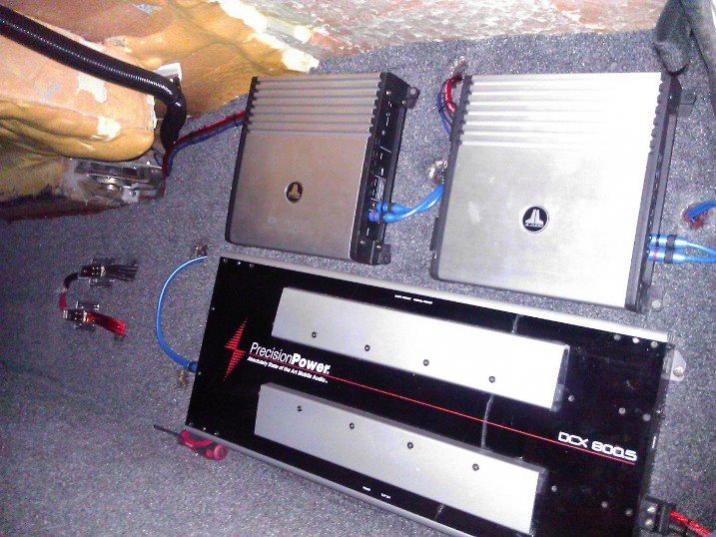

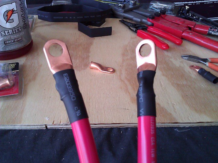

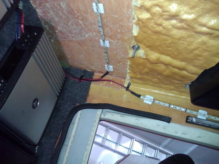

Making progress. The whole system is getting 2-gauge.
Attachment 9932

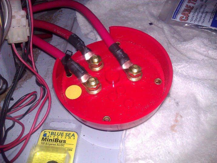

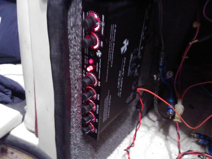

Eng-Perko switch (to be changed later) Stereo Dist Blocks-Both Batteries all got 2-gauge cable run to them this weekend. Yes, I stayed home and looked at all of your pictures of YOU out having fun while I was home sweating my Exile balls off. lol. Also got the stereo dist blocks run and amp most of the wiring done. I hate hiding all that nice cable I put together, its to pretty to hide now.
Do I need to upgrade my alt wire now?? Its really puny!
Attachment 9940Attachment 9942Attachment 9941
