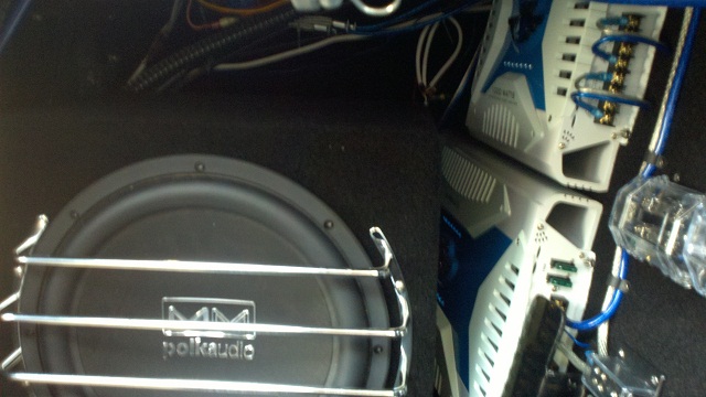

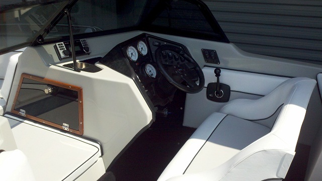

I must have caught your cold, jet - my nose is now stuffy too. Had to R&R the grill cover off the sub to get it slid down between the helm and seat base. Not much room left port-to-stbd, but still plenty of leg room. So now the stereo's done except for tower speakers and tuning (haven't mounted the tower yet, but I did run the wires to the thru hull connector). Interior lights are done (more on that later), and teak storage/trim is installed (except for doghouse - last piece getting vinyl).

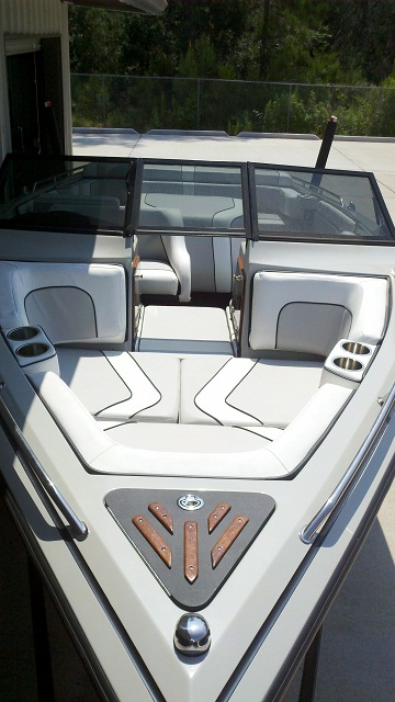

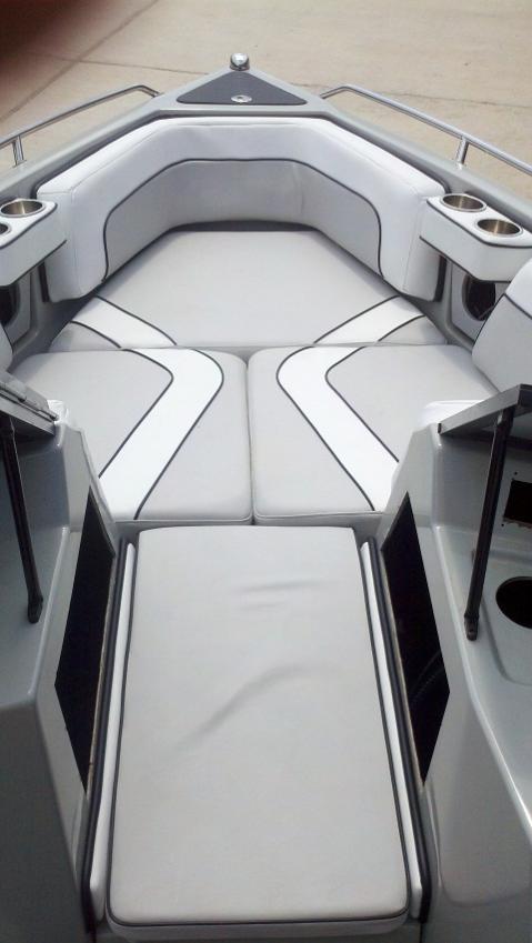

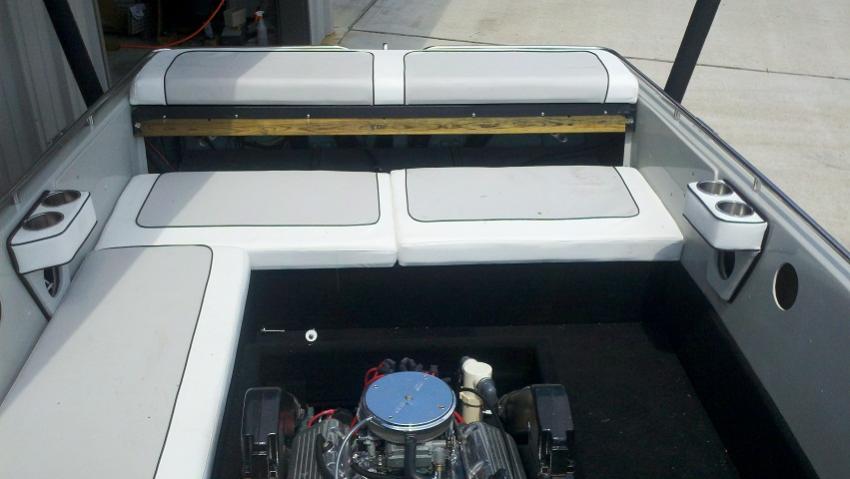

Interior is almost done! My guy needs to recover one piece, add backing material to the bottom seat cushions and a few tweaks.
Bow shot - added the original teak trim inserts on the new StarBoard bow locker. I need to go back and add locating blocks to the bottom of the seat cushions so they don't shift around and the lines stay straight.
Attachment 10086

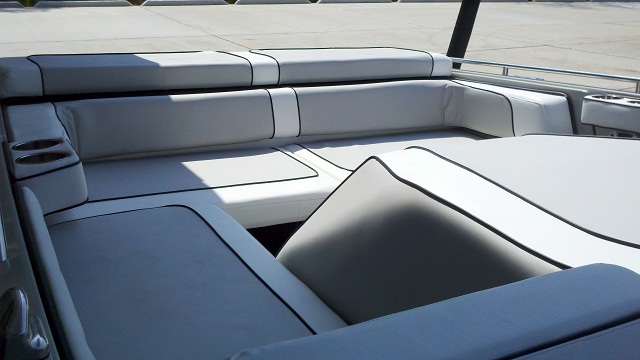

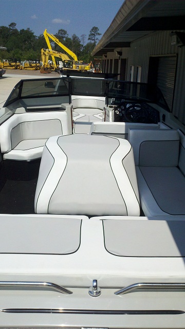

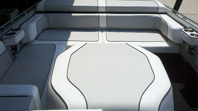

From the rear - still need to add a pull tab on the ski locker lid, cut the vinyl & mount the doghouse locker trim, and add soundproofing and hinges to the doghouse. Finally got to sit down in the rear chaise with the engine cover in place - gonna be the seat everybody fights for.
Attachment 10087
And a few more of the rear layout. I painted myself into a corner with the armrests - made them long enough to cover some existing holes from the old interior, but now the port one captures the chaise seat bottom so the chaise backrest has to be lifted up in order to remove the chaise bottom. Otherwise, I'm real happy with how it turned out.
