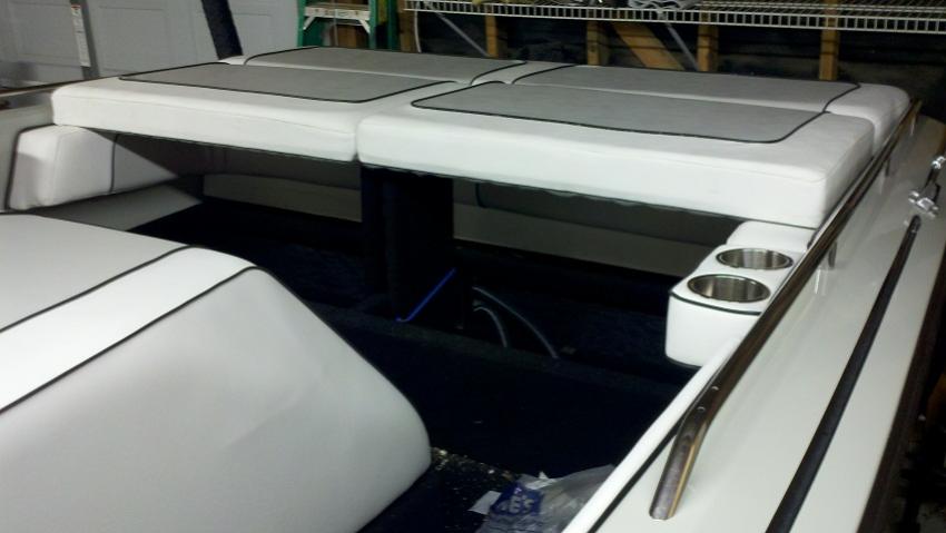

Thanks Salty, but no need to kid - the armrests and top ledge of the rear bench were designed just for that purpose. The whole seatback/armrest assembly is a sandwiched construction of 2x2 and 1/2" ply with minimal foam on the top face to support a sundeck. However, once I built it - the armrests, cupholders, and doghouse had the rear seat bottom trapped (again, best laid plans & all that). So I split it into two pieces, but still plan on having the rear bench(s) convertible to a sundeck and to allow the two MC X-2 450# sacs underneath to fill to their full 20" of height for surfing. I'm gonna add some hinged braces to the underside of the seats that fold down to support the middle edges when in the "up" position. We'll soon find out how/if it all works out.
Jet - I'll get some better pics for you once I've got it back for the last time. The seat base is rectangular with 72" clear length inside for ski storage. The backrest piece has angled 2x2 uprights with a 2x4 top and skinned in 1/2" ply all mounted on a 1/2" ply base that is bolted to the base. It's hollow inside with storage access through the top hinged backrest. The seat bottom lifts out to access the base storage (although I made the blasted rear armrests too long trying to cover existing holes & have to lift the backrest cushion up to lift the bottom out).

Salty- here's the rear bench seat bottoms in the "sundeck" position". I made vertical supports out of carpeted 3/4" ply, hinged on the inner edge (still need to align & screw to the seat bottoms). I'll figure a way to hold them up flush with the underside of the seat bottom when not used & gotta figure the best routing for the ballast hoses with them in place. For now, a simple bungee cord secures them to the center crosspiece in the seat base & locks things together pretty good.
