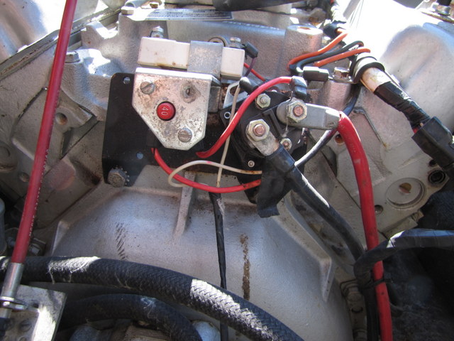

I don't have a voltage gauge just amps.

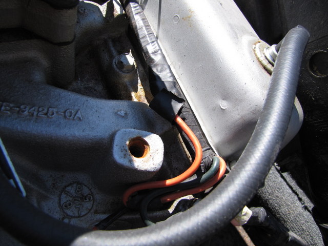

Ok but on the rear of the motor . Where is ur secondary orange wire terminated .. if it even is
as far as I can tell nothing... its taped off.

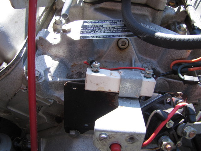

here's the pics.Attachment 10046Attachment 10047Attachment 10048
Yeah idk I might have wired it wrong .. lol I talked to Vince at skidim. And if u have an amp meter that is how its to be wired
but in my case that with a volt meter it goes to the input for the breaker and the little red wire goes to the postive lead comeing in.
And that is what charges the battery but I don't get it ... I did that and the damn volt meter still pegged out .. oh well ill look at it when I
get home ... just so much going on .. I don't need hold ups like these ... thanks fit the help bud!
