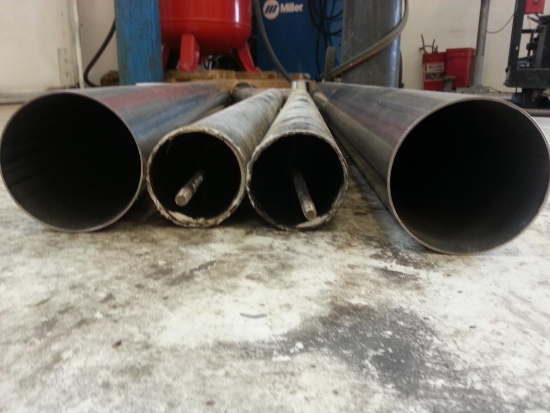

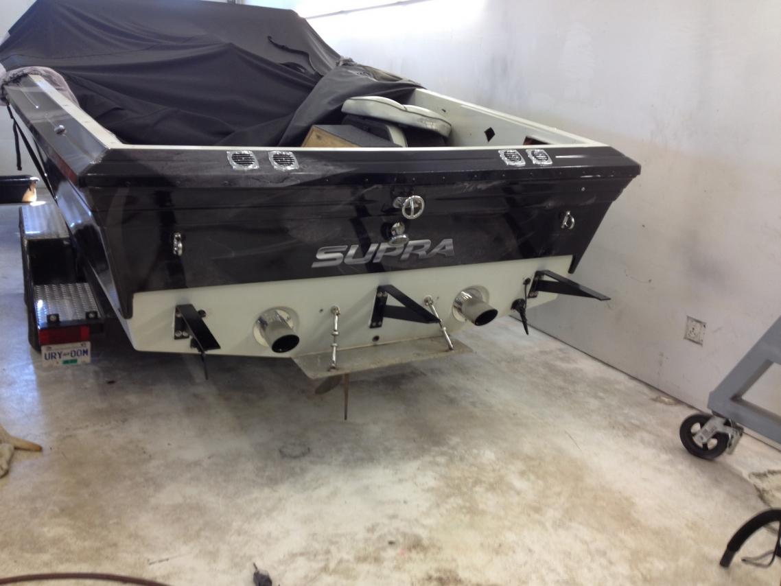

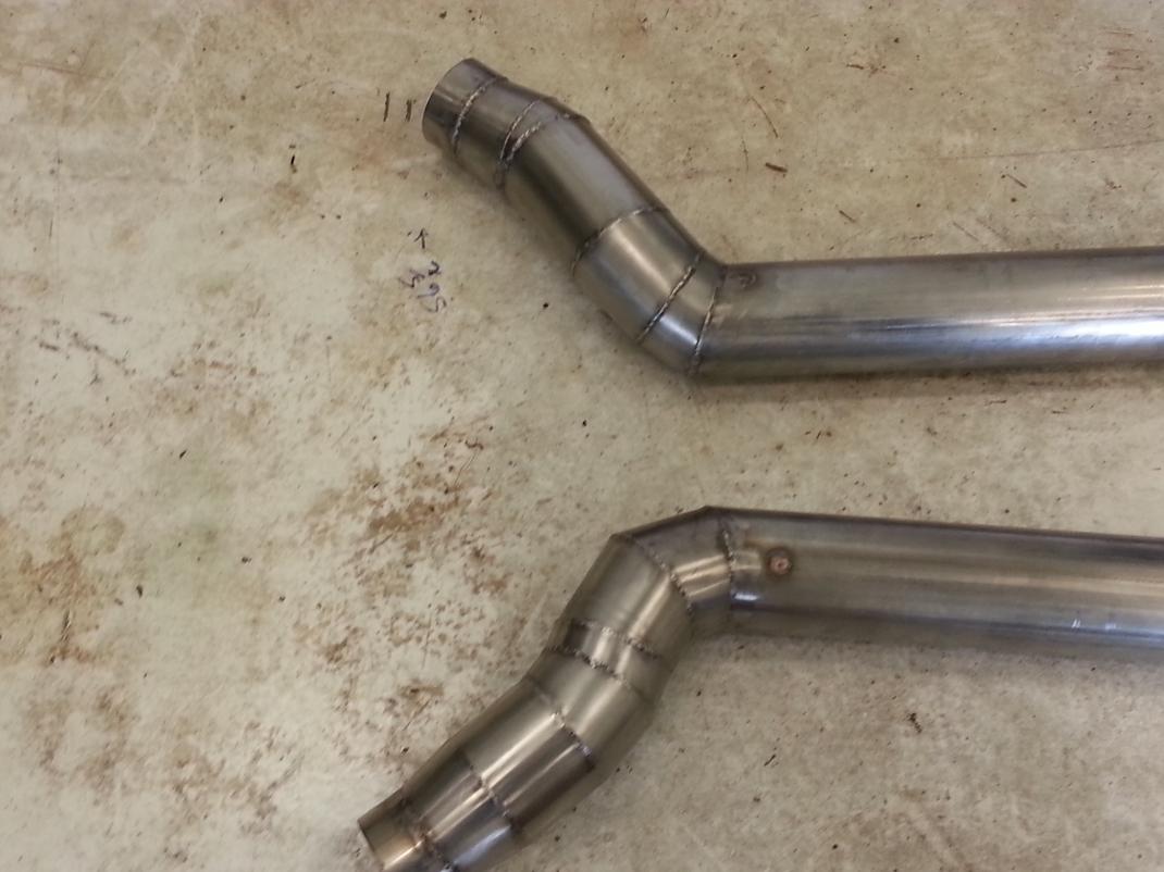

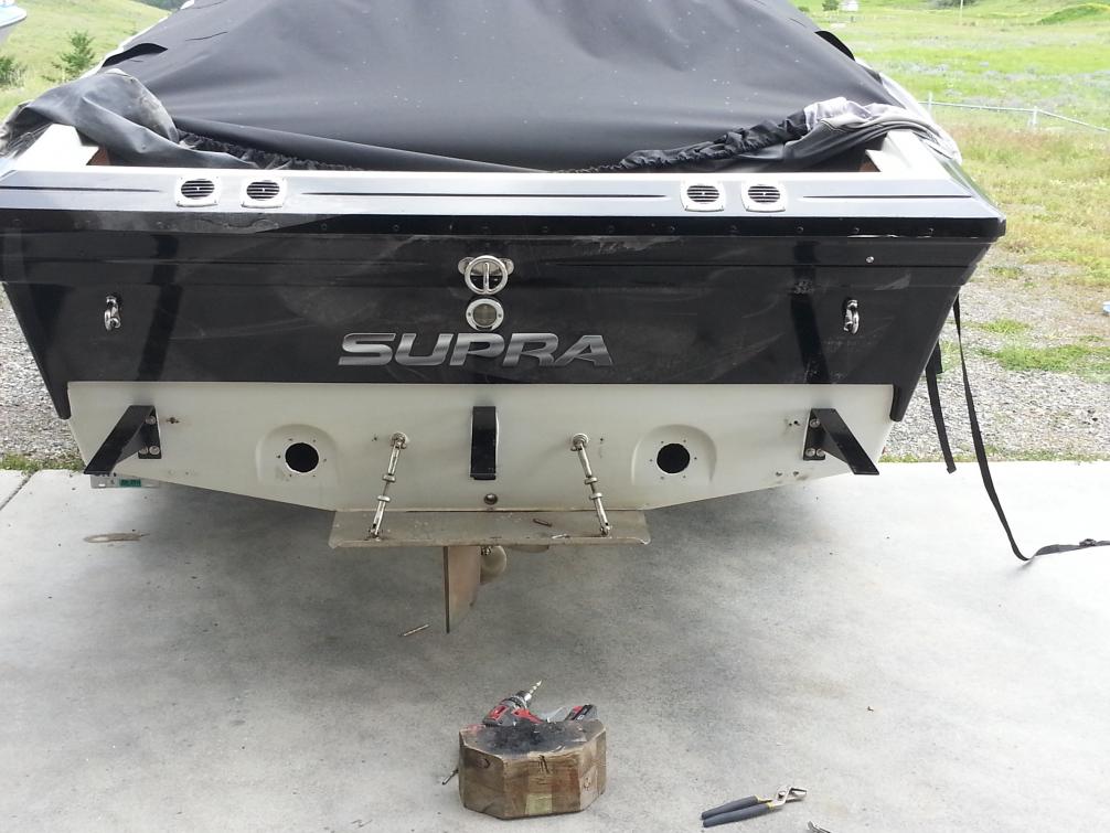

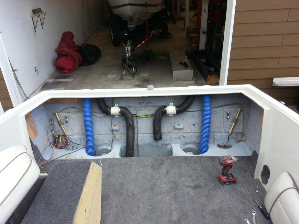

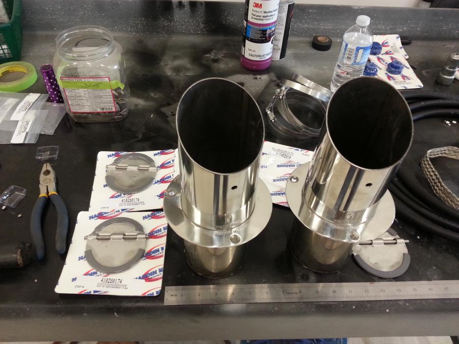

Attachment 12443got my bilge blowers hooked upAttachment 12444also got the back end togetherAttachment 12445picture of my new exhaust going from 2" 3/4" to 4 "Attachment 12446 new tips and flappers

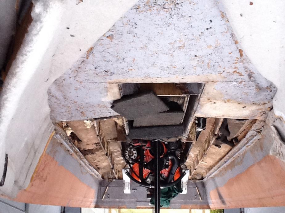

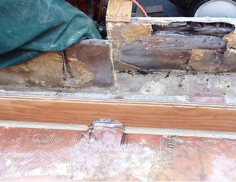

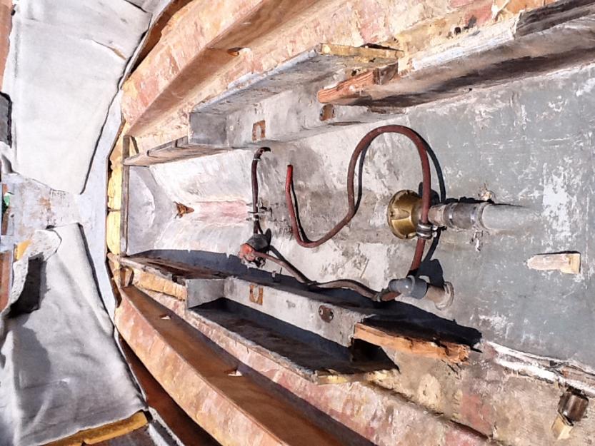

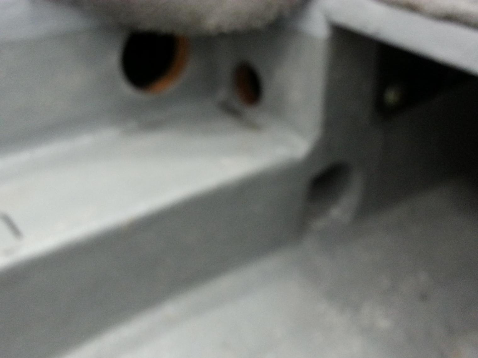

Holy cow, you are a one man wrecking machine, Great job so far. on question. I see you made some cut outs in the highest stringers. Are these weep holes? did you fiberglass in those tabs to the floor?
Attachment 12450
I bedded my stringers down with pl then glassed and gelcoated it all after I was complete

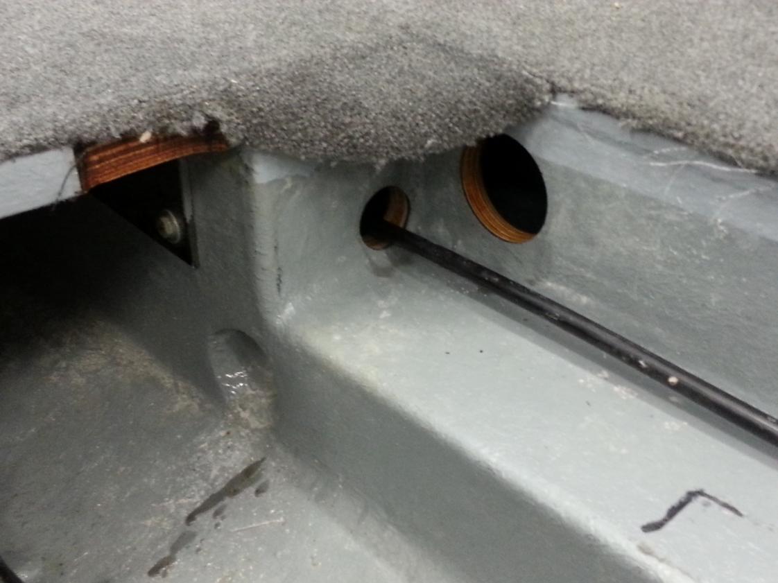

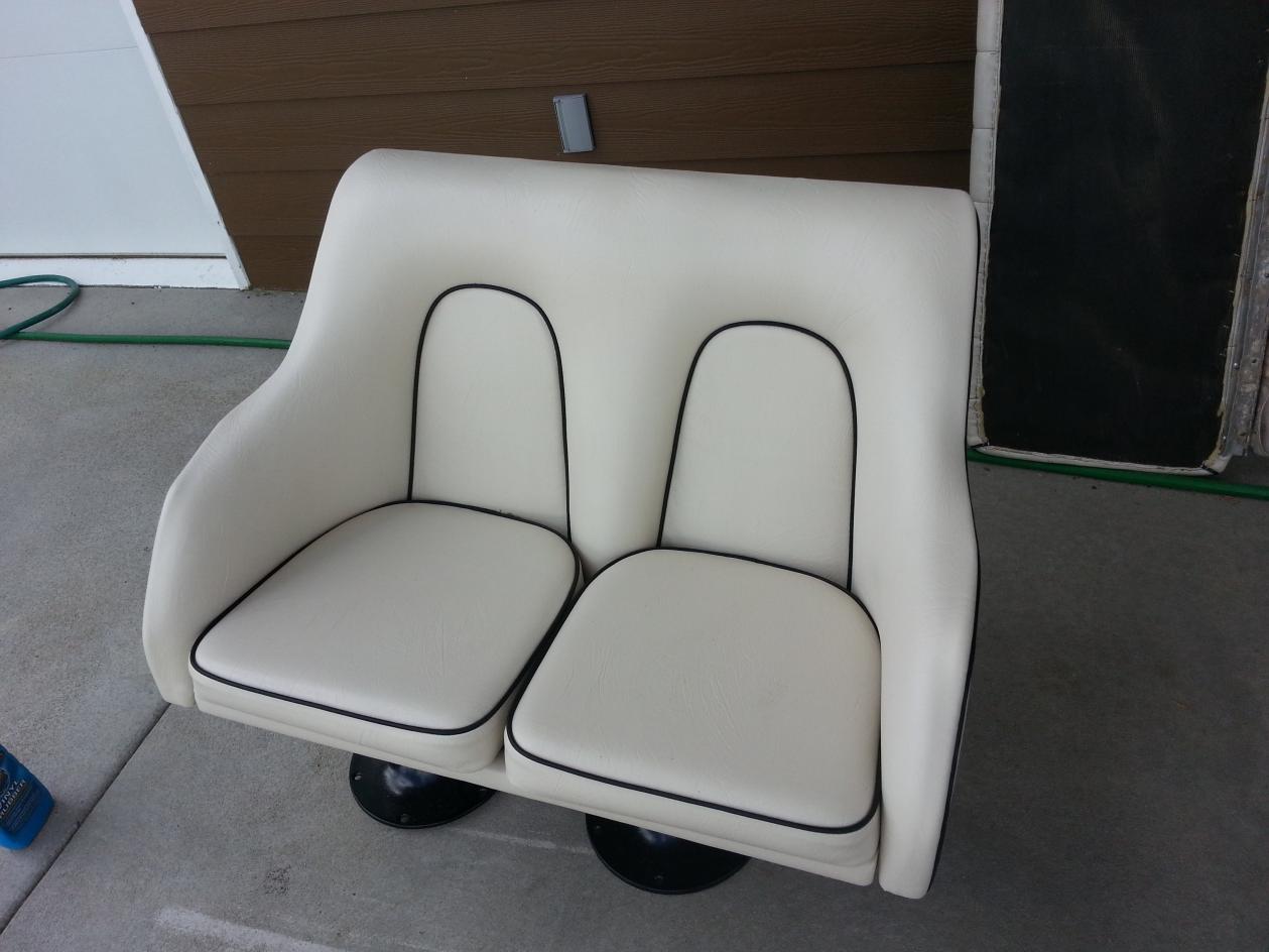

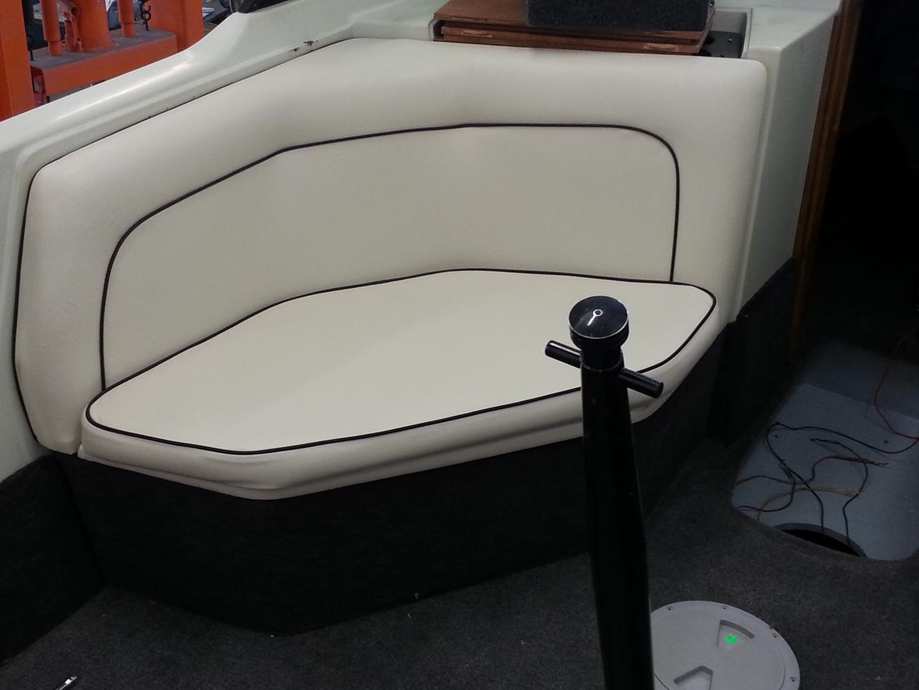

Attachment 12546Attachment 12547some of the nw upholstery showed upAttachment 12548Attachment 12549access holes and venting holes for engineAttachment 12550and my new exhaust
Attachment 12551back end almost completeAttachment 12552my buddy travis building my exhaustAttachment 12553this place is on the way to my friends place
