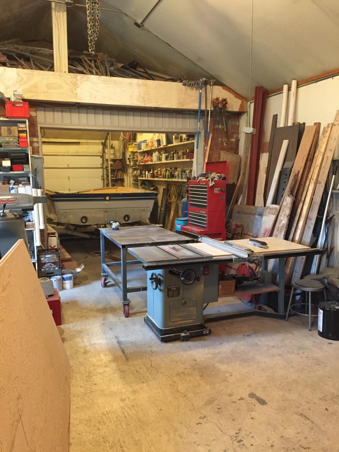

I spent Sunday cutting and fitting new pieces for the transom. I decided against doing one piece for the transom due to irregularities in the hull. I didn't want to have empty voids due to changes in thickness of the glass, or have to spend time cutting and trimming the back of the plywood for these "bumps." First I cut the piece of 1/2" that spans the back of the hull to pad it out and make the face of the transom one even surface. This is three pieces from the factory, mine is now one piece. I then cut the individual swim deck side pieces and the center section from 3/4" plywood. Once all cut and trimmed, I coated the backsides with resin to cure overnight. Hopefully Tuesday night I can get these pieces installed on the transom, and then glass them in on Wednesday evening.
All of these pieces will be bedded on the back and bottom with what is called "Gunk." Its a polyester resin based "bondo", just like most other stuff used for similar purposes. Luckily I live in a city littered with marinas and boat storage/repair facilities, so we have a store in town that specializes in fiberglass sales. No online ordering for me, and if the store is closed you can just call the guy at home and he is always more than happy to open the store to help you with your project so you don't have to sit and wait. Can't beat that.
Spent the first hour or two of my morning cleaning the garage and setting up the table saw for the day. First cut the 1/2" plywood to pad out the transom, and then cut the other three pieces. Another reason I decided to not go with the one piece transom is if, god forbid, the swim deck holes were to leak and get the wood wet. I would simply have to replace individual pieces instead of the whole thing. I'm hoping this never happens again, but at least it makes life easier for whoever owns it twenty years from now.
