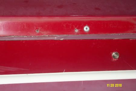

Neil - rubbery stuff at the hull joint is most likely silicone. Can be removed with a razor blade and power eraser. Typically you'll run a new bead between the lower edge of the new rub rail and hull after you install the rail.

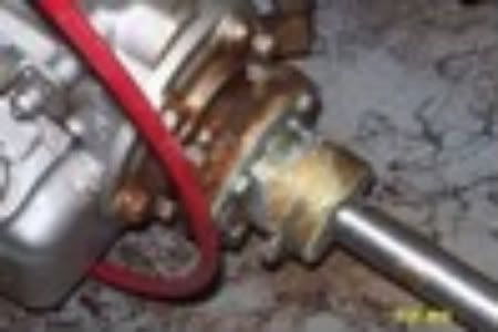

Dab some PB Blaster on the nuts and between the flanges & let soak before you try to separate. Once the nuts & bolts are off, you can twist & pull from the prop to slide the shaft rearward. Might need to tap the flange with a rubber mallet to help break it loose. Careful, the brass is soft & you don't want to damage the faces by prying.

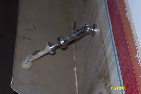

Wakeplate turnbuckle is the common term. Let me know if you need one. I'm adding electric actuators & won't need my old one's. They're oxidized, but functional - might clean up o.k.
