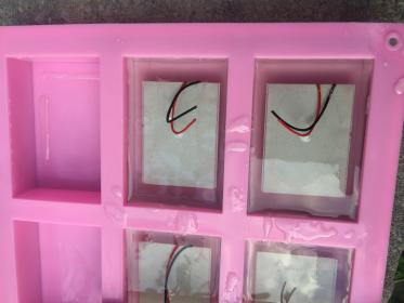

Well here goes nothing. Attachment 16244
I spent some time at hobby lobby today and met an nice old lady that was picking up resin also. Turns out she does this on the side and sells pieces all
Over the country. After picking her brain I'm trying a different resin then I used last time. I'm also pouring them differently. I started out by mixing 3/4 of a cup of resin. Poured it into the bottom of the mould. I then waited about 45 minutes till it turned into jello consistency. After that I painted on a thin coat of resin and embedded the led panels into the jello making sure they were centered. After that I poured another layer of resin into the molds. The older lady said to not pour it on top but to pour it down the side so it can spread. This method will minimize the air pockets trapped between layers. After they were poured I grabbed a hair dryer and quickly ran it over each mold to bring any residual air to the top. I'm now waiting for them to dry completely so I can demold them. Cross my fingers and hope they come out as nice as I'm hoping. I'll post pics tomorrow after I pop them out of the mold. All together I have around $65 into 4 lights. My next batch will be even cheaper because the molds are reusable

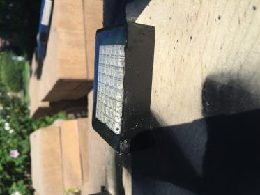

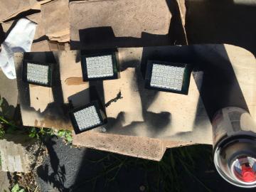

So here they are. When I removed them out of the mold I found one air bubble in the face. After researching resin polishing I did I light wetsand of the face with 1000 grit. I then added another very thin layer of epoxy over the top of them to make a dome look to the top. I also brushed on a thin coat of epoxy around the edges to seal in the black paint I used on the sides. For my first batch I think they came out pretty nice. I'll post pics of them lit up tomorrow. After I mount them and the silicone dries. Attachment 16245Attachment 16246

It's hard to tell because I have 4 on my bass boat and three on my supra but from looking at them they look brighter and the blue light projects further in the water. It's not really a fair comparison though cause the supra has the platform on it and the bass boat doesn't plus the bass boat sits a lot higher in the water but I'm going to build some new ones for the supra this fall. They do seem brighter though. I saw a blue haze after looking at them out of the water and don't remember tre round ones doing that to me.
